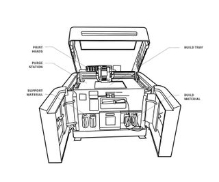

The Objet Connex 500 is a polyjet 3D printer that works by spraying tiny droplets of liquid resin, which are rolled flat and cured with UV light. The Connex 500 prints at an extremely high resolution and can print in multiple materials at once, making it capable of creating much more accurate and complex parts than most other 3D printers on the market today.

An overview of the basic operations of the Objet, including safety, approved materials, and tips for successful use.

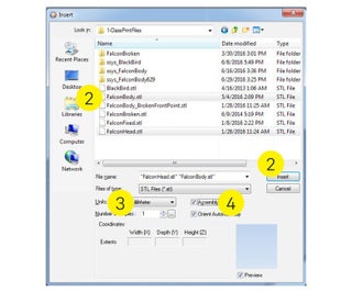

This lesson will show you how to prepare a 3D model for printing, and choose print settings using a program called Objet Studio.

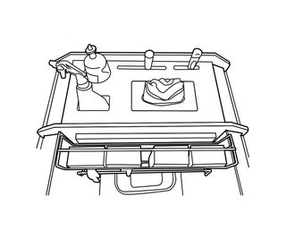

To keep Objets printing successful accurate parts, it is essential to clean the print heads after every job.

Objet prints come off the machine with a support material. Learn the best methods for removing this material from your print.

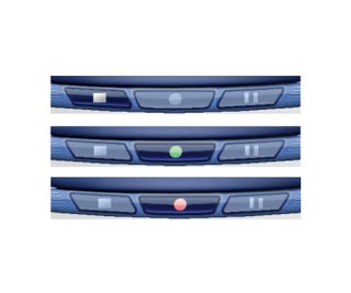

A recap of how to run the printer which can be used as a quick reference guide when printing. This lesson also includes a free PDF download of this class to use in your shop.
