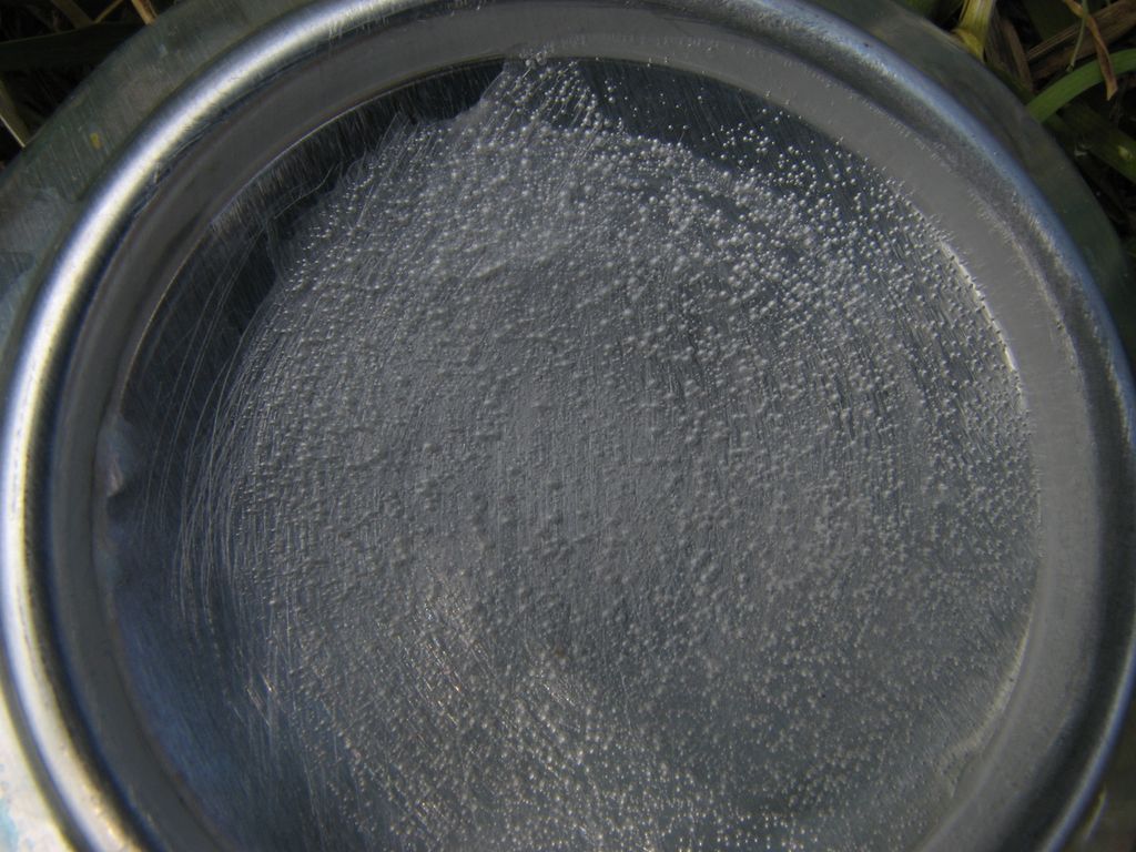

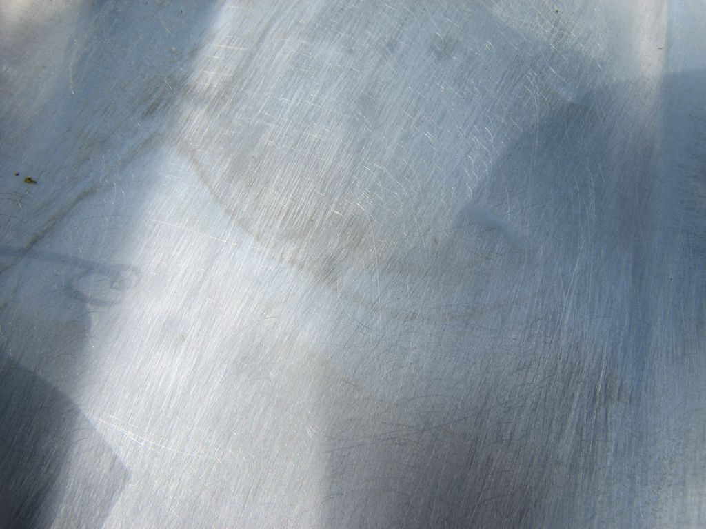

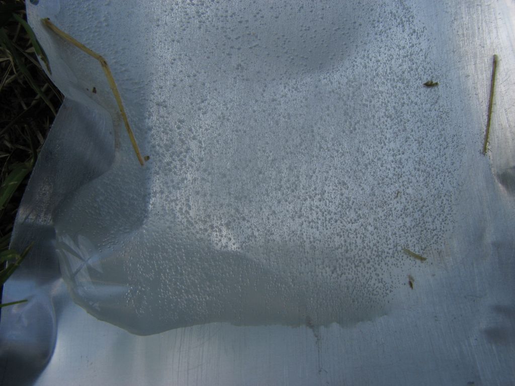

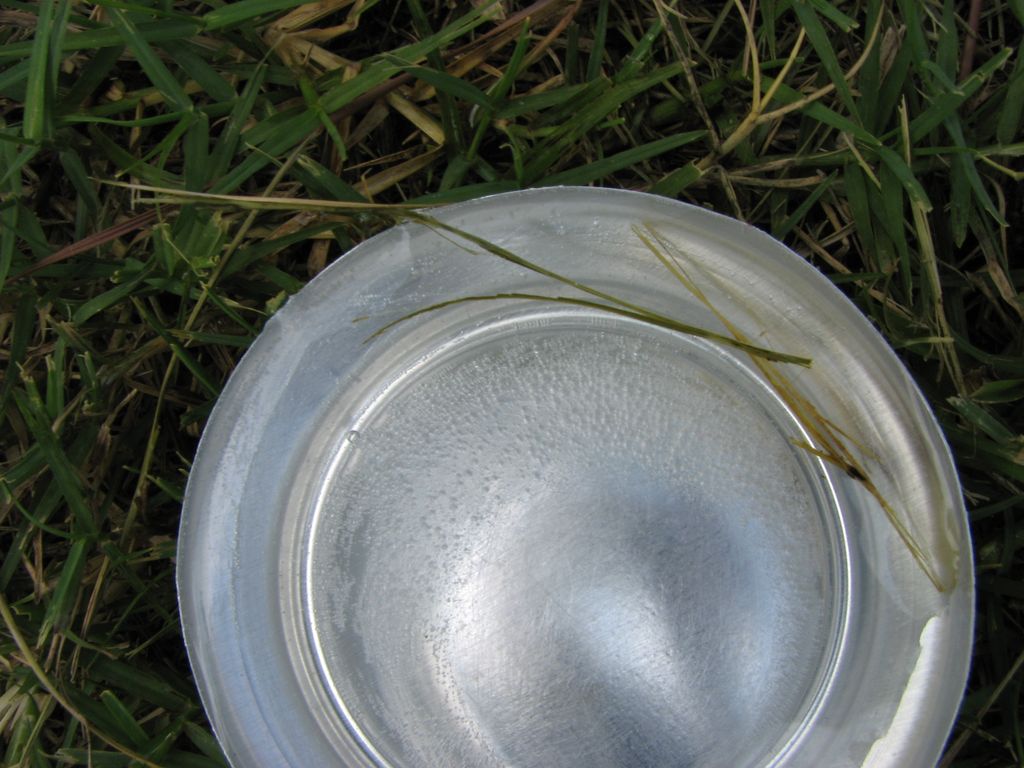

Bran
Bran
Reply 13 years ago
I cut the bottom and top off the can, then a straight line down the body so I would have a long strip. I sanded down the non-painted side (misread your post) and the bottom of the can. I bent the strip into a box type shape to keep the ammonia from spilling out. I poured some in, and waited a couple of minutes. It started bubbling (very tiny bubbles) which apparently is due to corrosion, then I poured the ammonia out. There was a line showing where the corrosion is. I'm pretty sure if I had let it sit there overnight the effects will be more significant. Heck, I'll try that.
