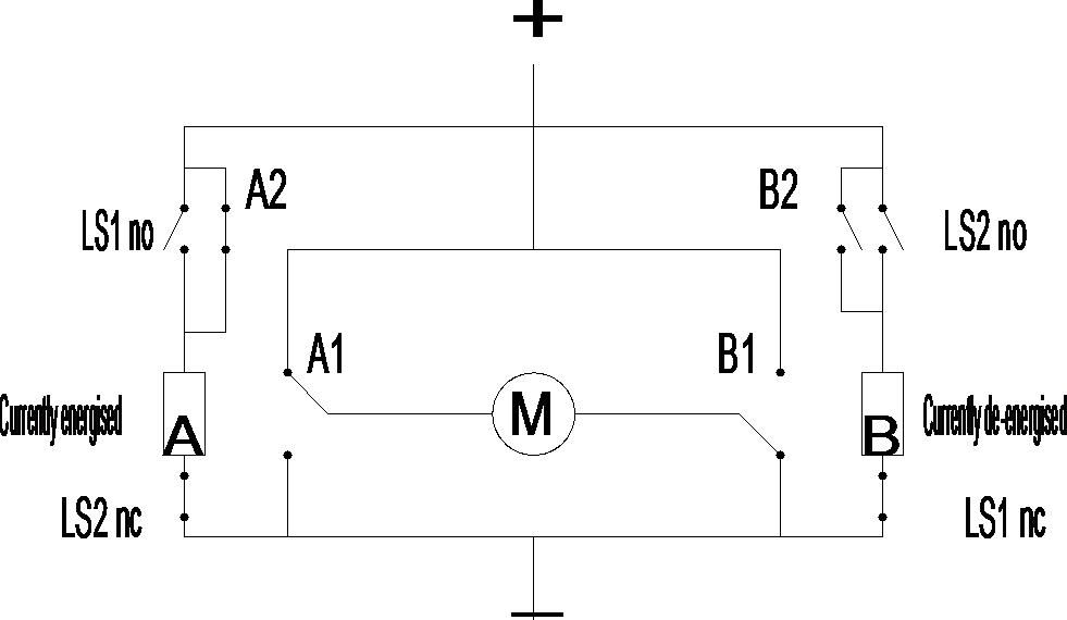

OK this should be the whole story.
In the diagram below - more or less the same as before just re-drawn to make it easier to understand.
The relays A and B are set up as an H bridge.
Contacts A1 and B1 will reverse the direction of the motor when one relay or the other is energised.
Contacts A2 and B2 are used to keep the relay on until the other limit switch is reached.
L1 and L2 are the limit switches - a standard micro switch.
A micro switch has 3 connections a common, NC - Normally closed and NO - Normally open. (normally means not pressed )
When the switch is operate it goes from NO to NC
The NC connections are used to break the relay line at the end of the run to turn off the relay and stop the motor. The NO connections then turn on the other relay to reverse the motor.
From here the cycle continues.
As shown the relay A is on (energised and the relay B is off) It is possible that this system can be stopped mid run and then neither relay will be on. To get things going operate one of the limit switches with your finger.
The relay needs to be a double pole double throw relay suitable for the voltage your using. The limit switches are suitable micro switches.
Because I don;t know our availability I can recommend any exact components for this but from the above you should understand what is happening and find something suitable.

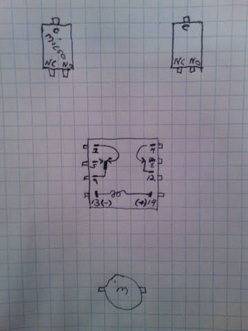

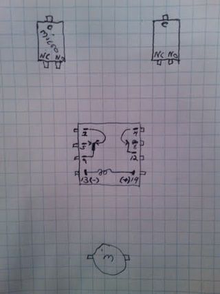

thank yall so much for your help but not shure i grasp were my wires all run witch way im attaching a photo of the dpdt relay an micro switches i got since i have done messed to relays up lol but im givin it a shot so my last qs is if it anit to much to ask could you draw witch wire goes to what pole an were on the pic i attached stupidfy it for me lol i just dont wanna mess up another relay or my motor
thanks so much for the help
