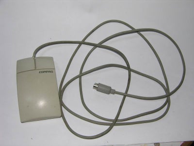

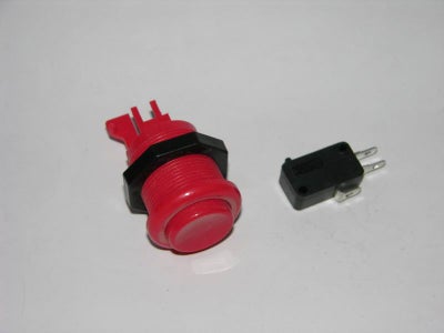

1 old mouse

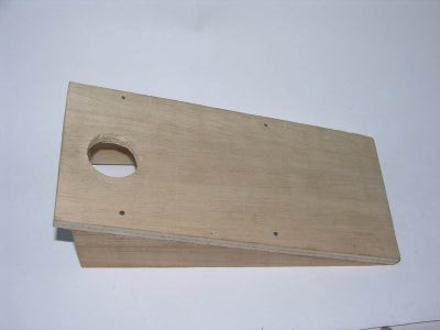

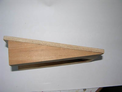

1 platform for support the footswitch
1 switch (game console switch)

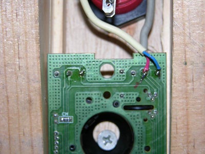

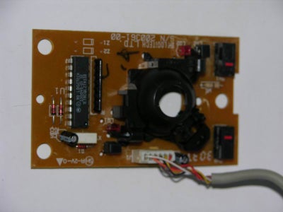

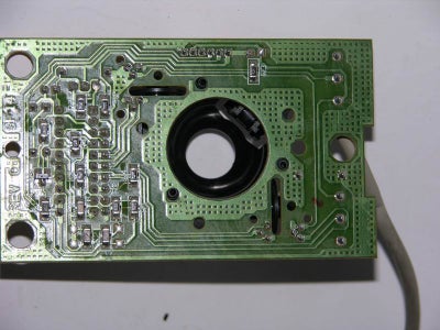

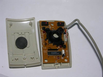

1- open the mouse
2- identify the place of buttons or terminals

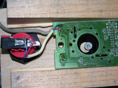

3- assemble the switch
4- solder the switch to mouse terminals

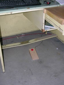

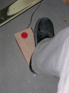

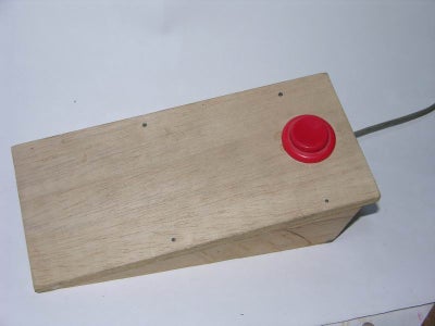

Step 3: Use the Footswitch
you can start using the footswitch,
your index finger will be thankful!
