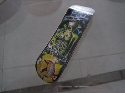

Introduction: How to Make a Fingerboard (my Style)
yeah! first instructable
here's how to make a fingerboard
finger skateboard
5 plys

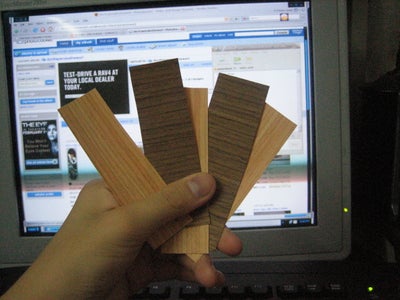

2 big sheet of veneers(2 different kinds[ cherry, oak, maple, etc ])
scissors

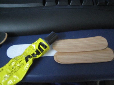

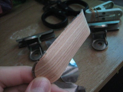

Step 2: Cut the Veneers
cut 3 veneers with the grains going vertical
2 veneers with the grains going horizontal
then cut it according to the template given

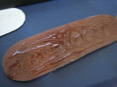

Step 3: Glue Them!
Any wood glue is ok.Just need it to go hard once it dries.So,apply them thinly and firmly on every ply.
make sure you stick them cross-plied.

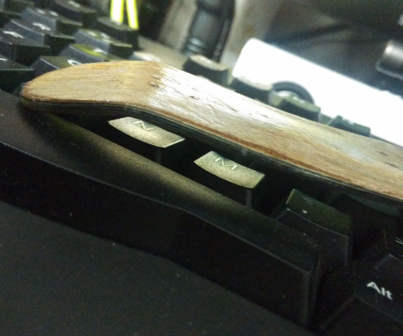

Then,use the clips or clamps to press the veneers in the aluminum mold.You can also use two tech deck's deck to be the mold.it works better

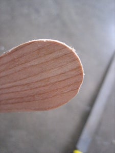

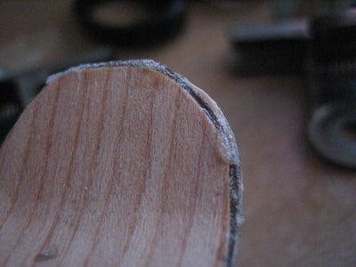

Step 5: Before Finish
you have to file the edge where there are excess glue and pieces of wood outside.you need it to be smooth to make it look PRO!

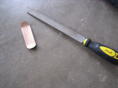

Step 6: File It
Start with the metal file.File the edge.the glue part.
then if not satisfied with the look,use the sandpaper to make it smooth.
