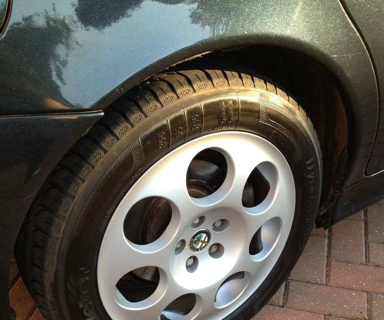

My wheels were looking dull and used and one of them had made contact with corrosive chemicals, I decided it was time to refurbish them and make them look like new again.

    careful with using oven cleaner on aluminum alloy wheels. if there is lye (sodium hydroxide) it may 'eat' away at the Al. It is very caustic. you can get excellent results using a tub of water your wheel fits into and some wet dry sand paper on a sponge. start with nothing coarser than 600grit and go up to at least 2000 grit. remember to feather out nicks and scratches.
    if you want to get super fancy use metal polishing rouge and you can make them mirror bright. I used to use Mother's polishing compound as a kid. worked great.
    before you paint get a self etching primer that is designed for aluminum. your paint job will come out better and last way longer that way. a good auto parts store or a paint/autobody supply store should have it or be able to get it.store
