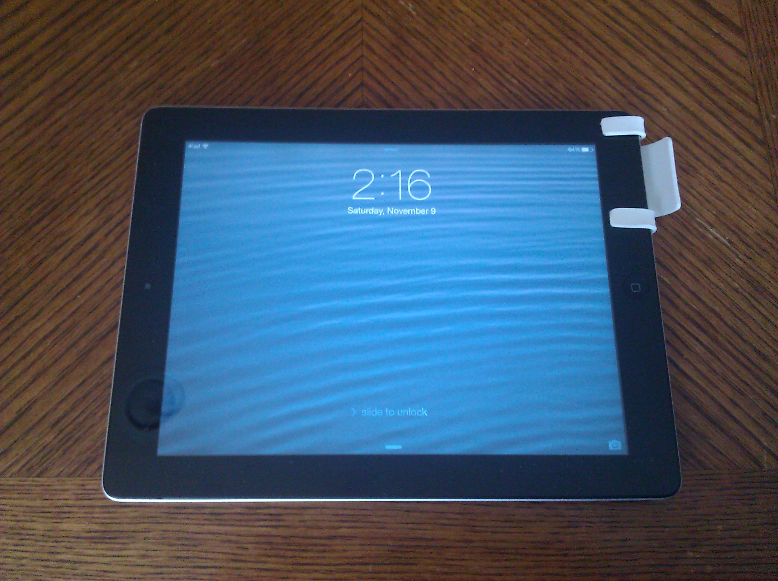

Step 7: Template
Draw a template on a piece of card stock. Transfer or copy the template to another piece of card stock. Use the second piece of card stock to make a prototype. Make sure all of the iPad's buttons and connectors are not obstructed. Adjust your master template if needed.
Step 8: Cut Out the Case
Poke holes through the center of each circle on the template. Lay the template on the PVC and mark the center of each hole on the PVC with a pencil. Then make a divot at each mark with a small knife or nail. This will keep the drill bit from walking. Drill the holes using the round saw. Use a ruler and pencil to mark lines from the edge of the circles to the edge of the PVC. Use a hacksaw or Dremel to cut along the lines.
Step 9: Mold Case
Use a heat gun to fold the tabs over to hold the case to the iPad. Be sure not to point the heat at one place very long or you will scorch the PVC. Do not heat your iPad! Heat the PVC by itself then mold it around the iPad one tab at a time. Do not fold the top tab all way over your iPad trapping it inside. Angle it up just enough so that the iPad will not accidentally slide out but will still allow it to be removed.
Step 10: Round Corners
Trim all the edges so they do not overlap the LCD screen using a Dremel cutting wheel. Then use a Dremel grinder to round off all the corners. Use sand paper to round and smooth all the edges.
