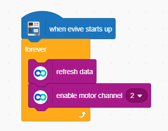

Step 8: Code
Upload the following PictoBlox code to evive:
Note: You need to add the servo channel block into the code, if you are using one.
