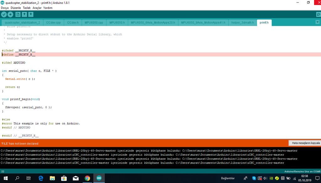

#include "printf.h"</spi.h></servo.h></p><p>//end of libraries ###############################################</p><p>MPU6050 mpu;</p><p>float x_rotation, y_rotation, z_rotation;

    #endif</p><p>printf_begin();</p><p>    Serial.begin(115200);</p><p>    Serial.println("Initializing I2C devices...");

TARUM08
TARUM08
9 months ago
Arduino kodu yüklerken hata mesajı alıyorum Ne yapmalıyım.
