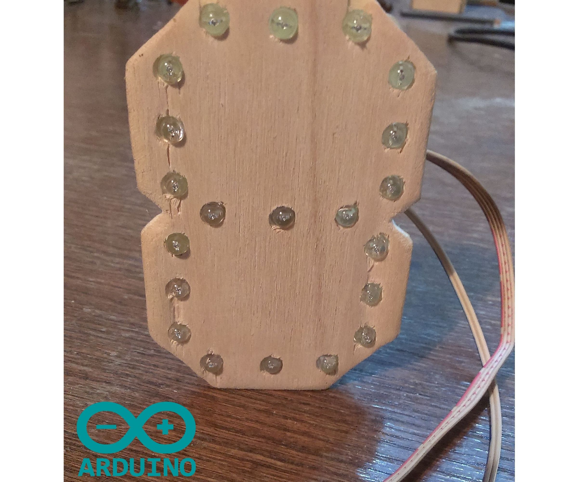

Step 3: Ball Indicator for Base
Drill holes where to glue balls and LEDs goes behind them.
I added those pieces of wood to isolate light from jumping to wrong ball.
You can wire them like any regular LED but I used transistors, there is scheme how I wired them, same way I did in this project.
I used transistors to power LEDs with another power source, not arduino, you should do this because arduino wont have enough current for all things(If you are using a lot of components you need to power for example).
