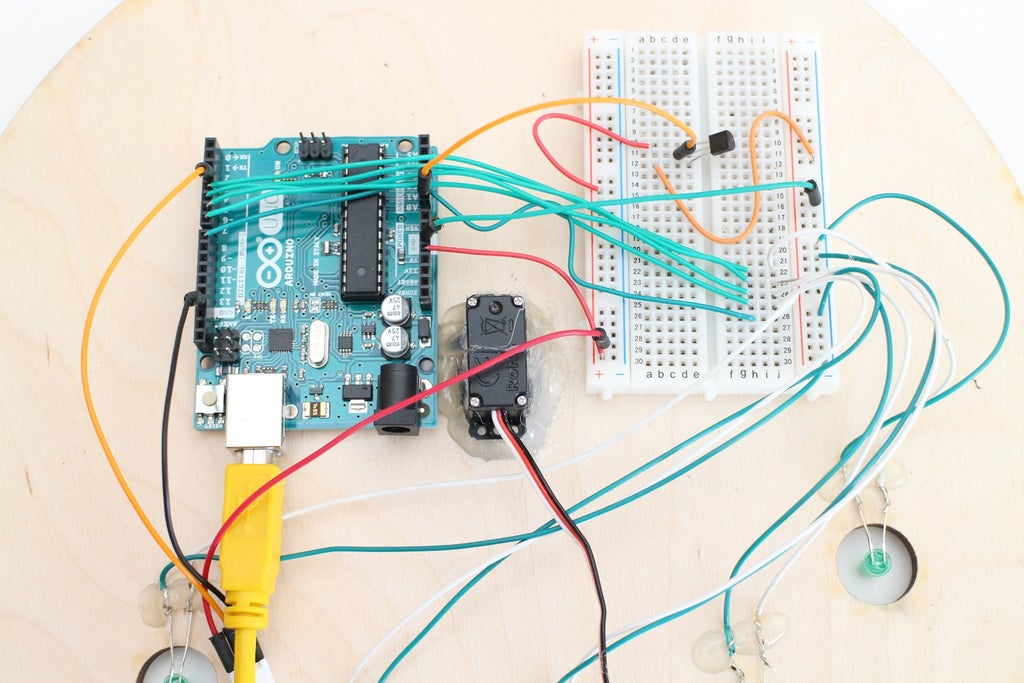

Step 7: Wiring Up LED's Part 1
Using double stick tape I fastened down the Arduino and breadboard onto the back of the clock. To begin wiring up the LED's I put all of the ground wires (green wires) into the negative column of the breadboard. Then I plugged in all of the power wires in order into the breadboard.
Step 8: Wiring Up LED's Part 2
Now add another wire from all the positive LED's leads to the Arduino. I used pins 4 through 8 for this, but you can of course use any pins you wish.
Step 9: Wiring Servo Motor
Begin by plugging in the servo power wire into the 5V pin on the Arduino. Then plug in black wire to GND and the signal cable (your might be white or orange depending on your servo) into a pin with PWM capability, I used pin 3. Once you have your servo plugged in and your LED's plugged in add a wire form the Arduino GND to the ground rail being used by all the LED's.
Step 10: Adding Temperature Sensor
This temperature sensor works by changing voltage depending on the temperature in the room, very similar to the way the light sensor would change voltage based on how much light was in the room. To wire up the temperature sensor begin by placing a wire from the middle leg, which is signal, to the A0 pin. In my circuit the signal wire is orange.
Then you are going to want to add power and ground to the sensor. This will require a slight modification to the servo motor circuit. Instead of plugging in the servo power directly into the 5V pin on the Arduino, run a wire from 5V power to the breadboard and then plug both the temperature sensor and the servo into the same row. If your circuit looks similar to the one below you're on the right track.
Step 11: Attach Clock Hand
