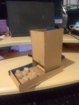

Hello Everyone,
In this tutorial, I will show you how to make a card board dice tower. For those of you who don't know, a dice tower is a small tower that you can put dice in through the top. The dice will travel down the tower and will hit many obstacles before coming out of the bottom. Dice towers eliminate the need for rolling dice by hand.  However, some dice towers are very costly, but not his one! Th dice tower I will make in this Instructable is made from spare cardboard and other materials you probably have around the house. Let's begin!
What did I make?
I made a cardboard dice tower, which lets you put in a dice on the top and then spit the dice out through the bottom. It works by hitting the dice with many platforms as it travels down the tower. To make this, I used carboard, pliers, hot glue, paperclips, a pen, a ruler, and some paper.
How did you make it?
I got the idea for the project when I saw a game at an arcade. In the game, the player would put a coin in a slot, and the slot would bump against many rods on the way down. This gave me the idea for how many dice tower should work. I worked on this project completely by myself. As I  made worked on the project, my designs constantly changed. Originally, the tower was actually supposed to be a small cube, but I realized the cube would not be able to hold enough obstacles. I also had many different designs for the location and shape of the platforms. Because my design was constantly changing, I started this project over and over many times.
Where did you make it?
I made this project completely at home. This project connects to my life because I am an avid board game player, and my opponents often cheat with dice. This ensures that they don't cheat.
What did I learn?
I learned a lot of stuff from this project.  One of the challenges I encountered while building the tower was when I finished. I put a die into the top of the tower, but it did not come out of the bottom. It turned out the distance between two platforms was too close, so the dice could not pass through. I had to completely disassemble the tower, change the distance between platforms, and rebuild the tower. I am proudest of the paperclip supports underneath each platform. I came up with idea for supports and built them all by myself. These supports allow the user to change the angle of the platforms inside the tower. If I had to build this again, I would test if the dice could travel through the tower before completely assembling the tower.

To use the tower, simply take a dice and drop it in the top, and the dice will fall back down and will randomly land on one of its faces.
Look at the attached videos to see how it works.
Trouble Shooting:
If the dice does not come out of the bottom, it is probably stuck in between the platforms. To ensure this doesn't happen again, take your pen and push down on the platforms. Since they are adjustable (thanks to my design), you can adjust their angle, so that the dice won't get stuck again!

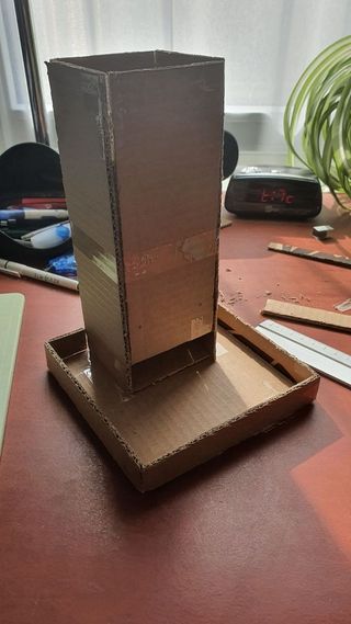

I had to practically break the tower after I assembled it because I couldn't get my D20 unstuck with the test roll ☹ I might make another one 50% bigger.. twice as big wouldn't have good portability 🤔
0
chipmunk22bdk
chipmunk22bdk
Reply 3 months ago
I just finished making this again but with all dimensions 50% larger, and now my D20 falls through beautifully. I also added a third paperclip support under each platform, simply for personal reassurance with the bigger pieces.

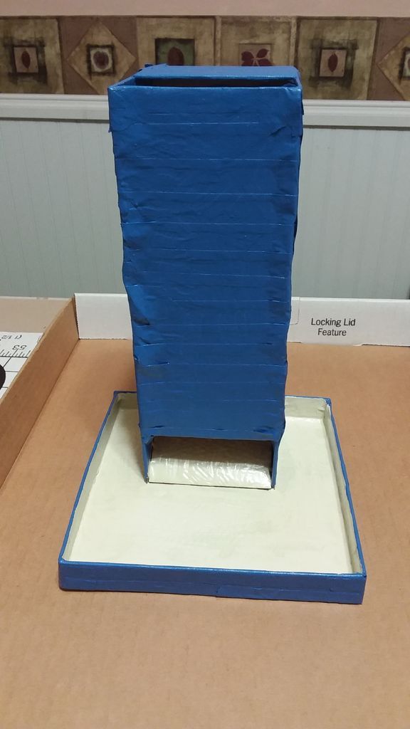

Great idea! If you encased the tower in duct tape, it would hold up longer. ;-) Voted!
