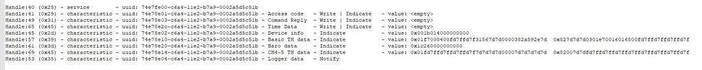

Hi, I want to get a history from the device as well.
How did you figure out this information about the device (0x80,0x00,0xff)?
I bought device BAR218HGX. It has service(74e7fe00-c6a4-11e2-b7a9-0002a5d5c51b) with bunch of characteristic.
I can write the value into some of them but it doesn't make any result.
I am not sure with an order of steps that I should do.
Should I enable all (indication/notification) characteristics before the writing values?
I am not sure about the accurate characteristic which I need to write value.
Could you look at my information below (image)?
Maybe you will have some ideas or tips for me.
