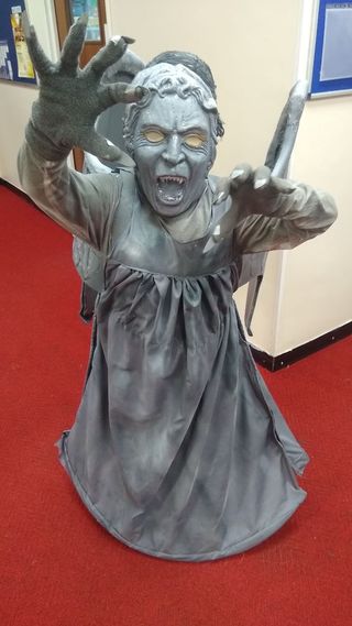

Introduction: Doctor Who Weeping Angel Costume
The Comic Expo was coming again and my Daughter wanted a new costume.  And who am I to say no to another Dr. Who costume.  This build took me three months.  If I had more time in the day I probably could have built in two to three weeks.  Before I started building this I searched the web for every picture I could find from the show.  I've attached a couple here.  This helped me get ideas on proportions and how it should look in the end.
One thing I will say before you start this build.A hot glue gun is going to be your best friend.I lost track of the amount of sticks I used.

And that’s it, time to put it all together and have fun freaking people out.
Recognize a few faces?  And yes, the gentleman with the scarf is a HUGE Who fan.
