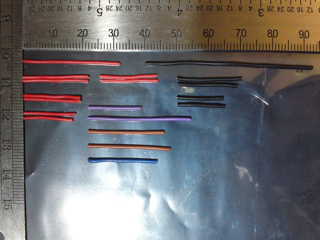

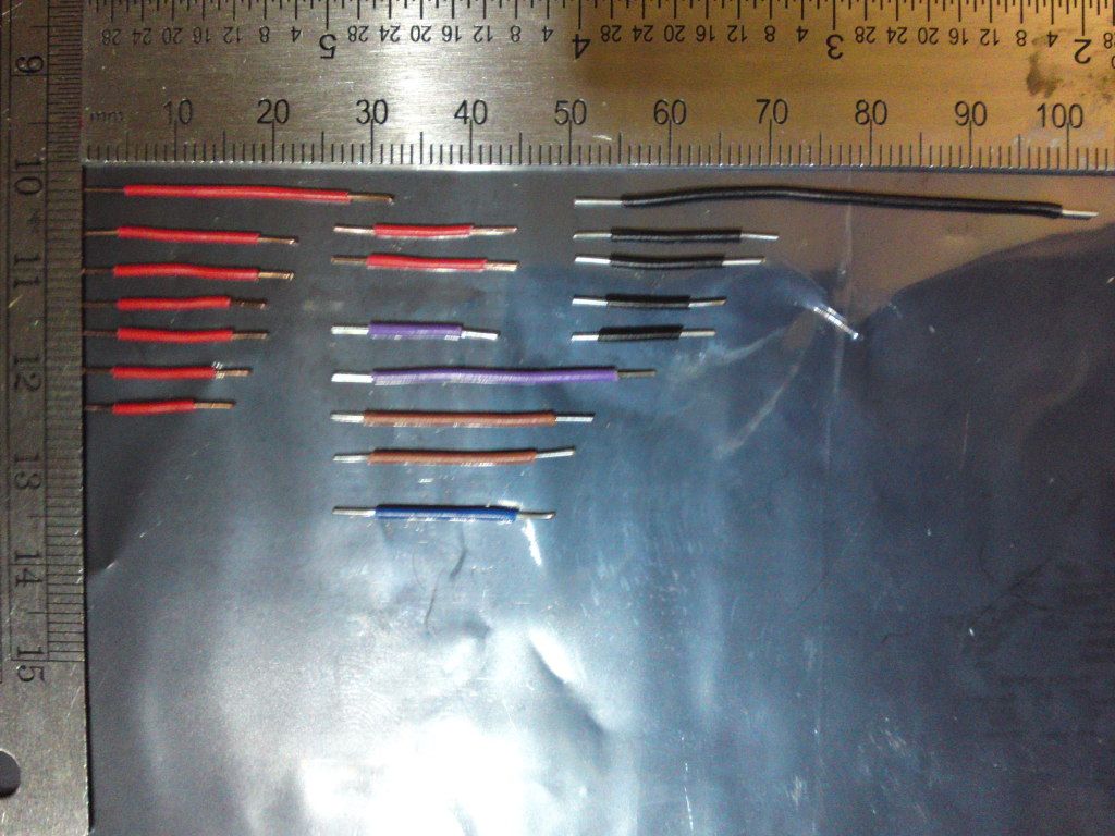

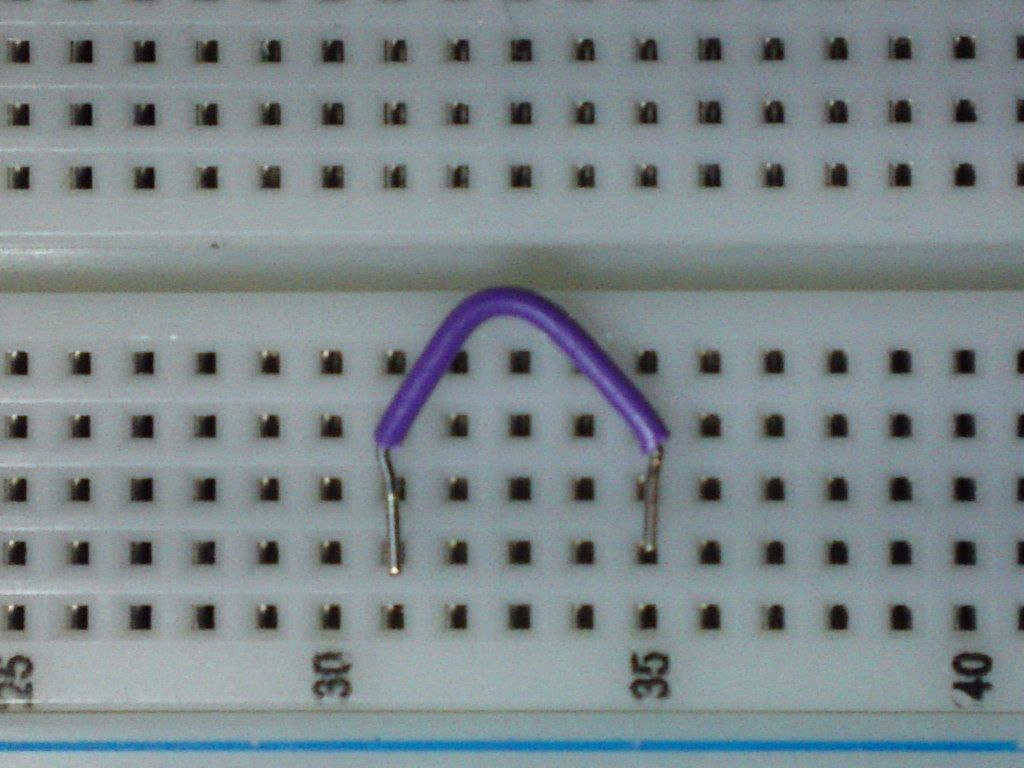

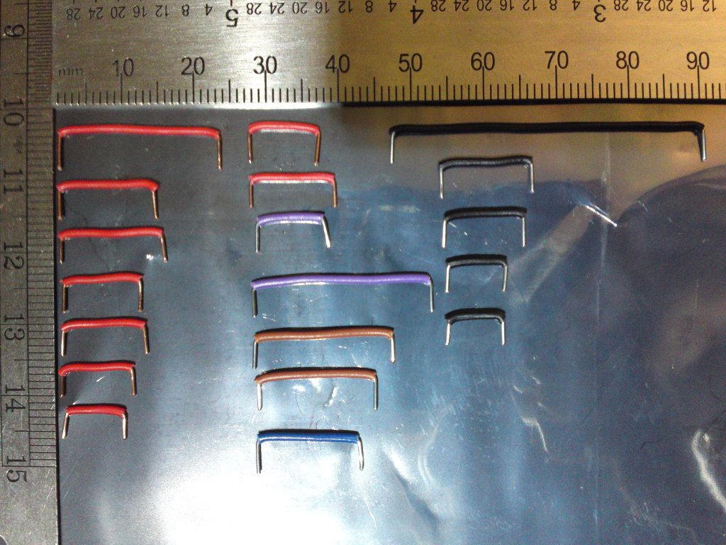

- Now, start by chopping up some single-core wire into the different lengths(or just chop them as-you-go!) so that your breadboard adventure for this project will go a little quicker and i have included a few pictures with a ruler to show all the wire links i used so you can roughly see what kind of lengths are needed but i dont get my wire links perfect 1st-time and it takes a few tries to get the right length but this is a good thing because it just means that with the colours of the wire links youve made whilst making them for this project means you can use them in many other projects as well in the future so it wont be a waste to try a few times to make the wire links!
After you have your wire links, its time to start !
The Power Supply:
NOTE: its VERY-Good practice to leave the 'Power' colours of the wire links as BLACK for the Negative (-) and RED for Positive (+) as it just makes life Soooooooo-Much easier later on to clearly & easily see which sections of the breadboard are specific to Power (Either battery or mains power!) !!!

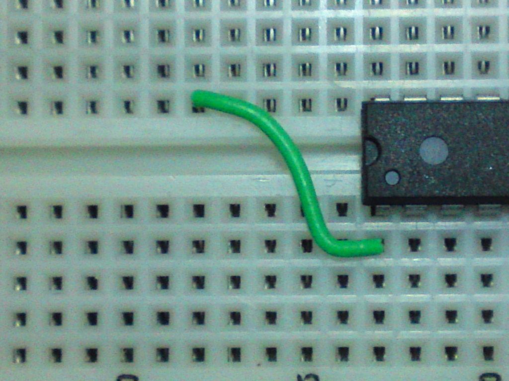

Also i used a bit of Green Single-Core wire & its not in the first 3 pictures but you will easily spot it when its used (For the Tactile MicroSwitch!)
The Bottom-LEFT picture (Picture 1) is showing that you cut your wire lengths a little bit longer on both ends so that when you strip them you'll have enough bare wire to slot into the breadboard holes, The Bottom-MIDDLE picture (Picture 2) will show what im barking on about, lol, & the Bottom-RIGHT picture (Picture 3) is simply showing how to have the bends in the pieces of wire!

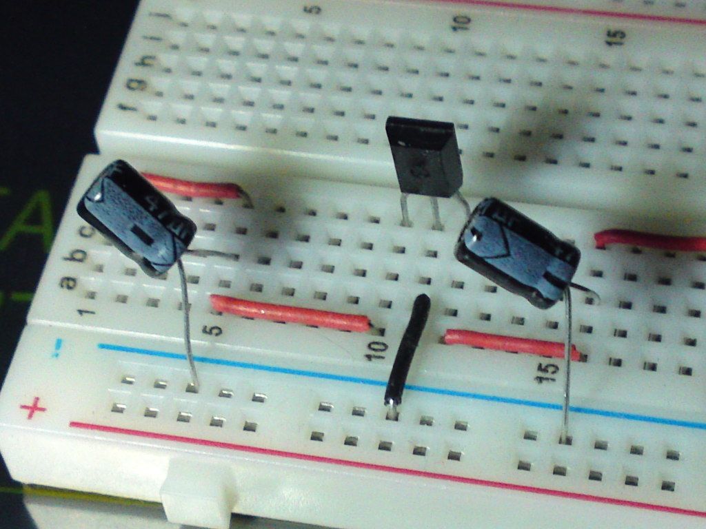

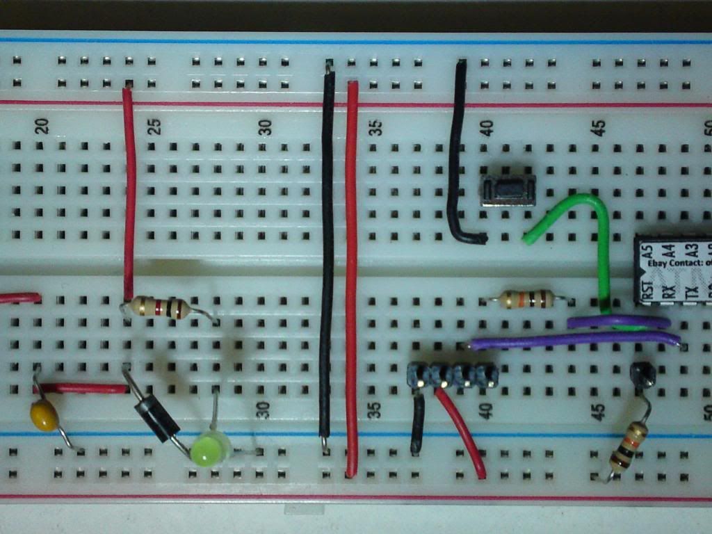

Start by looking at the picture below (Picture 4), and copy the wires exactly - NOTE: the Blue-Negative-Power-Line on the breadboard is at the TOP.

You will need: Both 47uF Electrolytic Capacitors & The 5v Voltage Regulator {Im showing the insertion of the Low-Power Voltage Regulator first (The KIA78L05) and this one is the SMALL TO-92 Type} Shown below (Picture 5), CAREFULLY Observe the Capacitor Legs going into the correct holes, the SHORTER LEG is the MINUS (-) and must slot into the NEGATIVE ( - ) Power Rail on the breadboard ! As for the 5v Regulator make sure the ROUNDED part is facing you and the flat side is NOT facing you, as shown by the Picture's View from above ! The picture Below_RIGHT (Picture 6) is showing the above installed parts from an angle to better see which holes the legs have been inserted into...
Looking at the Voltage Regulator in the above two pictures, from LEFT to Right the PIN-Labels are:
NOTE & WARNING: THIS IS FOR THE KIA78L05 VOLTAGE REGULATOR, YOU MUST CHECK THE PIN-OUT CONNECTIONS TO THE VOLTAGE REGULATOR YOU ARE USING WITH THE SUPPLIED DATASHEET LINKS ABOVE !
INPUT Voltage > GROUND > OUTPUT Voltage
(RED Wire) (BLACK Wire) (RED Wire)

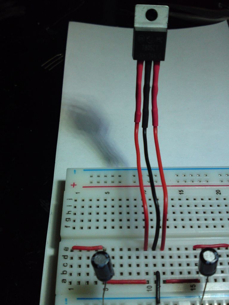

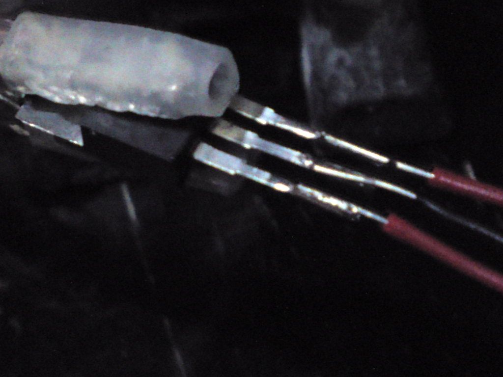

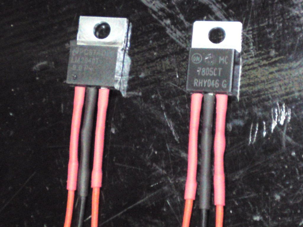

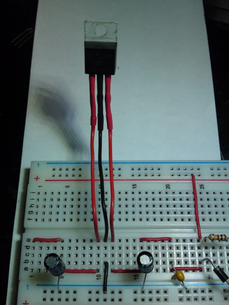

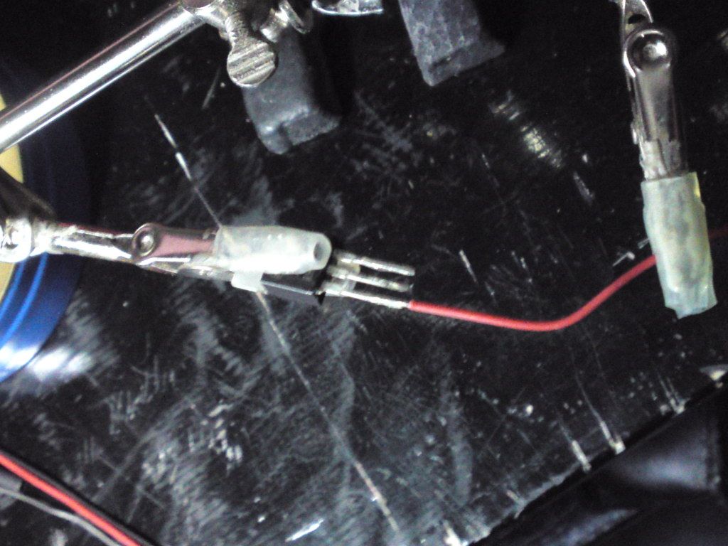

Now i will show you how i use the BIGGER TO-220 Type Voltage Regulators with breadboards without damaging the holes and causing intermittent connection problems that these bigger type Regulators cause within the holes as their LEGS are very thick and not designed for breadboard prototyping so to prevent enlarging your breadboard holes this is what i do:

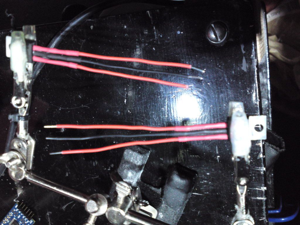

The 1st Thing i do is solder some short pieces of single-core wire onto the legs of the TO-220 Type Voltage Regulators (Assuming that you will always use this Voltage Regulator for prototyping purposes only and not be soldered into a permanent Arduino Project so its always Dab-Handy to have a few of these in your inventory of components!) and after soldering i use heat-shrink to cover up all the exposed bare-metal and wires that i do not want creating short-circuits when using these in my breadboards...
The pictures Below are showing the process of soldering the wires to the legs of the Voltage Regulators and i use RED wires for the INPUT and OUTPUT leg and BLACK Wire for the GROUND leg:
If you do this as well then you wont ever have the problem of having 'Enlarged Holes' in your breadboards and it will save you time and effort taking apart your breadboard to affect-repairs! Also as i had a few things to solder i usually keep a box specially for things that need soldering and wait until either i need them soldered or when there are more than 5 different items needing to be soldered so im not continuously getting my soldering kit out like a Yo-yo, lol
On with the instructable! lol
Next, bend ONLY ONE of the 0.1uF (100nF) Capacitors as shown in the small picture Below-LEFT (Picture 7) and insert it any way you like into the holes shown in the 2nd picture Below-RIGHT (Picture 8) but..... When a component can be inserted any way i always prefer to have the side that has the writing-on showing & facing me, thats only due to personal preference, its completely upto you !
Grab the 1N4004 Diode and bend it just like shown in the small picture Below (Picture 9) but Pay SPECIAL Attention to the Grey STRIPE and what side its on !!! This is added for Reverse Polarity Protection! Also grab one 1K Resistor (Colours: Brown,Black,Red,GOLD) and bend it like shown in the 2nd small picture Below (Picture 10), and Grab the GREEN LED and Closely Observe it has a FLAT-NOTCH on one side of it as shown in the 3rd small picture Below (Picture 11), This is the Cathode Side or MINUS ( - ) Side (NEGATIVE) and the LONGER Leg is the Anode PLUS ( + ) side , bend this as shown in the 4th small picture Below (Picture 12)... (Now if you want to keep the Parts-Count as Low as Possible you can choose NOT to use the LED or 1K Resistor in this step)
Once These 3 components have been prepared,insert as shown Below: (Picture 13)
Picture 14 is showing the newly completed section which is shown just after the heading, The Power Supply above!
DONE !!! - Take a little break as you've just Completed The Power-Supply Section of This Guide !! But Wait !!!!

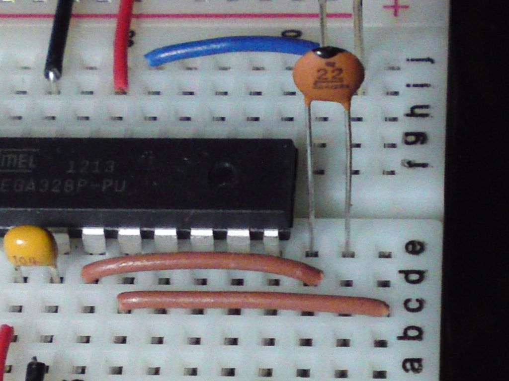

So Look at the picture below (Picture 6) and insert the ATMEGA Chip into the breadboard as shown Below MAKING SURE that PIN1 is inserted into the LOWER-BOTTOM-LEFT had-side of the breadboard (Click on Picture 6 in the LIST of pictures just under the title of: Step 2 Section 2 - The ATMEGA328P-PU Microcontroller ! above for notes displayed onto Picture 6)

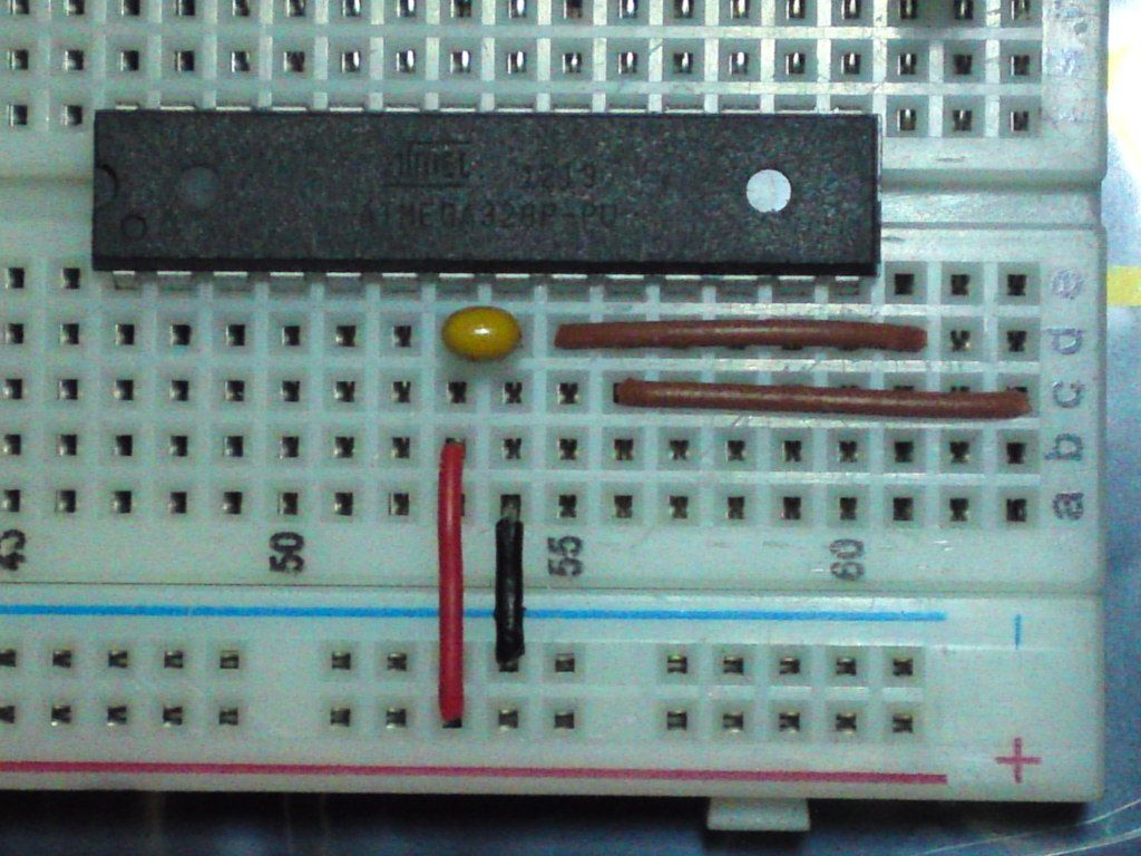

Ok now grab the last 0.1pF (100nF) Ceramic Capacitor and place as shown in Picture 7 (into the holes where PIN 7 & PIN8 are on the ATMEGA Chip!) along with the two power wires also as shown (RED Wire to PIN7 & BLACK Wire to PIN8 of the ATMEGA Chip!)

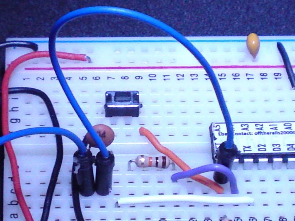

Add the next Two brown wire links as shown in the 1st picture Below-LEFT (Picture 8) {into PIN9 & PIN10 of the ATMEGA Chip} - these are for your choice of installing either a 16Mhz Ceramic Resonator (with Built-in Capacitors) OR a 16 Mhz Quartz Crystal Resonator that must have TWO accompanying 22pF Ceramic Capacitors... Firstly i will show how to connect the Ceramic Resonator - place this as shown in the 2nd picture Below (Picture 9), these resonators you can place in any direction but i like to have the writing on the component facing me but you can place them how you please, placed into the 3 holes that are shown in 2nd picture Below-RIGHT..
In the picture Below (Picture 10) place a black Ground wire ( - ) as shown !

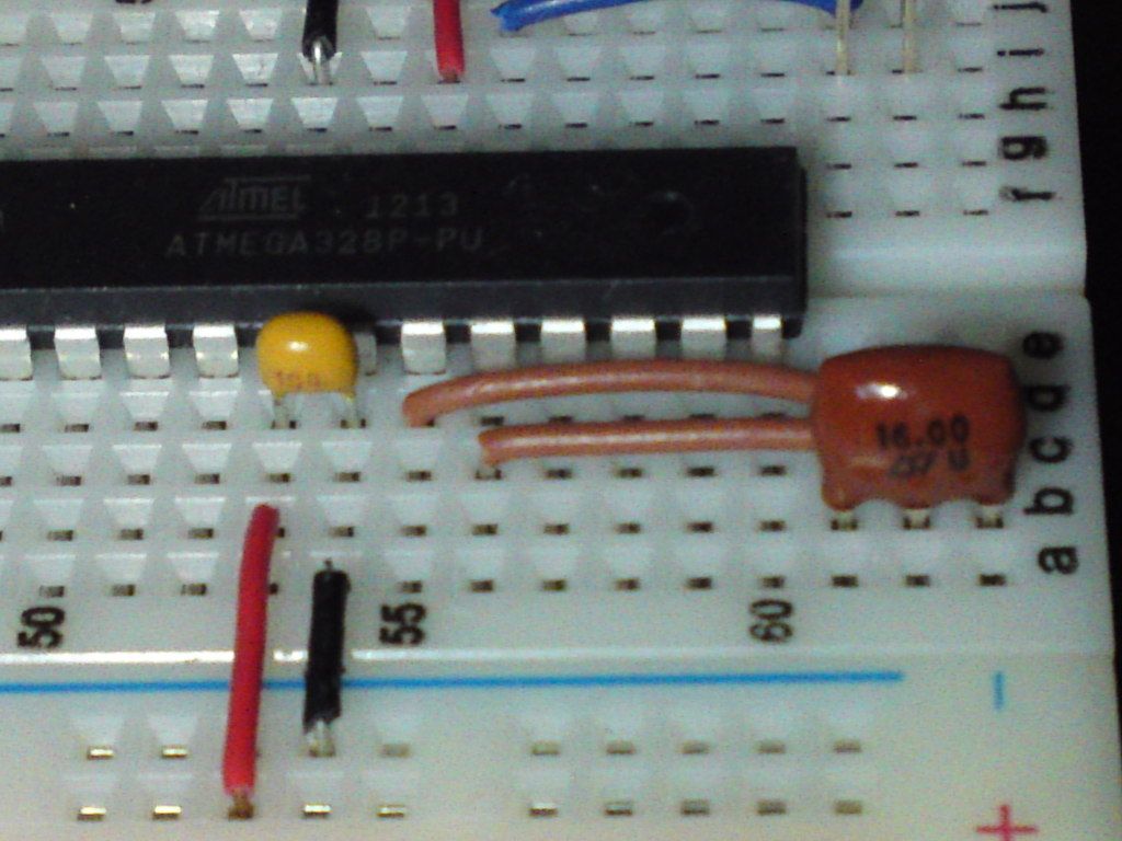

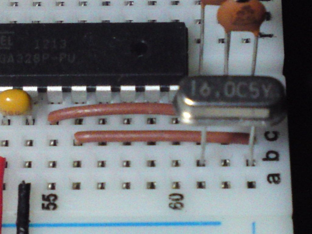

Now we will be installing the Quartz Crystal Resonator in place of the ceramic one, If you either dont have a Ceramic Resonator OR your project is a timing project that needs greater accuracy then the picture Below-LEFT (Picture 11) shows just after installing the two brown wire links and the Capacitor added on the picture on the picture Below-LEFT is the first 22pF Ceramic Capacitor and the Below-RIGHT picture (Picture 12) is showing the second 22pF Ceramic Capacitor in place...
The Below-LEFT (Picture 13) shows placing the Quartz Crystal Resonator - now - you can put these in any way round in the two holes its in but again, i prefer to be able to read the writing printed on the top of them but its completely up to you how you want to place it ! And finally the picture Below-RIGHT (Picture 14) shows adding the Black 'Ground' wire link and thats it for the part on Resonators !
So Now you Can Choose which type of Resonator you want to use or that comes with your kit !!

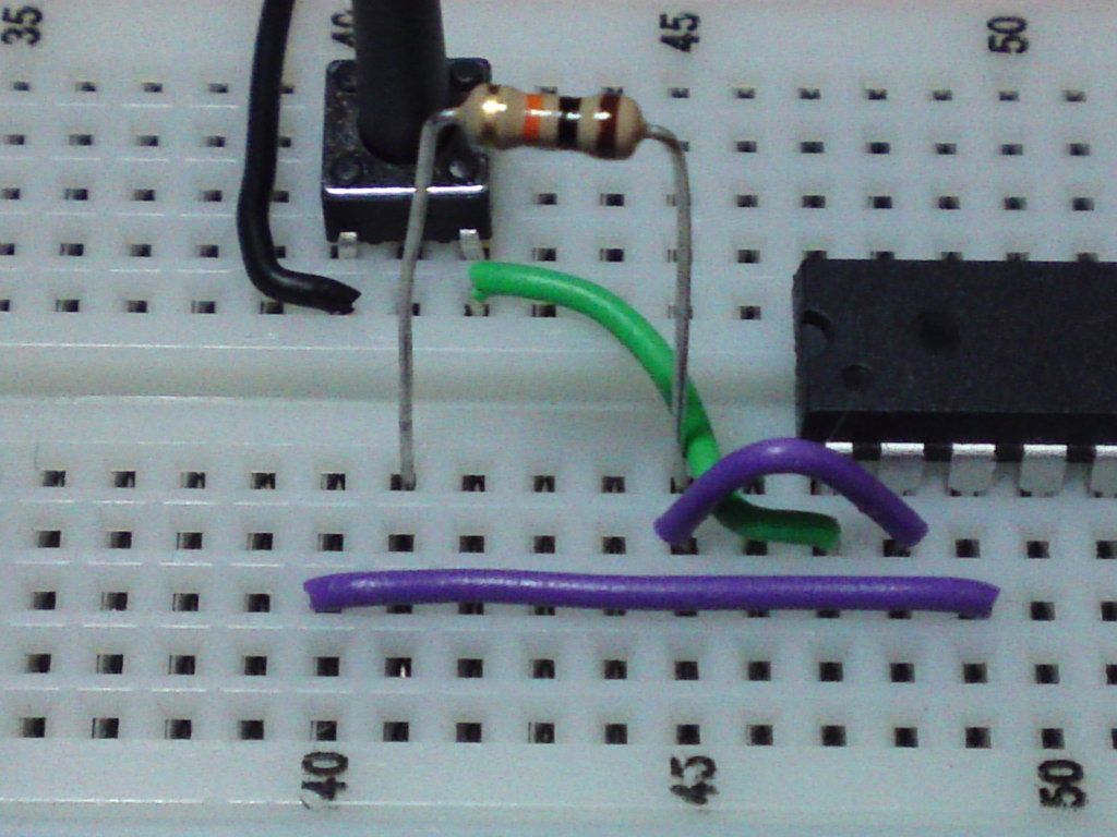

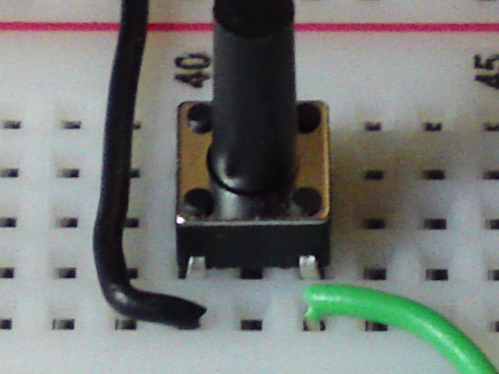

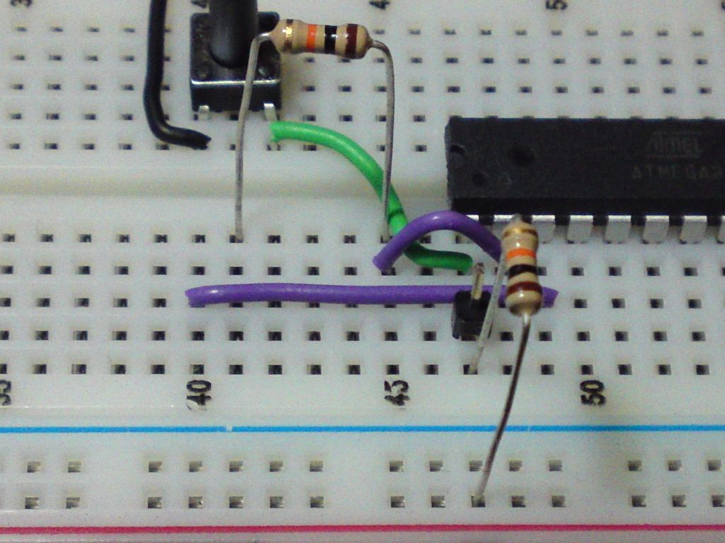

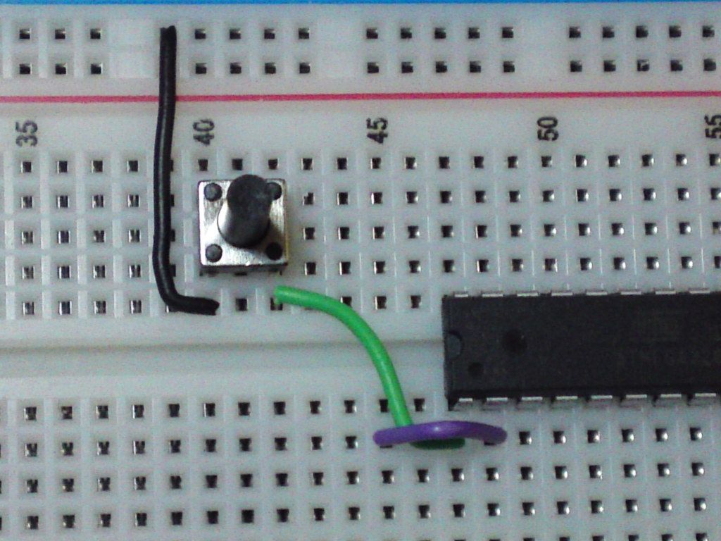

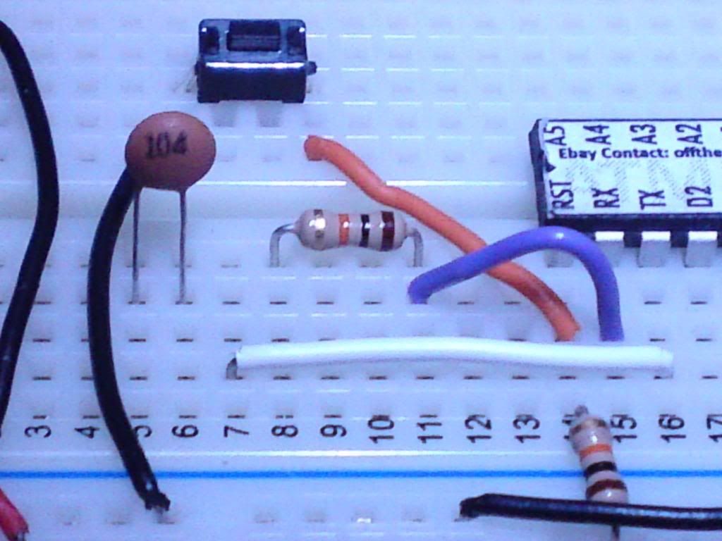

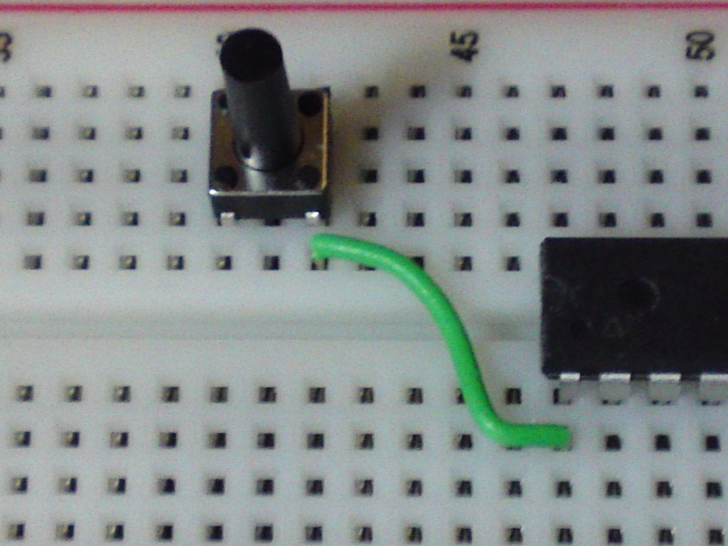

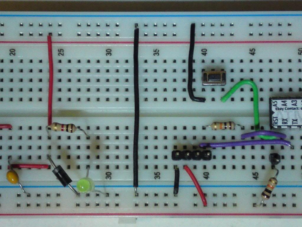

For installing the Tactile Switch (Which is used to either Reset the Breadboard Arduino or to initiate the "Manual Reset To Upload Sketches" which i will cover in the last Section of this Guide!), look at the TOP-LEFT picture Below (Picture 15) to start with placing a Green wire link like so, Then look at the TOP-RIGHT picture (Picture 16) Bend a purple wire link as shown - this makes it easier to place into the holes without interfering with any other wires, insert the switch as Shown in the BOTTOM-LEFT picture (Picture 17) then insert the Bent purple wire-link in the BOTTOM-RIGHT picture (Picture 18) ! { The GREEN wire link is first inserted into the PIN1 of the ATMEGA Chip & the Bent Purple wire link is inserted into PIN2 of the ATMEGA Chip which is the "RX" pin used for uploading sketches to the Arduino}
Now add a Black power (Ground) wire link as shown in the picture Below-LEFT (Picture 19) and the picture Below-RIGHT (Picture 20) is a close-up showing which way round the switch goes!

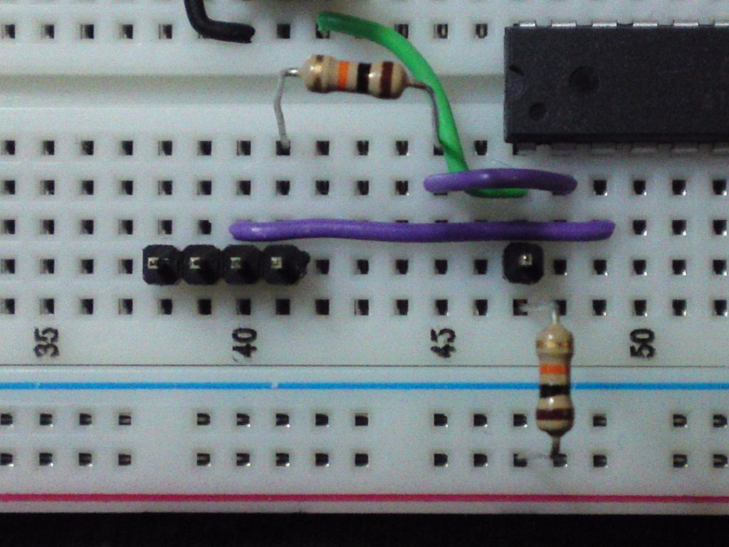

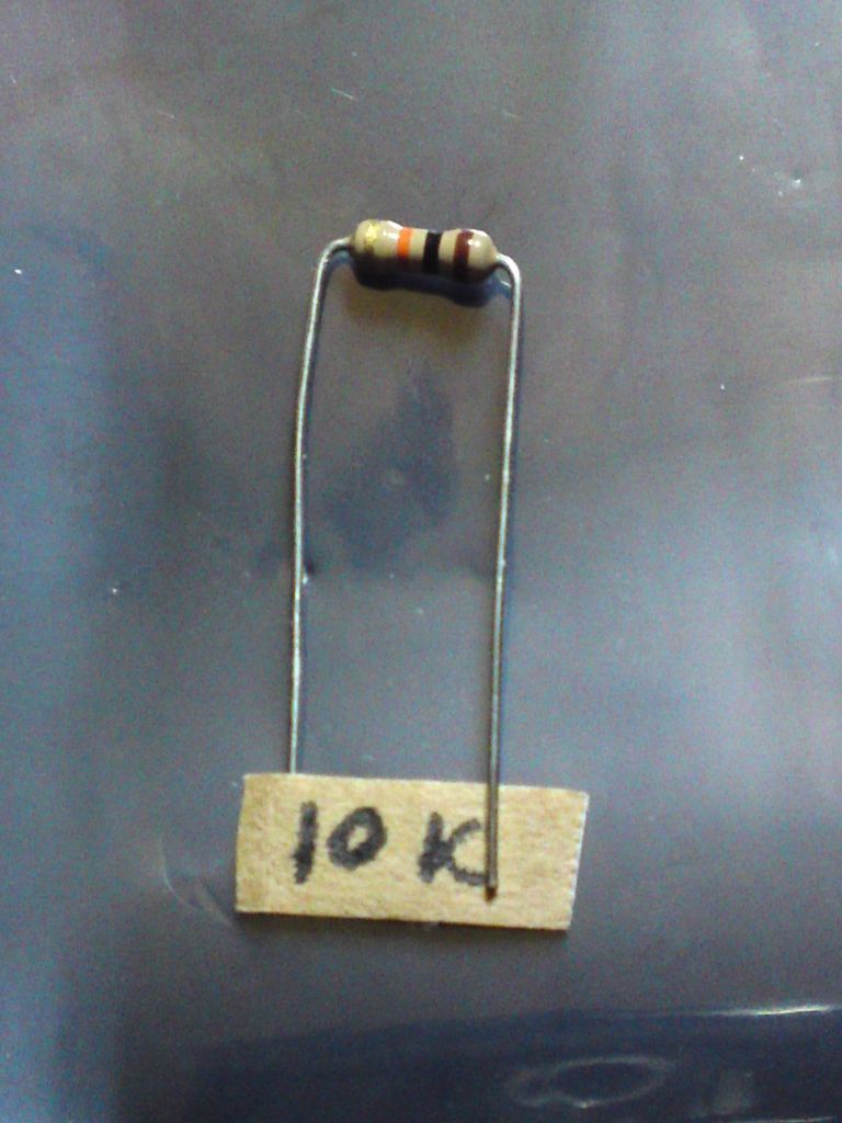

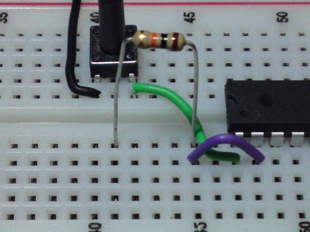

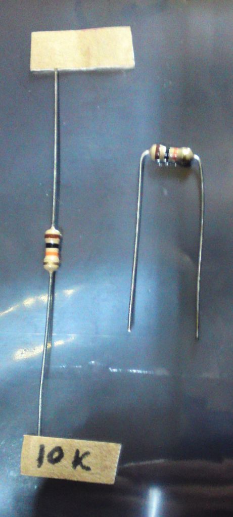

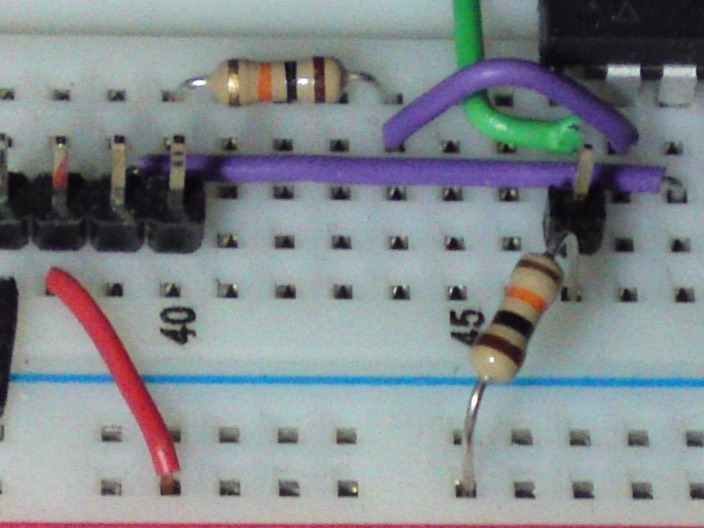

Now Bend both the 10K Resistors (Colours: Brown, Black,ORANGE,GOLD) as shown in the TOP-LEFT picture Below (Picture 21) & Bend the 10K Resistor as shown in the TOP-RIGHT picture (Picture 22) and insert the first 10K Resistor as shown in the BOTTOM-LEFT picture (Picture 23) Then add another purple wire link as shown in the BOTTOM-RIGHT picture (Picture 24) ! { Longer Purple wire link is inserted into PIN3 of the ATMEGA Chip which is the "TX" pin used for uploading sketches to the Arduino}

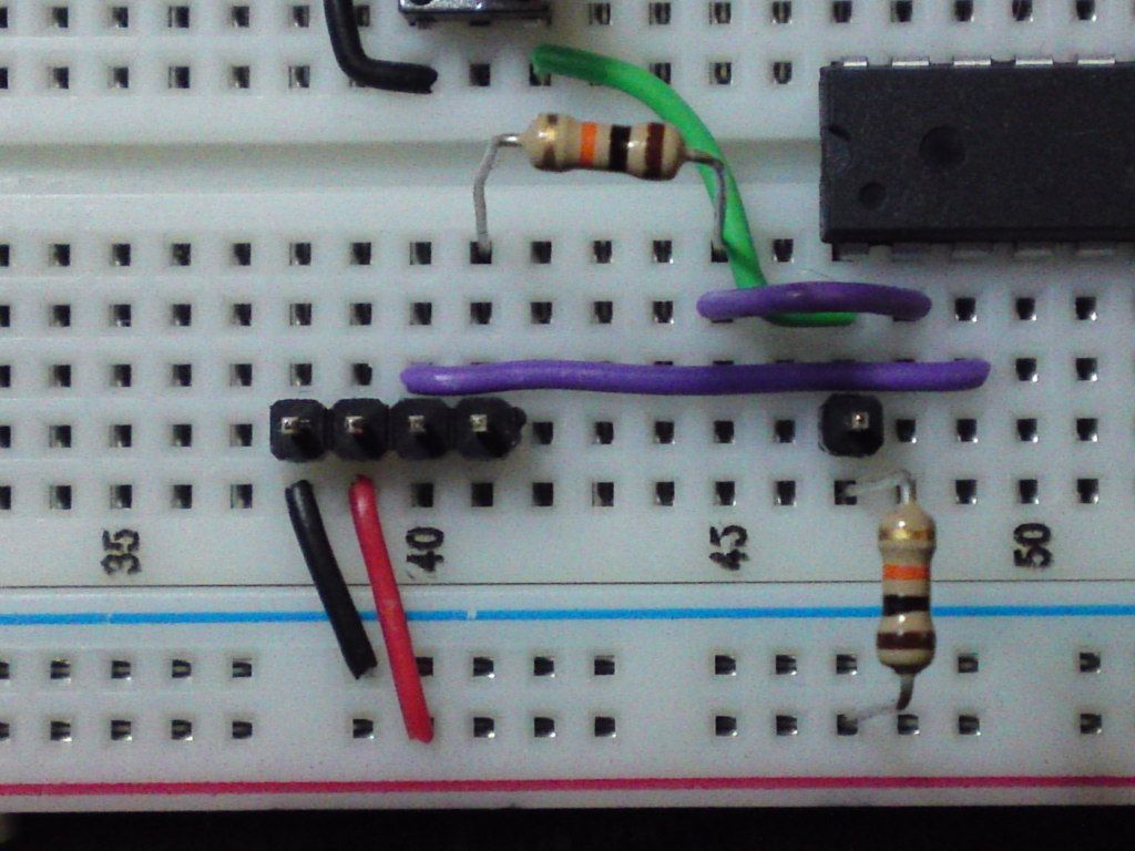

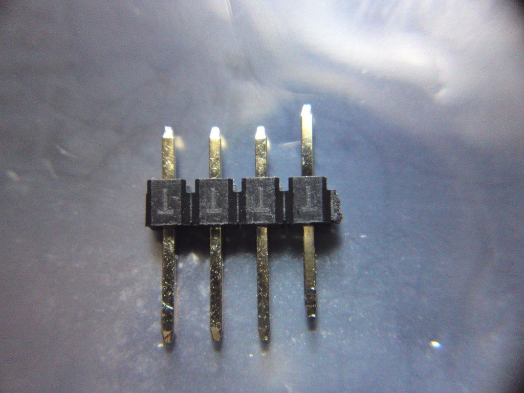

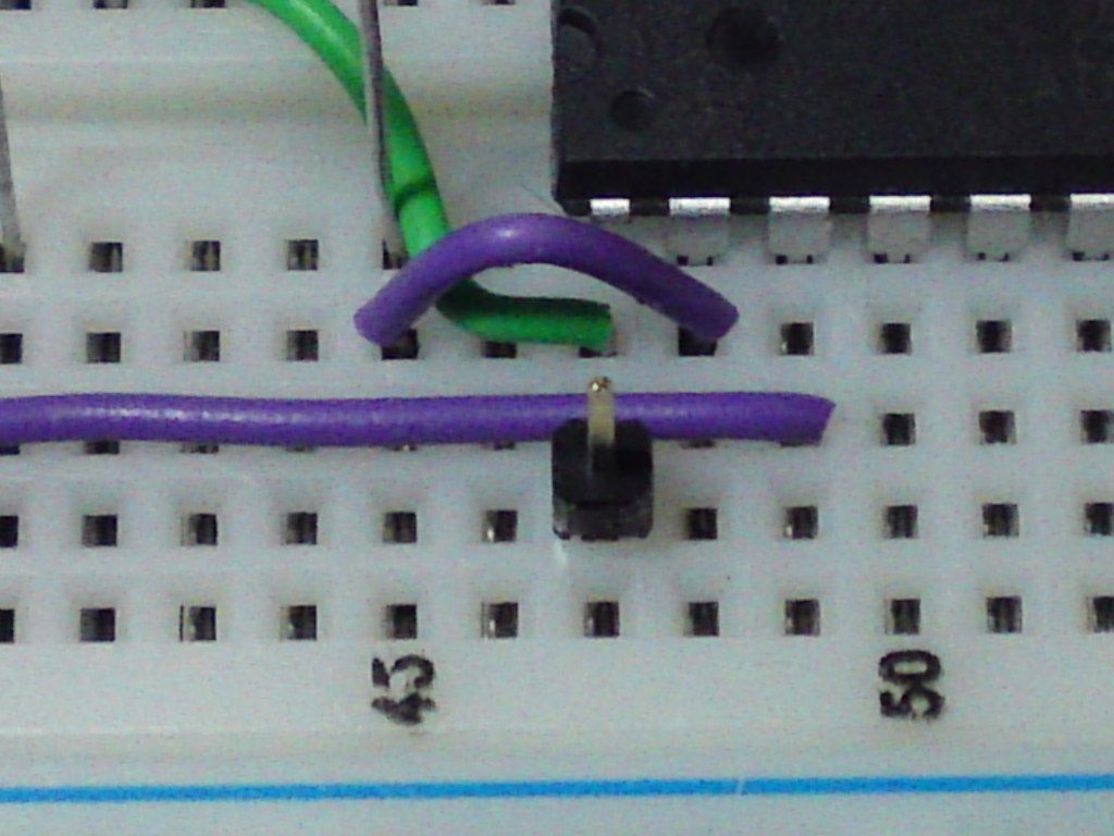

insert a Single-Pin-Header into the hole as shown in the picture Below-LEFT (Picture 25) & Insert the last 10K Resistor as shown in the picture Below-RIGHT (Picture 26) {This is the Breadboard Arduino's RESET PIN and this will be needed for Uploading Sketches the "AUTOMATIC SOFTWARE RESET" way as i really cant be bothered exactly "Timing" however many seconds it is to hit and release the reset switch when uploading my sketches so i always use the software-reset & its just done automatically as soon as i press upload-button on the Arduino IDE Software and not be EVER hassled with my sketches EVER FAILING to upload !!!}
The next 3 pictures Below (Picture 27, Picture 28 & Picture 29) are all showing what i do to these male-pin-headers to make them stay inserted into breadboards because they tend to pop out as soon as you insert them, you can see from the 1st Bottom-Left picture (Picture 27) the first three pins at the top don't have enough of their length to stay inserted in breadboards so observe the last pin which i simply pushed through the black plastic housing, do this to all the pins and they will make better connections in the breadboard for later Uploading Sketches! The Bottom-Middle picture Below (Picture 28) is showing a set of four pins that ive pushed through the plastic to make them an even length on both sides and the two sets of pins showing on the Bottom-Right picture (Picture 29) is showing how they normally come and my pins that are of (almost!) equal length of both sides!!

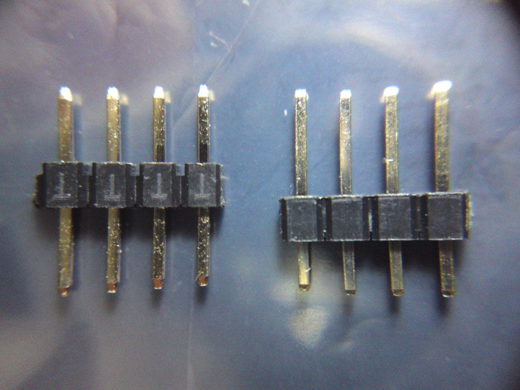

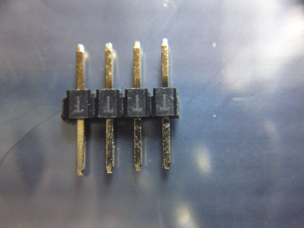

Next Insert the 4-Pin headers into position as the two pictures Below Left & Below Right (Picture 30 & Picture 31) These are showing that the 3rd Pin of the Headers is connected to PIN 3 of the ATMEGA Chip through the Longer Purple wire link and the 4th Pin of the Headers is connected to the 10K Resistor which is connected to PIN 2 of the ATMEGA Chip through the Shorter Purple Wire Link - DO NOT GET THIS WRONG or you wont be able to UPLOAD Sketches without having problems !!
Add the two power wires as shown in the two pictures Below (Picture 32) & (Picture 33) and the picture on the Right (Below) is Showing you what the pin labels correspond to on the 4-pin header when its time for Uploading Sketches in the last section of this instructable! ! !

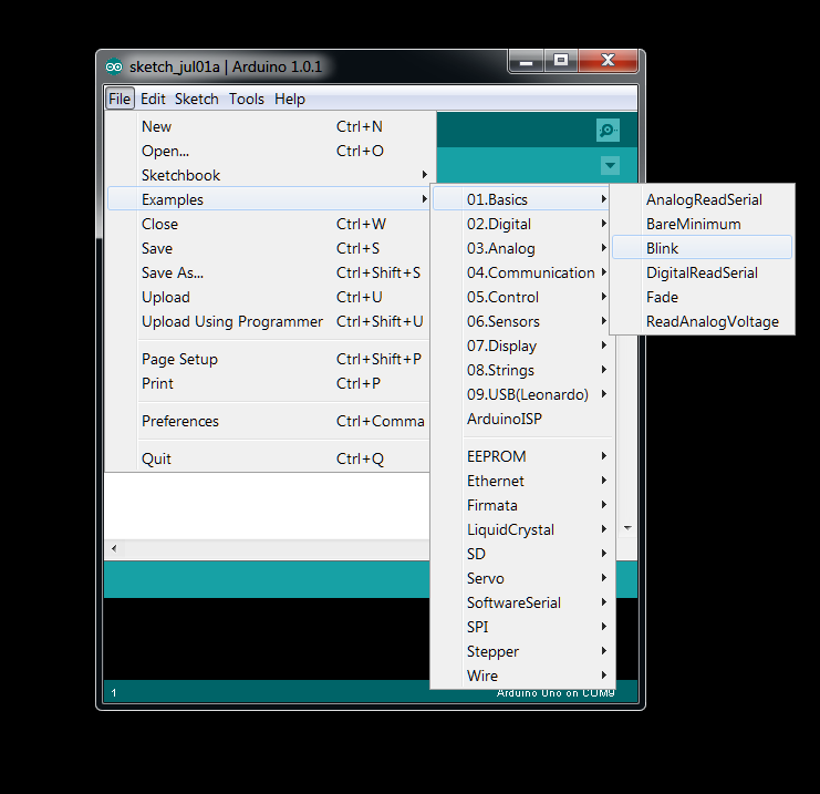

Now we will upload the 'Blink' sketch to the Breduino using Three different USB modules (These are the only ones i have !) and show how to connect these upto the Breduino and the pins needed to Upload Sketches:

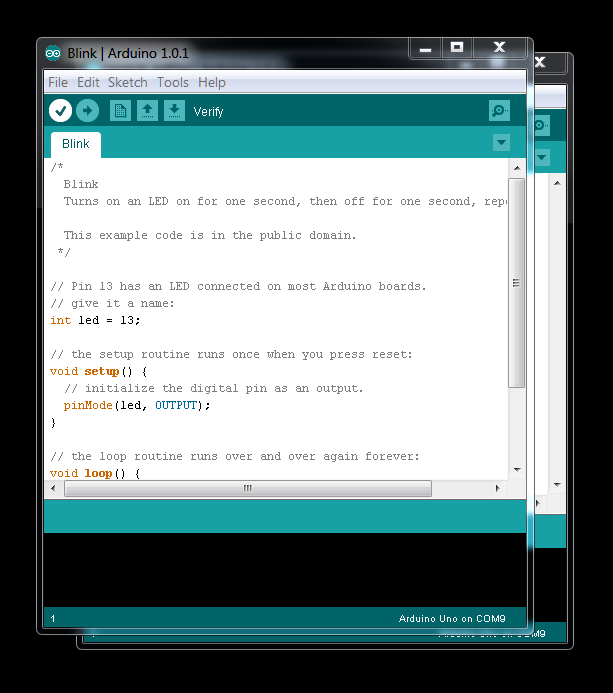

The test Sketch we will be using is called 'Blink' and is found in the Arduino IDE under; FILE>EXAMPLES>BASICS>BLINK - this is the sketch we will use to upload to the Breduino !
The 'Blink' Sketch is a batch of instructions (Arduino Code) that will enable any Arduino-Based Hardware to Flash (or 'Blink') an LED that is Connected to PIN 13 of an Arduino/Arduino Compatible (Breduino!) and will flash the LED every 1000ms (ms=milliseconds) so basically every 1 second but this can be changed in the sketch to suit you!

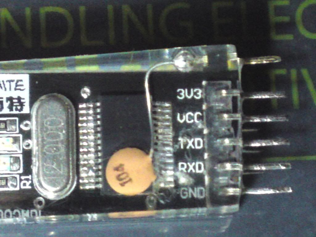

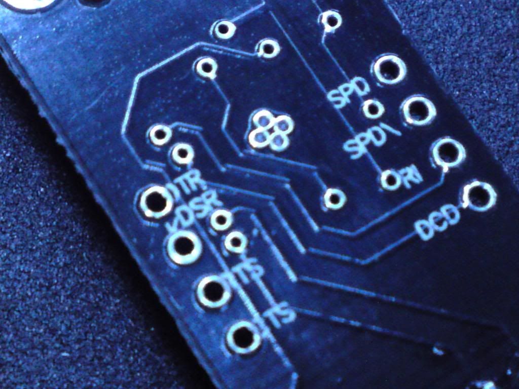

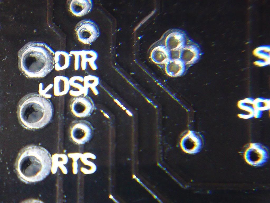

The picture above is from a PL2303 module i modified to take advantage of the "Automatic Reset" of Uploading Sketches (Software Reset) so all you'd need to do is hit the Upload Button on the Arduino IDE Software and sit-back until your sketch uploads! See end of this Guide to find out how to get one thats already modified or if you'd like to modify it yourself then the link to those instructions are there too!!!)
This PL2303 USB Module isnt the easiest to modify as it involves soldering a capacitor leg to a very fine pitch SMD IC but if you can get your hands on some casting resin, this is what you can do with it, heres what ive done to protect the fine-pitch soldering on the PL2303 modules:
Also changed the Red power LED to a Blue one too !

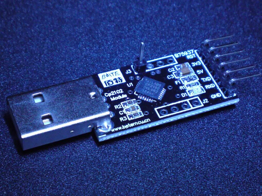

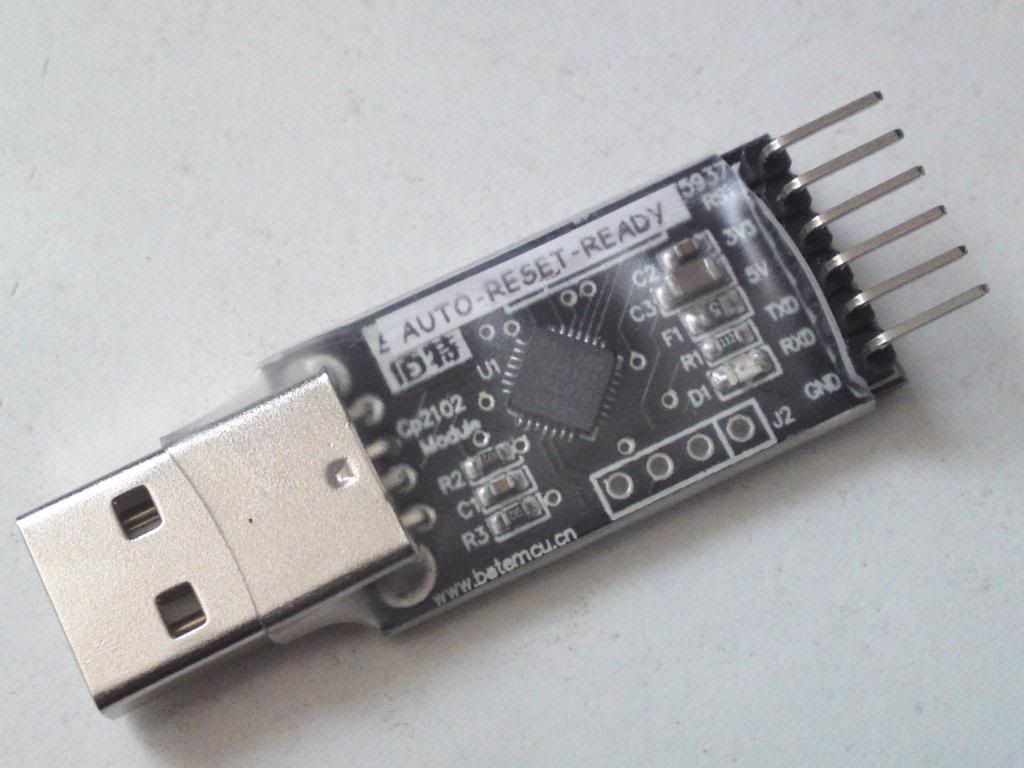

The CP2102
The one pictured has already been modified for Auto Sketch Uploading but this module is the easiest out of all these USB TTL to Serial Modules to modify for Automatic Sketch Uploading, my modules now come heatshrink protected (Only the Auto-Reset Modules !) and as always with most of my gear, instructions are provided where needed !
NOTE:
These DONT come configured for Auto-Reset as standard (i Configure and solder the SMD parts myself) and if you havent bought a specific "AUTO-RESET-ENABLED" CP2102 Module then you will need to make the modifications on this board yourself, and you must use a 0.1uF Capacitor on the Reset Pin of the microcontroller - all parts needed are always supplied as well as the instructions being emailed to you ;-)Look for the CP2102 Modification you need to do to the Standard CP2102 Module at the end of this guide before the "Troubleshooting" Section !
NOTE 2:
If your CP2102 Module DOES NOT have heatshrink on it (Recently Coming with Heatshrink as Standard now) then its not configured for Auto-Reset unless you bought an Auto-Reset-Enabled CP2102 Module !!!

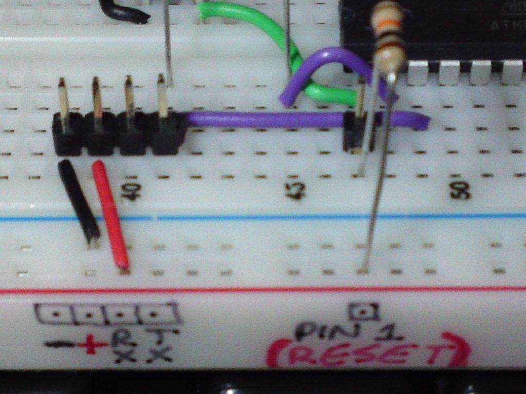

Okay check out the picture Below - i have written onto the side of my breadboard the Exact-Pin-Connections You will need to enable you to Upload Sketches and Connect up the USB Adapter (PL2302)!
The picture below shows the RESET PIN on the Breduino along with the -, +, RX & TX on the left on the breadboard !
Now look at the pictures Below on all 3 of the USB Modules, their pin connections are always used in the same way to connect to your Breduino, just be sure that you connect up the correct pins to the breadboard!
For the modified PL2303 module(middle photo) Observe the Pin Connections and look at the very top Pin (The Soldered Extra Pin in GOLD , above the 3V3 Pin) - That is the Reset Pin that will need to be connected to the RESET Pin on the Breduino!
Basically you connect the pins like-for-like as shown Below:

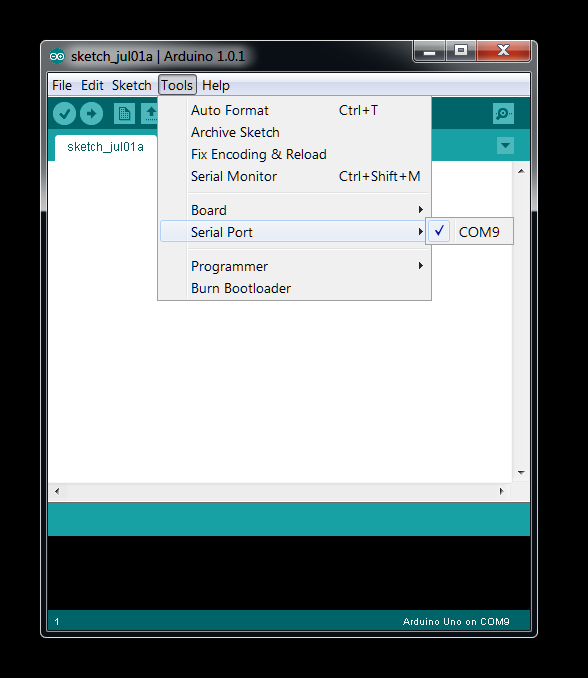

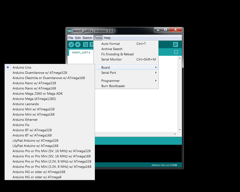

Firstly we must select the correct 'Board' in the Arduino IDE, Look at the picture Below (Picture 8) and make sure that Under:
Tools>Board>Arduino Uno is selected... (My Kits all have the Arduino UNO Bootloader & others bootloaded upon request!)
Now you must select the correct "COM" PORT so the Arduino IDE will know exactly where the PL2303 USB Module is and where to send the sketch so after opening up the Arduino IDE just look at the picture Below, my computer didnt have any 'COM' PORTS in-use until i inserted the USB Module so i did that just to show you that a COM PORT will show-up in the Arduino IDE and you must select it and make sure there is a 'TICK' next to the COM PORT number as shown, mine is COM9...
But if you do have a few COM PORTS in use, just simply disconnect all wires from the USB Module and insert it in a free USB Port on your computer and see what COM PORTS open up in the Arduino IDE, then disconnect the USB Module from your computer and when the COM PORT Disappears from the
Arduino IDE then you will have found the correct COM-PORT-Number that is assigned to your USB Module !

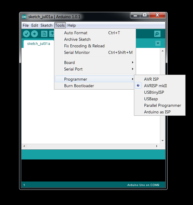

Next look at the picture Below and make sure that the 'Programmer' is set to AVRISP mkII - from what ive seen in the few short weeks of learning about the Arduino IDE Software is that this setting is already set to AVRISP mkII but just in case it isnt, no harm in checking !

Now look at the picture Below, this is the location you will find the 'Blink' Sketch - select this Sketch and another Arduino IDE Window will open-up as shown in the pictures below...
NOW CONNECT the USB Adapter to a free USB Port on your computer and just double check that all the settings you've just gone through are still all selected and everything's ok ! ! !
Then click on the 'Verify' button which is the 1st Circle Shaped-Button (Under 'File') and it has a 'TICK' on it, After its been Verified, Click the 'Upload' Button right next to the Verify button as shown in the pictures Below:
if you've connected it all correctly the Arduino IDE Software will go through the process of 'Compiling' the Sketch and as soon as thats done it will start Uploading to the ATMEGA328P-PU Microcontroller that is sitting on the Breadboard and all you need to do is Sit-Back and watch the magic happen WITHOUT Timing however many seconds it takes to "Manually press the RESET Button" to Upload Sketches because Any of my Modified PL2303 or CP2102 USB Adapters will "AUTOMATICALLY" reset the Breduino (& EVERY other Arduino/Arduino Compatible!) so that the Sketch will Upload Successfully EVERY-TIME you UPLOAD a Sketch !!!AND WITHOUT adding a 0.1uF {100nF} Capacitor to the Reset PIN of the ATMEGA328P-PU Microcontroller !)
As soon as it finishes uploading your Arduino IDE Should look Like the picture Below with the Pin 13 LED Blinking away !!!!

I Personally solder & Modify the PL2303 & CP2102 USB Modules in the Ebay Link at the Top of this page then finally encase the whole module in clear plastic, sand it with 3 different grades of sand paper ranging from Rough to Smooth then sand it again with smooth finishing with an expensive GLASSPAPER
(not sand paper) and finally polish it to a gleaming shine and i sell these on ebay fully made to take special advantage of the "Automatic Reset (Software Reset)" of the breadboard Arduino OR any other Arduino so all you need to do is simply press 'Upload' on the Arduino IDE Software and wait a few seconds until your sketch has uploaded without tediously and annoyingly failing to upload sketches "The Manual Way" by timing however many seconds it takes in order to press the Arduino Reset Switch and successfully uploading sketches!
I charge a reasonable price for all the work it takes to modify these modules and its alot of hard work as i dont have power tools and each module is crafted by hand so if your interested in one just visit my ebay page that has them being sold and not as expensive as any other Arduino USB TTL to Serial Converter & including postage & packing costs ! but so sorry, only selling to mainland UK at the moment folks so do apologize on that one!
How to Configure and Correctly Use the CP2102 Module
that was NOT Bought as an "AUTO-RESET-ENABLED"
module:
As these modules are ALL made in China, the designs for these modules are used for a great many other purposes (So i have seen online via google !) so to get them to work to send the all important Auto-Reset-Signal to Arduino Hardware is to use the DTR Pin NOT THE "RST" PIN as that will RESET THE USB MODULE !!! (BTW: For whatever reason the USB module needs to be reset like this is beyond me and i have no idea WHY the Chinese have designed this module like this in the 1st place !)
Okay So...... the Pin that sends the Auto-Reset-Signal to Arduino Hardware is called the 'DTR' pin, which stands for: DATA TERMINAL READY.
This USB Module is one of a very Very VERY Select Few, if not the ONLY ONE capable of modifying for our Arduino Uses with the least amount of soldering or SMD soldering !
This is where the All Important DTR pin is located on the USB Module and you can see from underneath the module that it says the 3 letters 'DTR' which can be better seen in the picture on the right, below (Above the pin named 'DSR')
And on the top side of the CP2102 module, the DTR Pin is the one with a box drawn around it near the tag "J3" as shown below:
The photo above-right shows where you will need to solder the supplied 1-Pin Male Header Pin to the DTR Pin of this USB Module to take advantage of the Autoreset Function of this module !
Once soldered, DO NOT USE THE RST PIN (ONLY THE BOUGHT AUTO-REST-ENABLED CP2102 Can make use of the RST PIN !)
Now here's how to connect:
1st Insert the Also Supplied 0.1uF Ceramic Disc Capacitor into two breadboard holes leading absolutely no-where lol:
Now link your newly soldered pin on the CP2102 module to the 1st Leg of this 0.1uF Capacitor, pictured below i am using a Blue wire to enter the hole of the 1st Leg of the 0.1uF capacitor:
And now Link the 2nd Leg of the 0.1uF capacitor to the RESET pin of the microcontroller as shown in the photo below (Another Blue wire, Lol !! ):
Now connect up your USB Module to the Breadboard Connections you made earlier and as mentioned earlier above for the STANDARD VERSION of the CP2102, here it is again:
(STANDARD VERSION)
CP2102: Breduino:
DTR PIN*** To RESET PIN *** VIA A 0.1uF Capacitor !!!

2. Check the RESET Pin on the microcontroller has a 10K pullup Resistor going to +5v Rail on the breadboard.
3. Check that there is also a 10K Pullup Resistor going from the RX Pin of the microcontroller to an empty pin hole not connected to anything on the breadboard (This empty pin hole is where the RX from the USB Module plugs into !!!).
