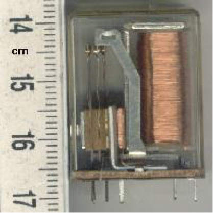

Hardware: We’re going to make a device with two power plugs, which can be independently controlled via the Internet. Due to the limited time available I am going to settle for encapsulation with focus on protecting the user from electric shock (I have never tried being that ‘done’ with a DIY project before ☺), rather than making something pleasing to the eye (this have absolutely nothing to do with the fact, that I suck at the visual design. NOTHING, I say!)
So a trip to the local hardware store to get a couple of power plugs, a trip to the Internet to fins a suitable box to contain the electronics.
I have a lot of drawers in my cellar-lab, and one of these drawers revealed a couple of 230V/10A relays. I probably need to make a driver circuit for the relays but this can be done with a couple of transistors and diodes (drawer#2). So far, so good.
If I wanted to make a commercial product, the BOM cost and the physical size of the device would be of importance, but since I lack time and don’t really care too much about the cost per device, I opt for a standard platform, which in terms of power and features is totally overkill – but a HUGE timer-saver.

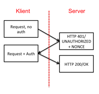

I choose to implement authentication ad standard http digest, which makes sure that the password is not sent in clear text. You could argue, that if using HTTPS further encryption of the password is not necessary. My reply would be https://xkcd.com/1354/.

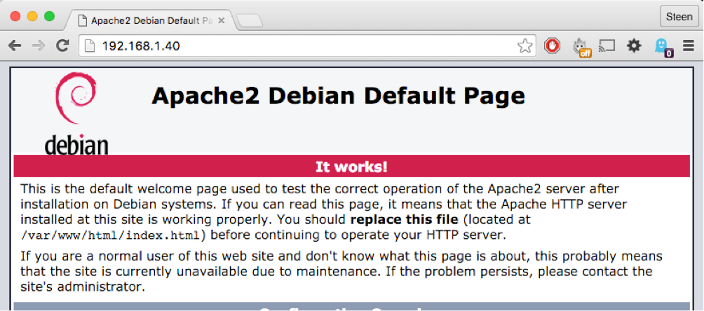

Let’s see if the Raspberry Pi now is reachable on http. In a browser type http://192.168.1.40, where 192.168.1.40 is swapped with the IP address of your Raspberry Pi..
Beautiful!

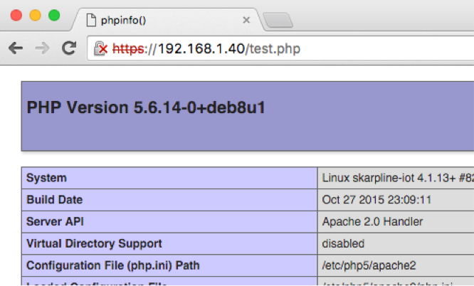

Now type http://192.168.1.40/test.php
We’re getting there, but we’re not done yet. Now enable SSL:
rpi_admin@skarpline-iot:/var/www/html $ sudo a2enmod ssl
rpi_admin@skarpline-iot:/var/www/html $ sudo service apache2 restart
rpi_admin@skarpline-iot:/var/www/html $ sudo a2ensite default-ssl
Now type https://192.168.1.40/test.php
Fantastic – now we’re talking! If this were hardware, now would be the time to lift your hands and slowly step away from the table.
Why the warning in the browser? It’s merely the browser telling you, that the certificate is not an official certificate and therefore not trusted. You will always get this error when accessing an IP address, since the certificate is bound to the FQDN (Fully Qualified Domain Name) of the site. In our case even using the FQDN you’d still get the error, since we’re using a locally signed (self signed) certificate.
If you get this kind of warning when using net banking, I recommend that you stop what you’re doing!
I choose to don’t care, since for our purpose it’s fine. A commercial product is of course another matter. You can get free certificates many places, e.g. here: : https://www.sslshopper.com/article-free-ssl-certi...
We accept the risk in the browser, and are now able to access the webpage via HTTPS:

A relay consist of a coil wound around a ferrite core, that create an electro magnet once a current is passed through the coil. The magnet attract a switch that closes the mains circuit.
Source: Wikipedia
The relay I picked from the drawer require 6 V/60 mA, so there is definitely a need to boost the output from the Raspberry Pi GPIO pins. First of all the voltage level on the GPIO is 3.3V, and secondly we’re unable to source that amount of current. A small test reveal that the relay is perfectly able to operate on 5V instead of 6V, which is fortunate, since 5 V is readily available on the Raspberry Pi.

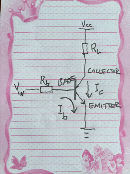

Luckily a driver circuit is really simple to design, using a standard NPB Bipolar Junction Transistor. A BC547 is perfectly suitable, since it can handle 0.5W without any cooling, and the relay will at the most draw 0.36W. We’ll use the transistor as a switch, and therefore we deliberately drive the transistor into saturation.
In short a transistor is a component with three terminals: Collector, Base and Emitter.
The clever thing about a transistor is, that a small current through base-emitter I_b can control a larger current through collector-emitter, I_c. The relation between I_b and I_c is called the gain, and for a BC547 it’s around 100. Therefore, if we need I_c to be 60 mA, we must pass at least 0.6 mA through I_b, and to make sure, let’s say 1.5 mA.
The base resistor R_b determine the current flowing through the base in accordance with Ohms law, U=R * I.
Output from the GPIO pin is 3.3V and the voltage drop across the base-emitter of a BC547 is around 900 mV, and hence the voltage across R_b will be 3.3-0.9=2.4V.
Thus we calculate the value of R_b as R_b = 2.4V /1.5mA = 1.6 kOhm. To allow for component tolerances, I select R_b = 1 kOhm.

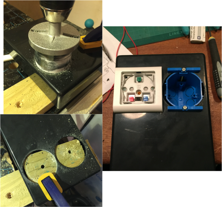

On my shopping spree I stumbled over a box for only $4 – a bargain! – and next step is to shoehorn all the stuff into this box, that admittedly is a teenyweeny bit too small. But $4! I had to have it! I take special precaution to isolate and fixate all wires and connections relating to the mains power in order to minimize the risk of electrical shock, short circuits and fire.
First thing is to decide where to put the electrical outlets on the front plate. I choose a location near the top of the box to maximize the available room inside the box for the electronic parts:
Now we can start fiddling wit all the parts to see how to best fit them inside the box. Primary, sizeable, components are: - The Raspberry Pi itself - The PCB with relay drivers - The two relays - A power supply for the Raspberry Pi

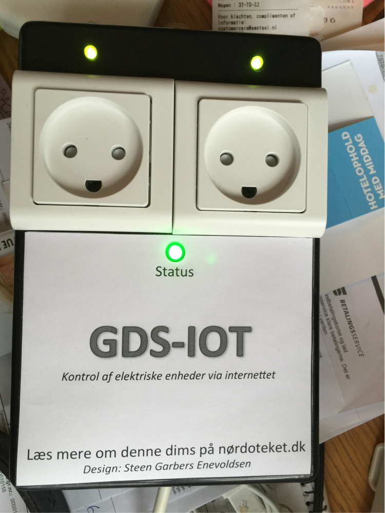

But the first thing to do is deal with the cliff-hanger from last article, and show the final product. This is the gizmo in all it’s glory:
Not the most sexy design, but hey! I am an engineer, and as such much more interested in functionality, than design. The most important requirement on the physical design is to prevent me from dying from electrical shock, and I’m alive, so job well done!
But how about those weird holes in the front plate? Well. Cough-cough… Those holes are a perfect textbook example of the consequences on being in a hurry and not thinking your actions through. It was on the wrong side of 11pm a Wednesday night, and I had set up a goal that I had to be done with mounting the Raspberry Pi in the box before going to bed. While trying a lot of different combinations, I found the optimal position, and thought “Yes!”, grabbed the power drill and drilled a couple of holes for the mounting screws. Then I realized what I’d done, and jumped directly to let last part of item#4 in the hardware step (swearing):
Luckily the damage is manageable, since I anyway planned to cover the lower part of the device with a small ‘commercial’:

The API is implemented as a webservice, and the first thing to do is to validate the user. This is done with HTTP Digest (RFC-2617), and therefore we begin by rejecting all requests our webserver that do not contain authentication information in the header. We reject by returning a “HTTP 401 / UNAUTHORIZED” header (https://httpstatuses.com/401), and add a unique value to the reply , called a nonce (a one-time term).

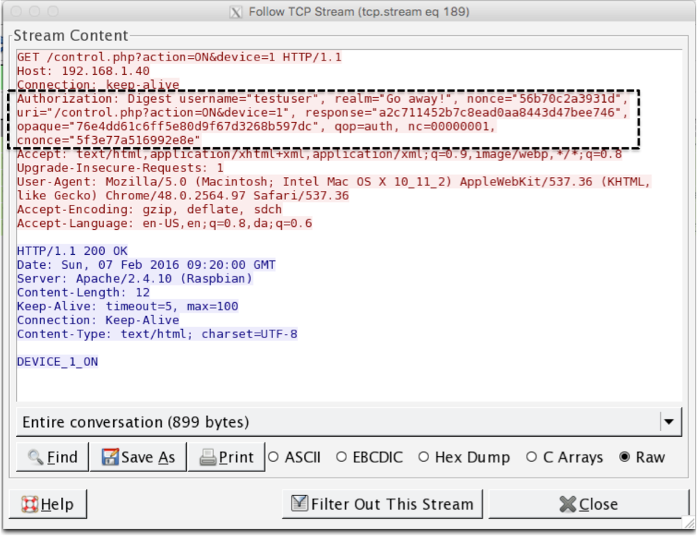

If we inspect the TCP traffic (Wireshark, if you haven’t tried it yet, please do. Fantastic tool!) the request/response look like this:
And in the code like this:
if (empty($_SERVER['PHP_AUTH_DIGEST'])) {
  header('HTTP/1.1 401 Unauthorized');
    header('WWW-Authenticate: Digest realm="'.$realm.
     '",qop="auth",nonce="'.uniqid().'",opaque="'.md5($realm).'"');
  die('UNAUTHORIZED');
$_SERVER is a reserved variable in php containing all the information in the request that is received (http://php.net/manual/en/reserved.variables.server.php).
Nonce is generated with php’s uniqid() function which generates a unique string, based on the time of the request (if you’d send the same nonce every time, you’d be vulnerable to playback attacks).
So how does it look, when a header with correct authorization information is received? We get the desired response, and a HTTP 200 / OK header:
This reply contain some information that I will need to explain. First we must make sure, that the client deliveres all the necessary data in the header. This is done by parsing the PHP_AUTH_DIGEST variable:
