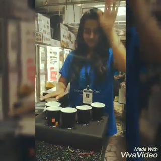

Ever wanted to build your own electronic musical instrument? In this Instructable, I walk through the build process for my Illumaphone, a light-based, spatial musical instrument that I built for Jeff Snyder's Computer Music class at Princeton. It consists of six coffee cups. Wave your hands over the air to trigger notes; light levels control volume and vibrato. Each cup represents a different note.

The sketch is set up to calibrate when you start it, so be sure to run the ChucK program while you're not standing over the cups. After you run the program, you should not hear any noise; you should be able to wave a hand over the cups to play them.
Once you have everything properly calibrated -- enjoy! I would love to see some videos of your performance. Try experimenting with different motions and techniques; you can even use a flashlight to play the cups, since they're sensitive to both light and shadow.
