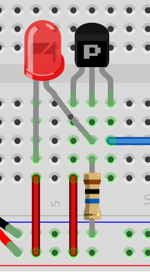

Step 4: Detecting Light
The first part is what this entire project was based on, the light detector itself. As stated, I used a 5mm red LED with a clear and colorless lens, reverse biased so that the cathode (the short leg, also indicated by the flat spot on the side of the LED) is connected to +9V and the anode (long leg) is connect to the base of Q1, a 3906 PNP BJT. (Check out my previous Instructable on BJT basics for more info.) The emitter of Q1 is connected to +9V, the collector is connected to the input of the op-amp (next step), and a 10MΩ pull-down resistor is connected between the base and GND.
Q1 is a BJT, or bi-polar junction transistor, and acts like a gate that opens up when a negative current is present on the gate pin. The problem is that the LED puts out VERY little positive current when exposed to a bright light, so the 10MΩ pull-down resistor is there to ensure that Q1 opens unless the LED is fully exposed to a strong light source. As long as the LED is exposed to a strong source, it has enough current output to override the pull-down resistor and keep Q1 from opening and sending a signal to the op-amp.
The LED will also put out a measurable voltage, somewhere around +1.5V. I could have used that to trigger the rest of the circuit, but I didn't want to. Hence using a current sensitive PNP BJT.
