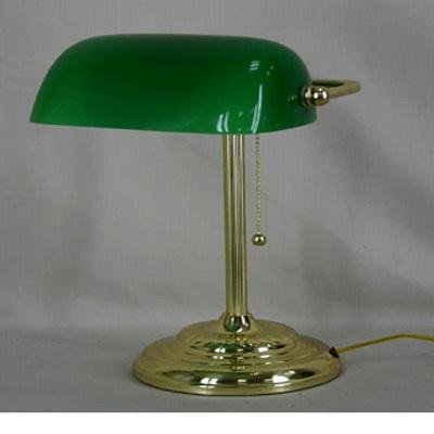

If I were clever, I would even figure a way to attach a light to that or the inside of the right end table, so the tracing window has a built-in light source--right now it's an upward-pointing table lamp. You *bet* it's from Ikea! :D I kinda want to install permanently some kind of desk lamp at the top edge of the desk, but that would suck if it blasts my eyes when the desk is in the flat position. Still working on that part.
