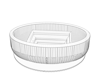

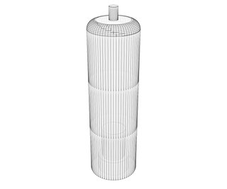

I designed all the CAD parts for my project. The stadium, which is one part, is what took me the most time to design; I am not overly familiar with 3D design, and it took me a while to get the stands correct. The rotating sign was quite simple to design. It is two parts, the post and the sign, which I constrained together with a peg on the post and a hole in the sign.
