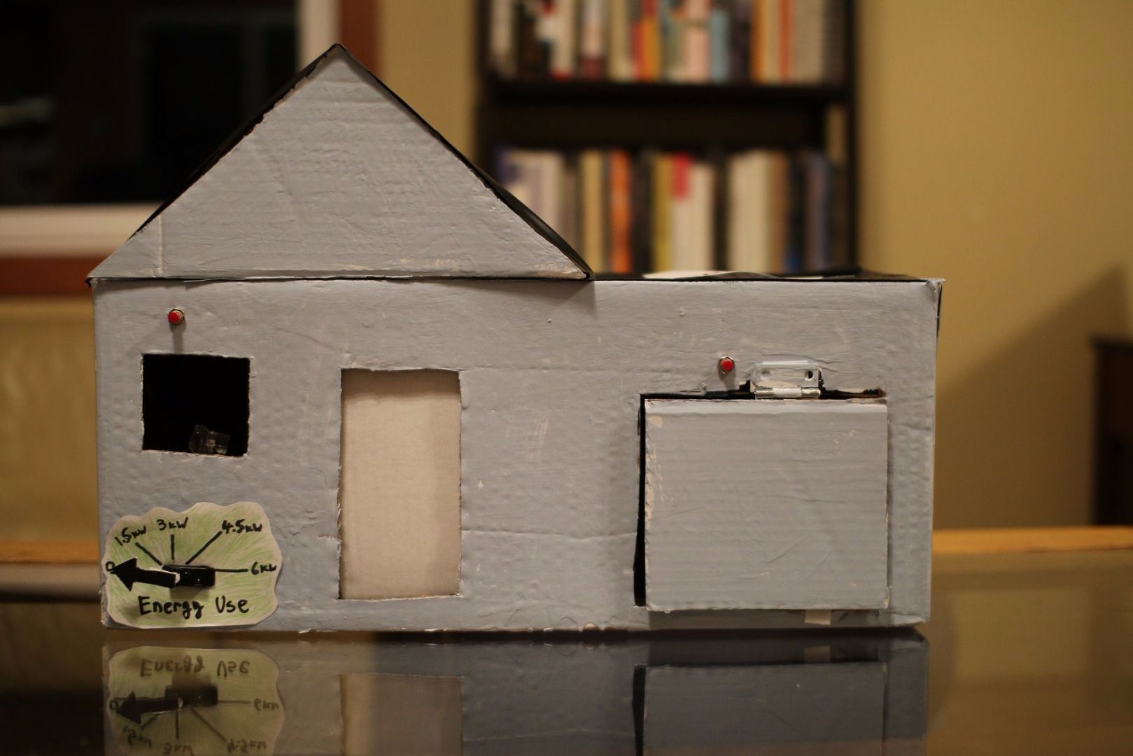

I don’t intend this step to be prescriptive. I’m pretty amature when it comes to arts and crafts, so I’ll just show how I built my model house. You’ll want to build it to resemble your own dwelling and reflect the things you care about. Lots of room for creativity here. Some of the components in this picture (like the current transformer) will be used in later steps.

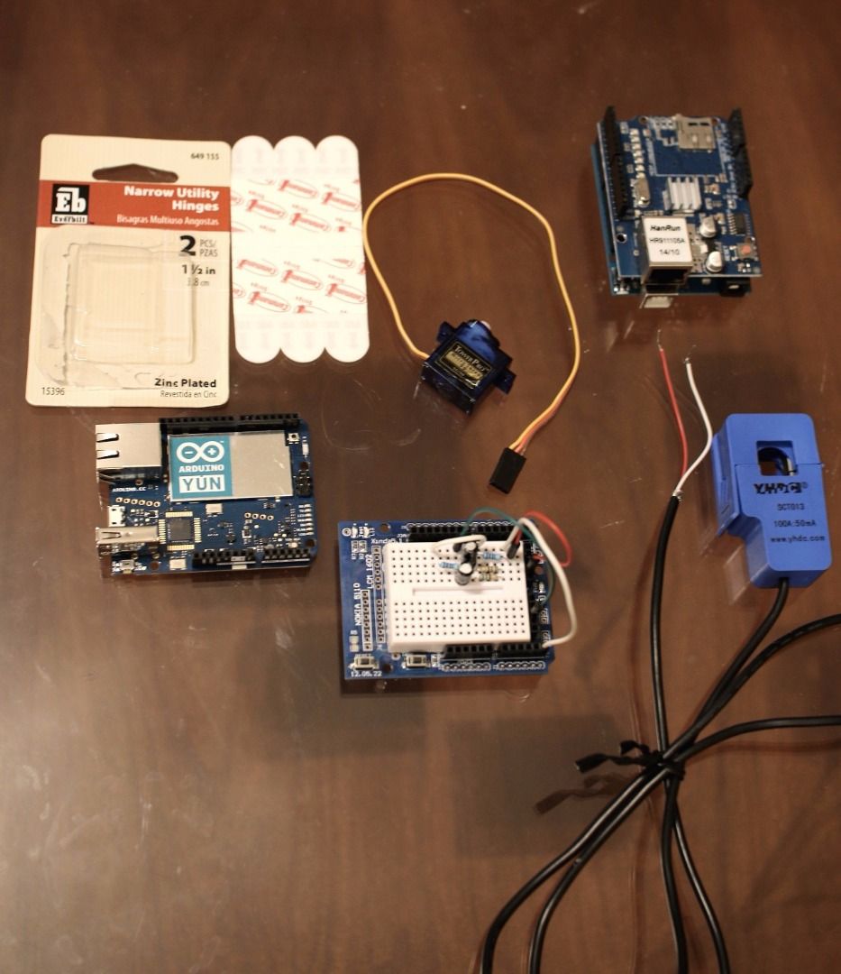

Components:

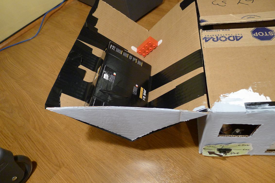

Roof

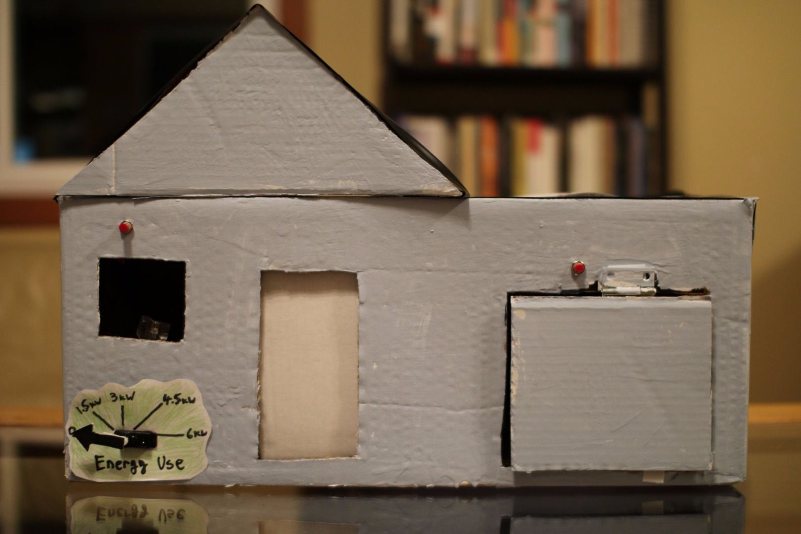

I cut out one of the side flaps of the box and attached it to the other (still attached) side flap to form a roof. I used a small box to provide a structure for the right angle, and later supported it better with a Lego piece. You can probably just use whatever you have around the house to make this right angle.

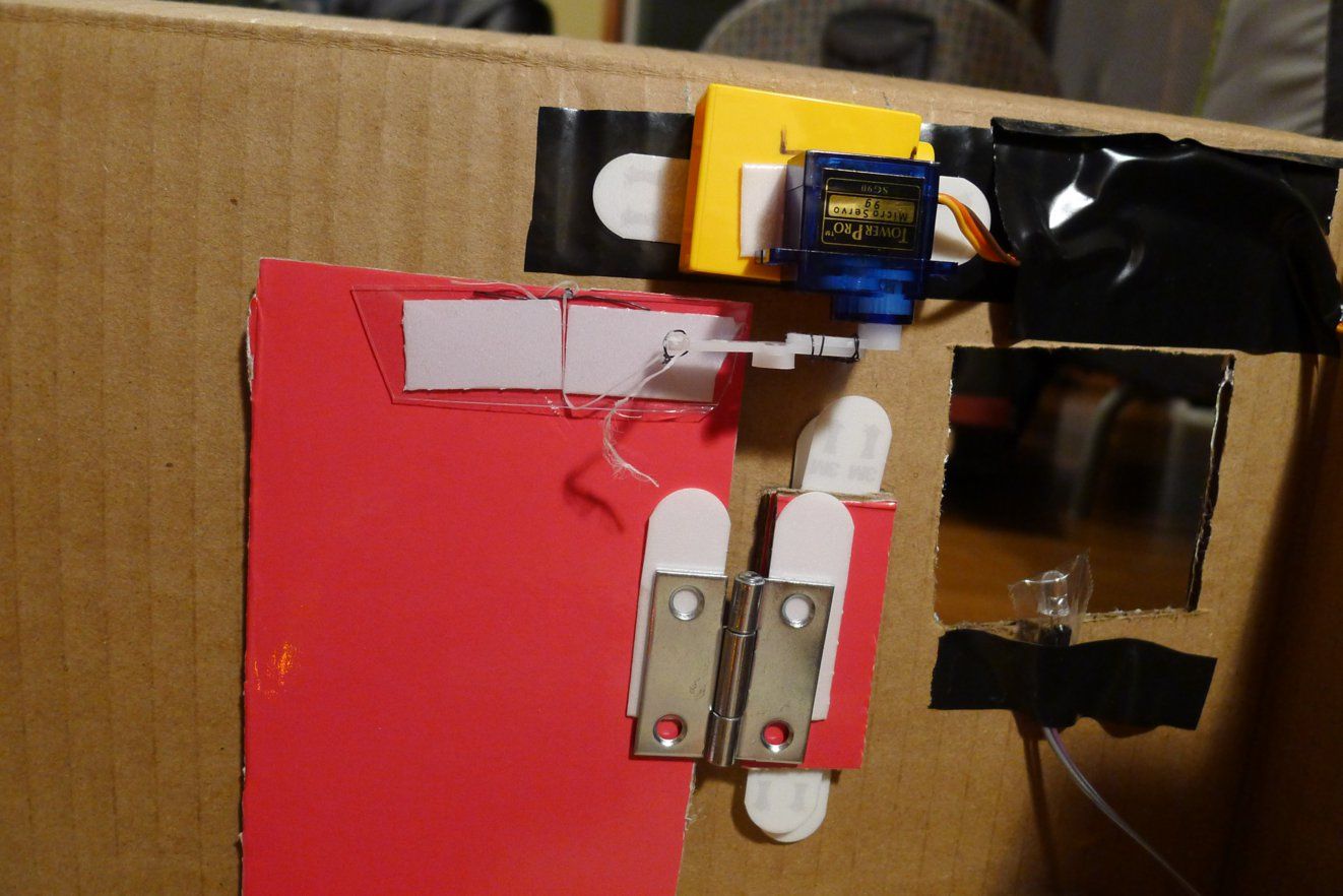

Doors / Windows

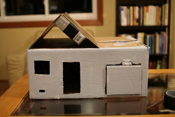

Cut the holes for doors that you want to show. Attach a hinge or two on the door with double stick tape and attach to the house. I know, nothing fancy, so feel free to improvise with what you got around the house. I used 3M double sided foam adhesives, the kind that comes with hooks. I also used these foam adhesive strips to mount the servo motors. For the garage door, the servo motor arm moves the garage door open, and gravity closes the garage door. For the front door, I needed to attach a string on the hinged door so the servo arm can open the door. The yellow Lego piece you see is there to offset the servo from the hinge.

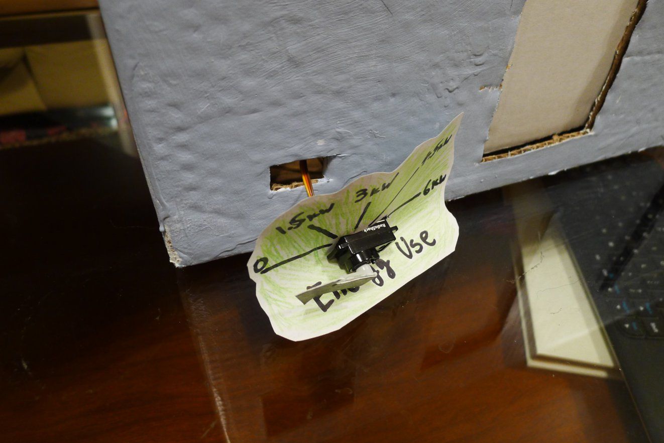

Energy Meter
Nothing fancy. Just cut out an arrow-looking thing and attach it to the servo arm. Cut out a vaguely shrub looking shape and mark it up with a kilowatt scale, and friction fit the servo motor onto the box with the shrub in between.
Above the energy consumption servo, I taped a red LED.

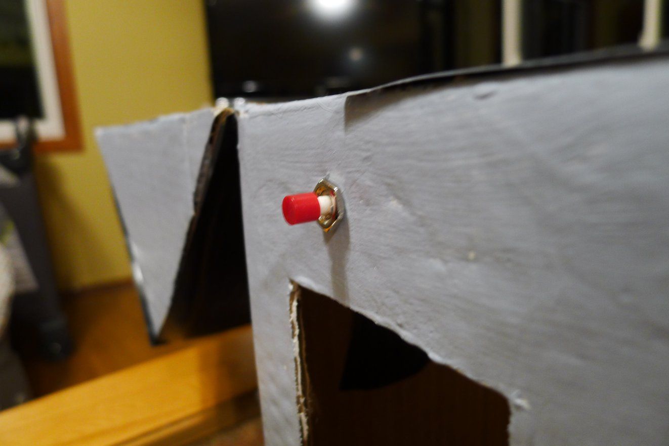

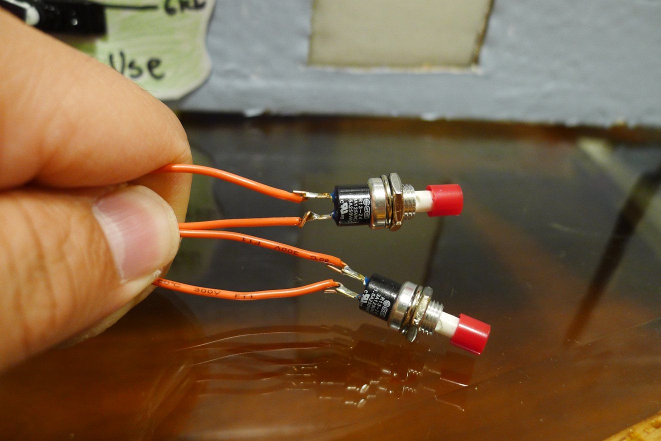

I also have two buttons to control lights and the garage door. These are momentary buttons. The buttons are threaded with a nut on the outside to hold it against the cardboard box wall. On the other side are the metal contacts for wires to be soldered on to.

You can use what you're comfortable with and what you have on hand. A less expensive ($20) option is to use an Arduino Uno clone and ethernet shield. I started with that, but that tethered me to the ethernet cable. So I switched it to an Arduino Yun ($65). Much more expensive, but also gave me the freedom to use wifi. The Yun was really easy to use. You basically:

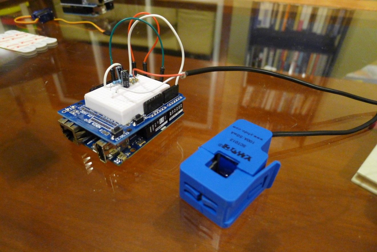

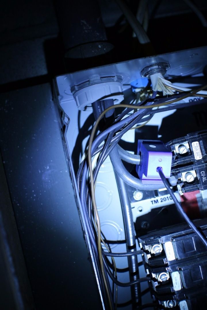

Now that we have a physical interface capable of displaying the energy usage, we need to build a sensor node to read the energy consumption of the house and publish that consumption to the MQTT broker. There's a couple ways to do this. I'm using an Arduino Yun. It's the least complicated method, but not the least expensive. If you want, you can use an Arduino Uno, ethernet shield, and a wireless router to act as a wifi bridge. Or you can use a Pi with the Open Energy Monitor package. I'll just cover the Yun method.
I'm using a $7 current transformer from ebay. You can find the 100A version of the Yhdc SCT-013-000 here . Wire it up according to the wiring diagram above, and upload the Arduino Yun sketch at the bottom of this step. Be sure to modify the code with your MQTT broker IP address. This page for the Open Energy Monitor library is a good reference. Here's the ideal component values.
  • Burden Resistor = 33 ohm
  • Voltage Divider Resistor = 10k ohm
  • Capacitor = 10uF
The picture of my energy monitor doesn't really match the circuit diagram because I didn't have those exact components on hand. I had to use two 68 ohm resistor in parallel because I didn't have the 33 ohm burden resistor. And I didn't have a 10uF capacitor for the rectifier circuit, so I used two 22uF capacitors instead. The series equivalent capacitance is close enough.
Attach the current transformer on one of the incoming phases of your house. I only had a single 100A transformer, so I'm only monitoring one of the phases. Eventually, I'd like to get more transformers to monitor the other leg of the incoming power and also the branch circuits. Using an actual amp meter, my DIY setup always read 1 amp above the amp meter across different amp readings (see 5th image above). Pretty simple matter to just subtract that extra amp.

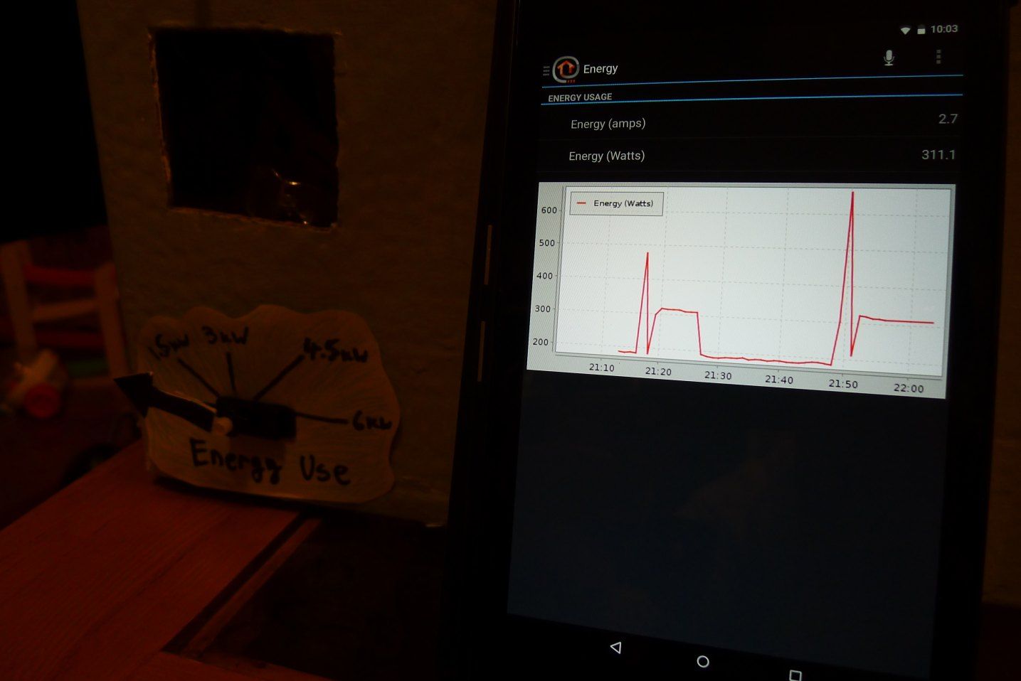

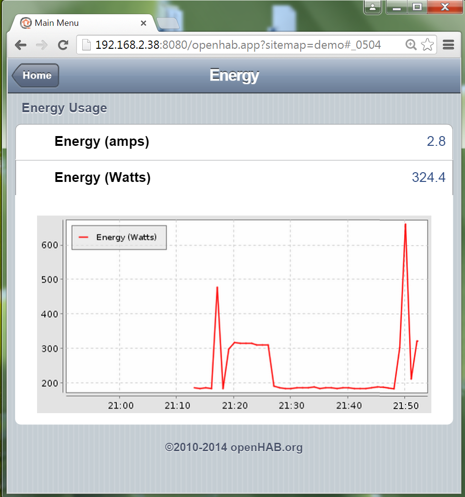

OpenHAB
Since we have the data coming in, we might as well also display it on OpenHAB so the data can be graphed. Here's the relevant OpenHAB configuration.
Item Definition
<p>Number itm_smarthome_energy_amps "Energy (amps) [%.1f]" {mqtt="<[mymosquitto:2853:state:default]"}</p><p>Number itm_smarthome_energy_watts "Energy (Watts) [%.1f]"  {mqtt="<[mymosquitto:2852:state:default]"}</p>
Sitemap
<p>Text label="Energy" icon="firstfloor"<br>{</p><p>	Frame label="Energy Usage"
		Text item=itm_smarthome_energy_amps</p><p>		Text item=itm_smarthome_energy_watts</p><p>		Chart item=itm_smarthome_energy_watts period=h refresh=5000
	} //Frame energy usage</p><p>}//Text label="Energy"</p>
Persistence
Since we're using charts, we need to define some kind of persistence strategy for the energy use. RRD4J is easiest to use, so here's what I have for "/openhab/configurations/persistence/rrd4j.persist".

Energy Monitor Screen

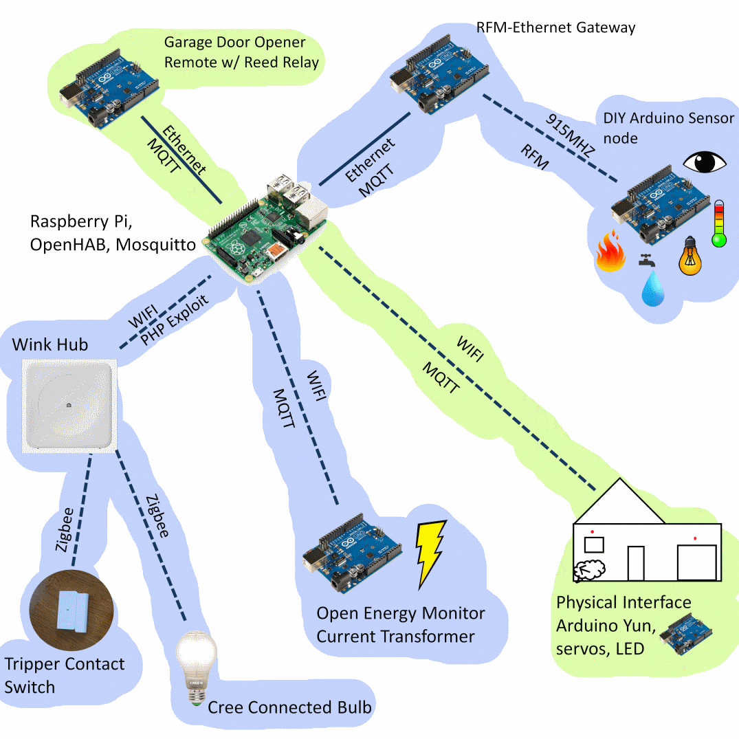

In one of my previous projects I used a $5 wireless transceiver to send sensor data over a MQTT gateway. I'm still using this project to get the garage door status to OpenHAB, and in the demo video, that's actually how the model house's garage door reflects my actual garage door status. The detailed code and circuit can be found in this step if you want to use it. It's kind of ugly, but it's in the garage where no one will likely notice.
There is also a light sensor that I'm using to indicate whether a light has been left on. This is also from that previous Instructable detailed in this step. It's part of the Uber sensor that uses a photo resistor to send brightness information wirelessly back to OpenHAB. In this case, I'm simply subscribing to the MQTT topic that indicates light level.
I've also made a battery powered reed switch sensor that uses the same wireless transceiver and gateway in that previous Instructable. However, it's not very good looking. I can't really use it on an interior door or window for aesthetic reasons. So, to over come this problem, I'm using nicer looking consumer-grade reed switch sensors from Wink. Which leads us to the next step.

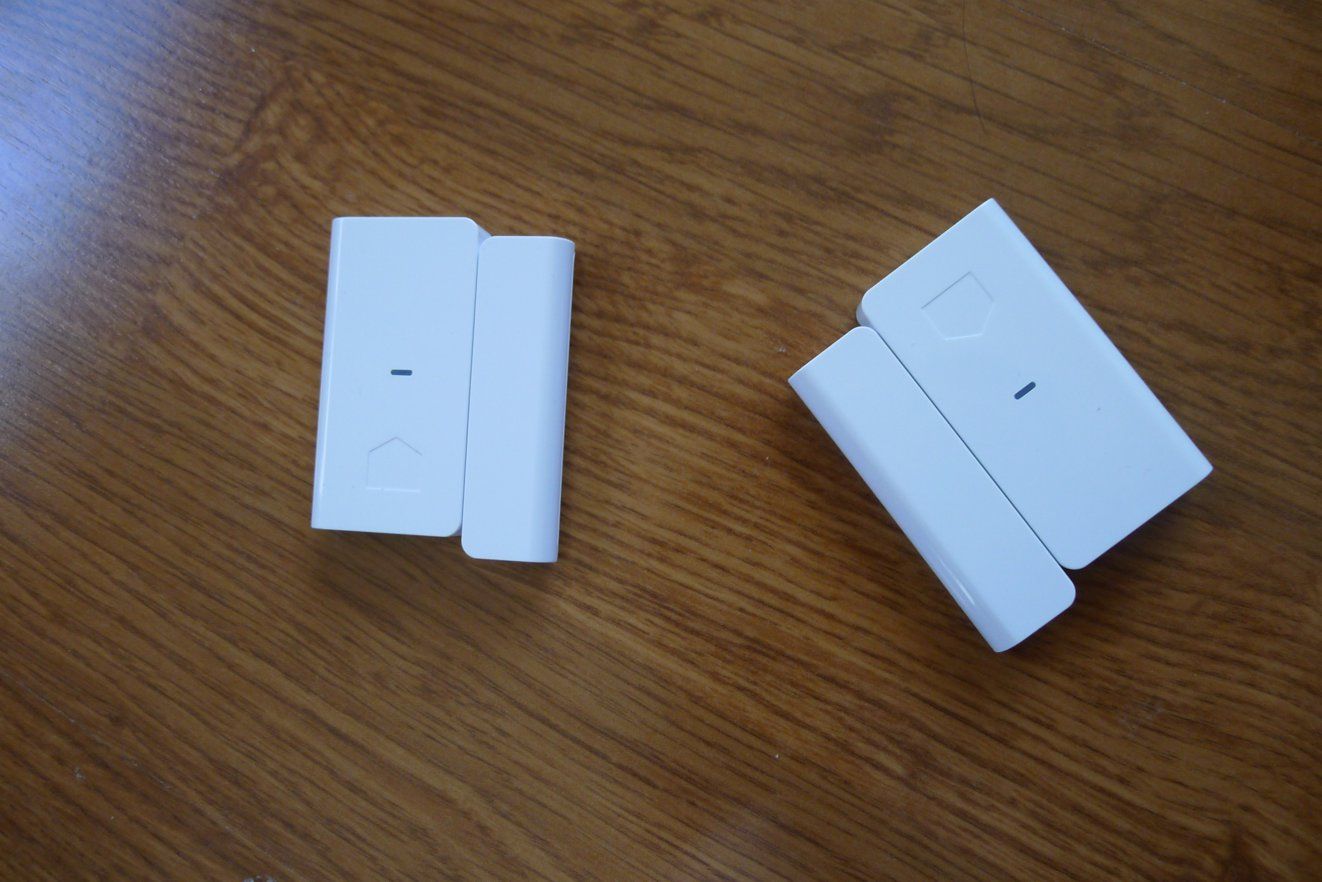

Step 5: Sensor: Wink Hub
I happened on this blog post from an early Wink Hub user who found a way to root the hub to gain access to a PHP exploit. This exploit allows you to run an "aprontest" utility to control things that have been paired with the Wink Hub. Using this method, I've been able to control lights from the OpenHAB interface.
The most interesting benefit to rooting the Wink Hub is that it gives you local control over lights and sensor status without having to access the Wink server. The Wink Hub and Wink API always needs to go to the internet to contact the Wink server to do lighting control or get sensor status. Now, with this PHP exploit, lighting and sensor operations can be kept to your local LAN. That's great.
I've included a PHP script at the bottom of this step. If you can't open this file, try this link. This script runs on the Raspberry Pi and polls the Wink Hub for the status of two Wink Tripper reed switches. This status is sent to OpenHAB via the REST API. OpenHAB will then publish MQTT topics for these door positions. The controller for the model house then opens or closes the doors by subscribing to these door position topics.
The three OpenHAB configuration files (items, sitemap, and rules) attached in this step are needed to make everything work. They define the contact items that the polling script interacts with via the REST interface. There's also an example script for controlling zigbee light bulb via OpenHAB.
