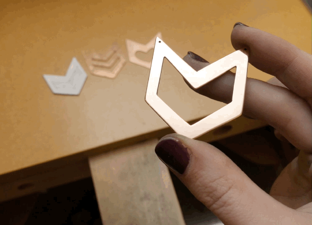

This lesson introduces the tools and techniques you'll need to create finished jewelry from precious sheet metal! We'll walk through the steps to create a chevron pendant (or keychain) from copper (or sterling silver, etc. if that is your preference) by sawing, filing, sanding, and polishing the metal before attaching jump rings to a necklace chain or key ring.

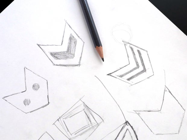

Although I've included a printable template for the cutout chevron shown in this project, I encourage you to draw and use your own designs! Use graph paper to create symmetrical designs. Sharpen up your straight lines with a ruler, and cut your pattern out with a bit of space around the outer edge. Use a glue stick to thoroughly coat the back of the pattern all the way to the edges (do this on a scrap piece of paper to catch excess glue), then firmly press the pattern to the sheet metal and smooth down the edges.

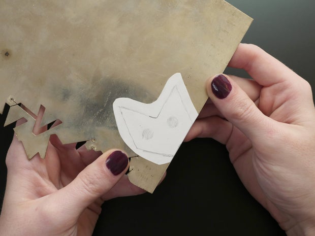

But why cut all the way around a single shape? That'll take forever! You can be economical about your cuts by placing the pattern edge along the factory edge of your sheet metal, and tiling similar pieces closely to cut the edges of two pieces at the same time. Let the glue dry for at least a few minutes before proceeding to the next step.

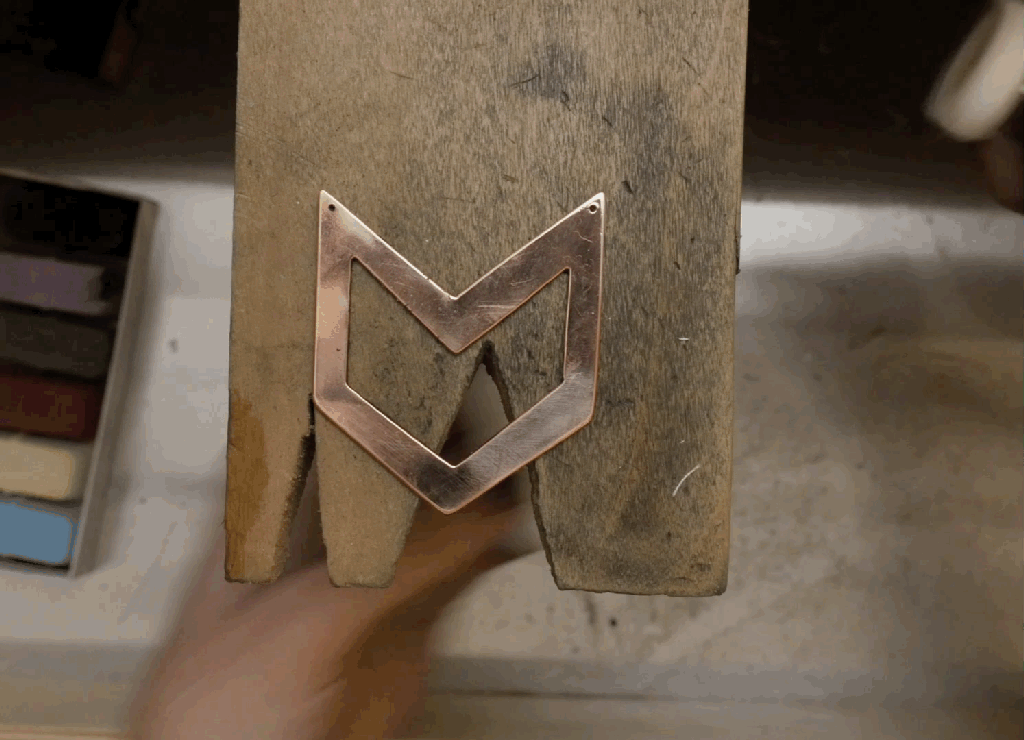

Set up your sheet metal with its glued-on template on your bench pin. This sturdy bit of wood with a V-cut is extremely helpful for piercing sheet metal, as it supports the metal on both sides of a cut.

After the initial notch has been cut, focus more on moving the blade straight up and down along the edge of the pattern line, and don't worry about applying too much forward pressure. Use smooth whole-arm motions and keep your wrist straight. The blade will do its job and nibble away bits of metal with each downward stroke.
At first, it may be difficult to achieve a straight line, and that's perfectly normal! Try to err on the outside of the pattern lines, and you can always clean it up later with a file. Use a bench brush to sweep away shavings when they start to obscure your cut line.
It's also normal to break saw blades (occasionally, more if you're a beginner). You are wearing eye protection, right? Sometimes you can remount the shorter remaining piece and use it for a bit more sawing. When securing blades after breaking one, watch out for broken blade bits in the thumbscrew areas of your saw, as they can prevent the clamp from fully grabbing the new blade.
Practice with outer perimeter cuts before advancing to cutting tiled pieces apart, where there is less room for error because both sides of the cut are used.
To create sharp points on your chevron, begin cuts at each outer edge and cut toward the middle. For the most part, try to cut in a straight line away from you, and adjust the angle of the metal, rather than vice versa. When it comes time to round a corner, gently spin the handle of the saw while moving the blade up and down, then stop to reposition the metal and saw to cut in the new direction.
Step 3: Interior Cutouts
To cut out interior shapes, first you'll create a divot in the metal with a center punch and carpenter's hammer. Drill bits tend to skate on smooth surfaces, so it's necessary to create a divot to get the drill bit started. The divot will serve to host a drill bit, which will clear the way for inserting a saw blade. Use a carpenter's hammer over a polished finishing hammer with steel tools; otherwise you'll scratch up the surface of your smooth hammer, and those scratches will transfer to other work later! It's best to punch your metal on a smooth surface like a bench block. On softer surfaces like wood, the punched metal may deform on the underside (and poke a hole in the surface as well).
Position the point of the center punch somewhere inside the metal to be cut away (closer to the middle than near the edge - this gives you room to maneuver your saw inside the area to be removed), and hold the tool straight up and down. Strike the tool with a single firm blow from your hammer. Repeat for additional cutouts, if any.
Set up your rotary tool or standard hand drill with a tiny (2mm or slightly smaller) drill bit. Draw your stick of bur lubricant along the drill bit, then place the drill bit against the divot and brace the metal before turning on the power. As the drill bit spins, apply gentle downward pressure until the bit pierces through, then remove and power down the tool.
Grab your saw frame and secure the blade near the handle, but not at the other end. Thread the saw blade through the hole you drilled in the metal before securing and tensioning the blade in the frame. Now you can begin cutting (don't forget the bur lubricant) from inside the area to be removed to cut out the void.

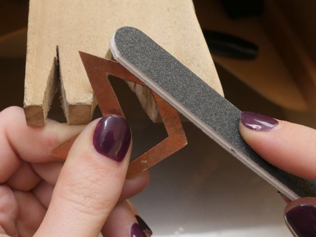

Once you've finished cutting out your shape, it's time to clean up the edges with a set of needle files. Most files are hardened steel with a tooth pattern cut into them, but when you’re shopping you might also see files covered in diamond grit. Reserve your files for use on soft metals only, as filing steel will quickly dull the teeth and reduce their effectiveness. These files cut on the push stroke, so you should only apply downward pressure on the file when pushing it away from you, and release the pressure for the pull stroke. Use the different areas of your bench pin to brace the metal for filing, and try to avoid positions that brace the metal against your hand.
Files come in different shapes to allow you to get into tight spots or file curved shapes. For instance, to file the interior edges of the chevron that extend into a tight corner, use a shallow triangular flat file.
To perform uniform strokes across narrow edges, hold the file diagonally to the work and push it across the metal from tip to base as you glide the file along the length of the edge. Continue filing until all edges are flat, even, and perpendicular to the workpiece.

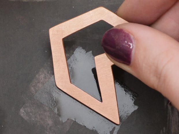

To refine the surface of your metal, you'll use sandpaper across a gradient of grits from (relatively) coarse to fine. Most hardware stores carry sheets of wet-dry sandpaper; pick up a sheet each of 400, 600, and 800 grit. You can tape sandpaper to a flat surface to create a mini sanding board, and get sanding boards that work like nail files. If you don't plan to polish your projects with a rotary tool, you can achieve a very respectable lustrous surface by finishing with some superfine sanding pads. Keep your dust mask on when sanding.
Sand the filed edges, starting with a coarse grit (200-400). Either rub the metal across the stationary sandpaper, or vice versa (or a combination thereof) until the surface is uniform. You may expose some areas that require touching up with a file. Don't ignore these spots, as sanding is a one-way process! If you rough up an area with a file, you'll have to start again with the coarsest sandpaper and work your way finer, so you might as well get that all out of the way now.
Now's also the time to decide what this workpiece will become, if you haven't already. To make a pendant, punch and drill two small holes near the upper points of the chevron. To create a keychain, create just one hole, but make it a bit larger. File away any burs left from drilling and resume the beginning of the sanding process.
Use the sandpaper to gently round the edges and sharp corners of your workpiece, then rub the piece on a flat sheet of sandpaper to sand each broad surface.
Repeat the sanding process over the whole workpiece with 600 grit sandpaper, then with 800 grit. Each time, evaluate the piece for scratches bigger than that grit can remove, and backtrack to a coarser grit if necessary to remove all scratches.
