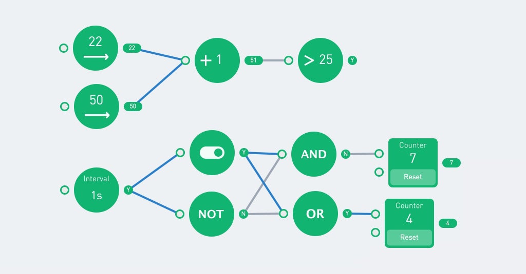

Logic and Math
These are basic functions. And have one or two inputs and one output value. There are several simple calculations and comparisons.
Instructable Robot
The toggle function switches it's state each time it receives a 'Y'.

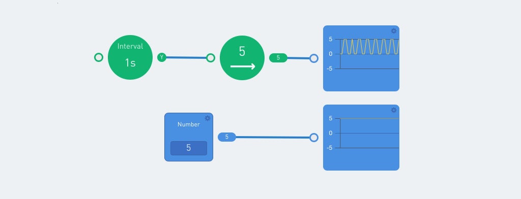

Numbers
There are two number nodes, one "basic" and one "controls" version (they are on different tabs). The controls version is a fixed number, while the basic number has an 'on' and 'off' state. The following example shows the difference. The interval switches on ('Y') and off ('N') each second. The output of the green number is 5 when the input is 'Y', else the value is 0.
Instructable Robot
The curve node shows a graph. That is useful to show the different output values. Other useful indicators are the label and indicator node.

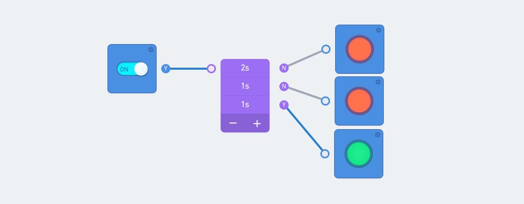

Sequence
The sequence runs repeated or only once when the input is 'Y'. This allows for a sequence of actions.
Instructable Robot
The sequence gets a signal when the switch is turned on. The output of the sequence is passed to an indicator.
Note the color of the lines: The blue lines indicate the current flow. And the circle to the right of a node always shows the current output.

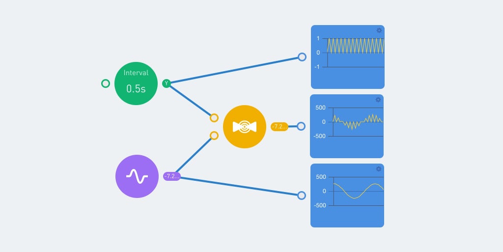

Valve
This is an node which passes the lower input value if the upper input value is true. This is best explained with an example:
Instructable Robot
The green interval node switches between 0 and 1 each half second. The ouput of this node is visilbe on the uppper graph. The purple pulse node gives a sinus output, with values between -255 and 255. This is shown on the lower graph.
Both the interval and sinus are input for the valve node. And the output value is 0 when the interval value is 'N'. When the interval value is 'Y', the output value equals the sinus input value. This gives the middle graph.

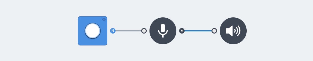

In addition to the camera, a microphone / speaker Neuron can be connected to the WiFi block. This can be used to record and playback audio fragments. Connecting this Neuron gives an additional "sound" tab in the App.
The record node will only record sound if the input is "Y', this requires a button or switch. The recorded audio fragment is the output of the record node. Adding the "play sound" node immediate plays this output. This can be used to make a parrot:
Instructable Robot

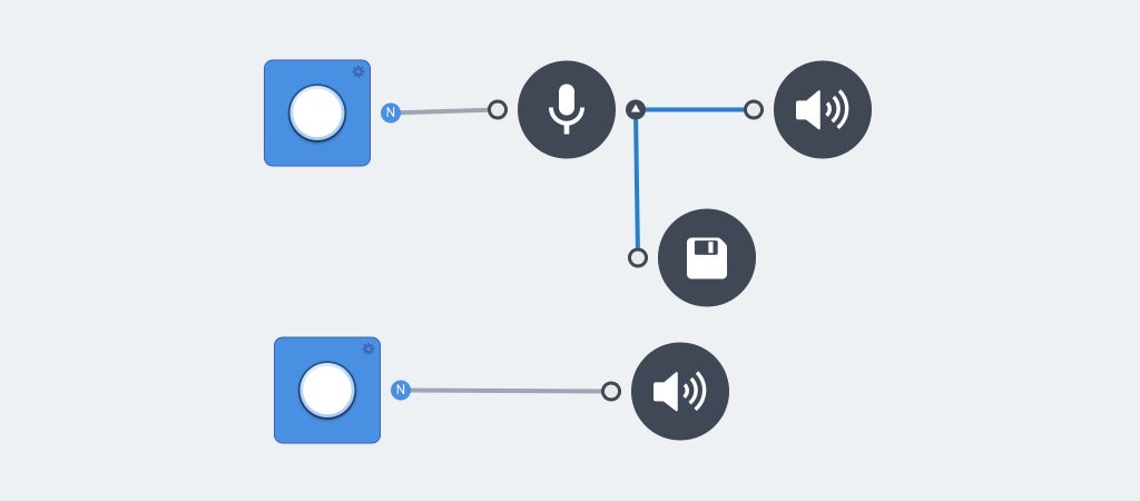

Clicking on the microphone node gives 2 options: "voice to text" and "save record".
The "save record" node saves the audio file on the filesystem inside the WiFi Block. This file is overwritten each time a new recording starts.
The "Play sound" node is capable of playing input audio, but it's also posible to select a sound effect or recorded file. It requires an input trigger to start the given sound. And it stops immediate when the input is 'N' (false). The following example is a kind of dictaphone. The upper button makes a recording and the lower button plays this recording.
Instructable Robot
The voice to tekst option of the microphone node uses Microsoft cognitive services to translate the recording to text. The label node is capable of displaying the output. The record and play sound nodes aren't required to translate voice into text. But these are useful during programming to check the output.
Instructable Robot

The tail uses a pulse node between -180 and 180. An ABS function makes the negative value positive. This value is passed to the servo motor, and the tail starts wagging.
By combining the neuron blocks and the function nodes it is possible to write more complex programs. The speed of the tail can depend on the speed of the robot or the robot could stop if the ultrasonic sensor measures less than 30 cm.
