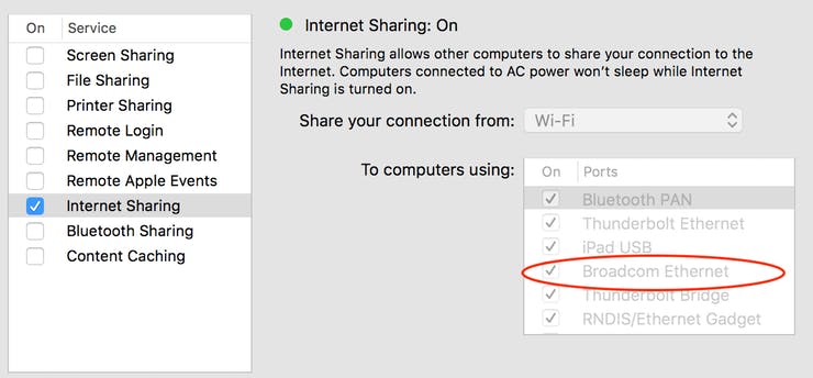

  • Connect USB Cable between your RasPi Zero and your computer.
  • Either use a Mac or install Bonjour to SSH to your RasPi Zero: ssh pi@raspberrypi.local
  • Password is raspberry
  • Finally setup internet sharing on your computer allowing Broadcom Ethernet to connect to your WiFi via your computer.
