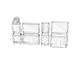

Many useful applications for the cheap processing power and sensors we have today are limited by the short duration of use provided by our batteries. To solve this, slim LiPo battery modules were made that attach to a user’s belt with a simple clip on the back. Each module contains a LiPo cell, LiPo protection circuit (PCM), and magnetic power terminals to allow them to be easily snapped into chains to provide more power. These power modules are linked in parallel to a control module that contains a step-up regulator with integrated USB to allow it to charge a phone or other devices, power terminals for powering loads with non-standard connections, an internal LiPo charger with micro-USB connection for convenient charging individually or as a chain.

We designed a whole wearable system that connects LiPo batteries in parallel with other wearable modules in order to power them. The modules consist of a charging/discharging module that is capable of charging external devices through USB or direct connection to output terminals, as well as allowing the battery modules to be charged with a micro-USB cable. Another module consists of an Arduino Micro Pro that serves as a computing module capable of powering all sorts of wearable computing projects. The final module allows a breadboard to easily be combined with the system, enabling rapid prototyping of wearable projects.
The DXG and STI files from AutoCAD can be downloaded from this page. These are free for personal use, but please no commercial use without permission!
We had access to a high print quality 3D printer called the Objet, but any 3D printer with at least a .5mm resolution that can also print over-hangs should be able to do an adequate job.
If you do not have access to a 3D printer, easy power systems using a 9V battery and linear or switching regulator (to lower 9V to 5V) can be used to power the Arduino, laser, and gyroscope units. In fact Arduino's often have an on-board regulator that lowers voltages as high as 12v down to the Arduino's operating voltage of 5V. In this case the 9V battery should be attached directly to a pin that's usually labeled RAW. Make sure to check the capabilities of your individual Arduino, so that you don't accidentally supply too much power and fry it.
