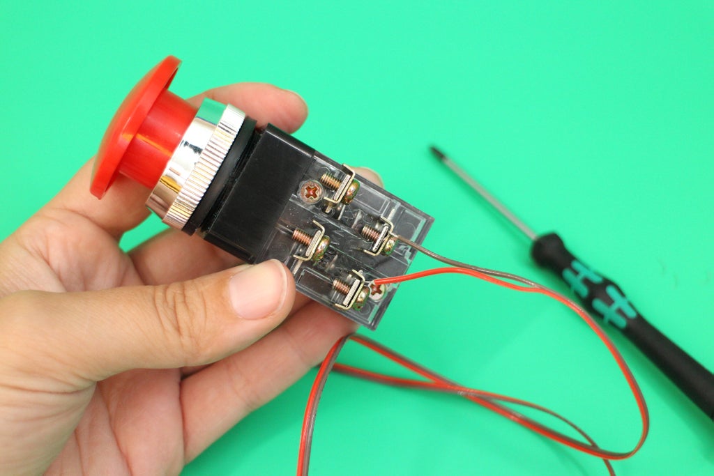

To build the final circuit for the photo booth, it needs to be moved from the breadboard. The circuit used is the same one you built in the earlier lesson GPIOs + More Python: one switch and two LEDs. Reconnect the components using either an EzConnect board (terminal blocks) or a soldering iron. You can learn to solder in Randy's Instructables Electronics Class. However, you can also twist wires together and use electrical tape to get the circuit working if that's all you have on hand.
To wire up to the large arcade-style button used in this photo booth, unscrew the terminals on the switch and connect two wires stripped off of the ribbon. The female headers on the end of the jumper cables slip over the pins on the RPi. To extend the length of these wires, cut the opposite end off, strip and twist around the end of some ribbon wire.
You can plug the components right onto the RPi or you can screw them into the EZ-Connect shield if you purchased one.

Except for the screen (which has a little clamp to sit in), I mounted everything using industrial strength double-stick tape and hot glue. Make sure the camera lens is close to the surface it's behind. Otherwise, the edge of the hole will be seen around the image. I shaved off the back where the camera is mounted to remedy the situation.
To mount the switch, unscrew the red pushbutton mechanism and silver ring. To diffuse the LEDs, a ping-pong ball was cut in half and centered around each LED hole with the help of two laser-cut rings.
