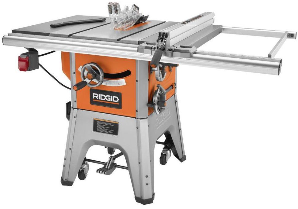

    RIDGID R4512 (~$550)
    13 amp motor @ 3450 RPM
    BenefitsLimitations
    • Standard 10" blade
    • 3 ¼" cut depth @ 90°
    • Large work surface (20" x 27")
    • Very flat cast iron top
    • Better build quality
    • Better precision in cuts
    • 30" rip capacity
    • Mobile base
    • Higher cost
    • 4" dust collection port
