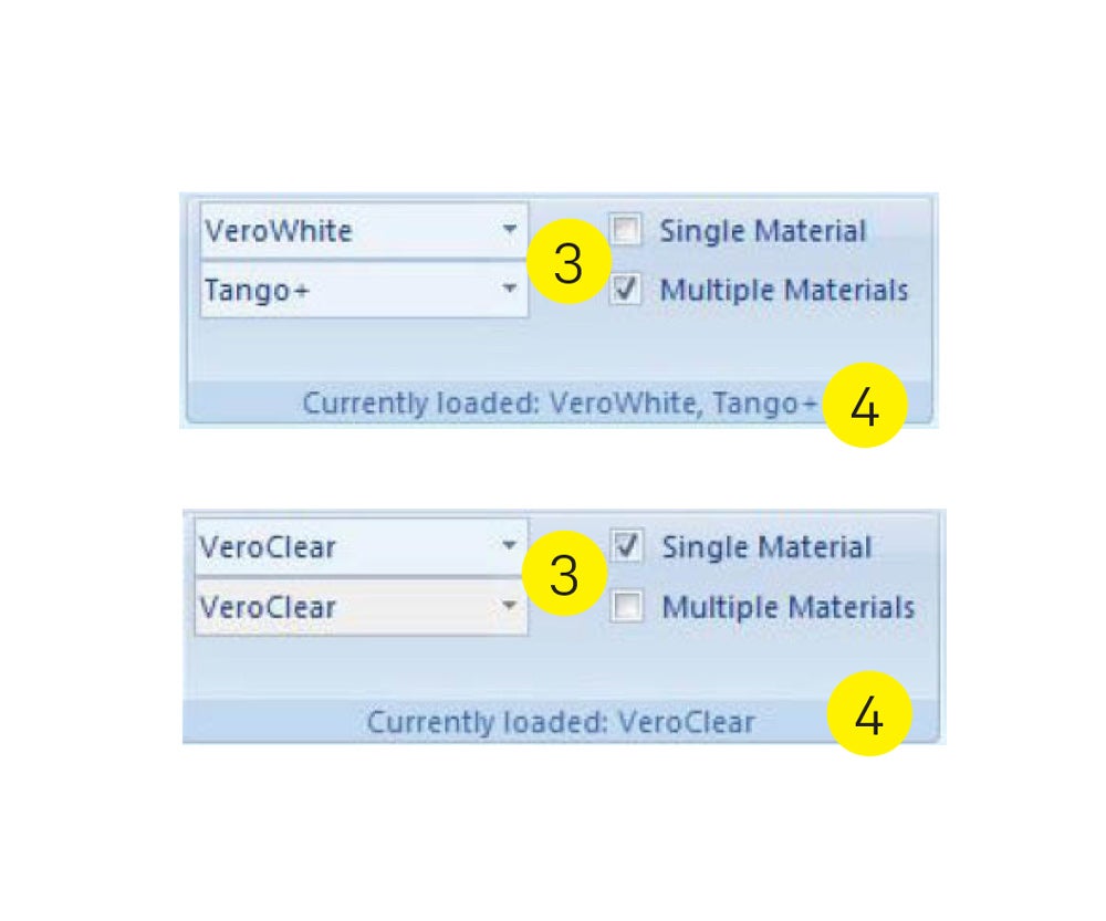

Step 3: Tray Setup
SET TRAY AND MATERIAL OPTIONS
Confirm that the materials loaded in the printer are accurately listed in the software.
  1. Click the Tray Settings tab. This ensures that the Model tab will display the correct materials available.
    • Ensure that you are not in the Model Settings tab, which allows you to work with the two materials you selected in the Tray Settings tab.
  2. Confirm that the materials loaded in the printer are correctly listed in the Currently Loaded toolbar.
    • If not, select the correct materials from the menu.
  3. Confirm that the correct Single Material or Multiple Materials button is checked.
    • If the materials are exactly the same, check Single Material.
    • If the materials are different in any way, check Multiple Materials.
  4. Double check that the materials list at the bottom of the Tray Settings tab matches your selection.
