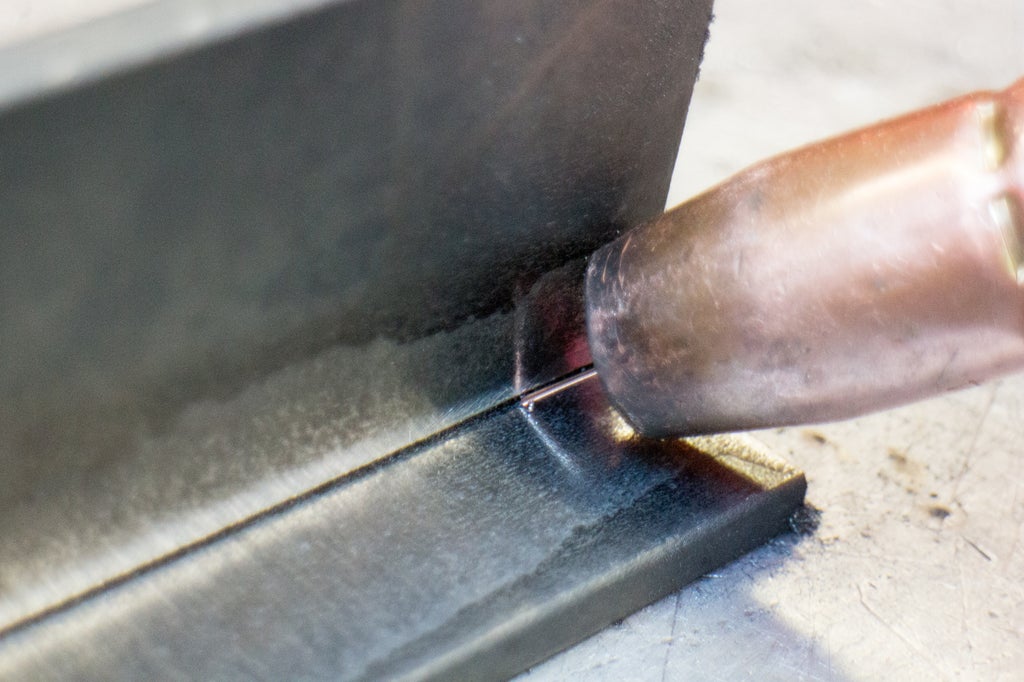

Step 4: Tee Joints
To learn the Tee joint, we first need to introduce the concept of fillet welding. Fillet welding refers to the process of joining two pieces of metal together whether they be perpendicular or at an angle. To perform a fillet weld, we change the way we position our welding torch against the material, so that we penetrate into the corner of our joint at an angle that will be well shielded and ensure strength.
The weld bead will not penetrate all the way through the other side of your base material like we see when we are welding on the sheet material from the Beginning to Weld Lesson.
The tee joint is when two pieces of metal are perpendicular to each other at a 90 degree intersection. Prepare your metal for welding by grinding off the mill scale finish. You only need to grind off the mill finish where you intend to weld, remember to keep considering how to minimize your grind time.
For a clean and close fitting weld, I recommend using magnets that will hold your material square to one another while you are making your first few tacks. Be sure to check your square between tacks using a slide rule or metal square.
Start by tacking each end, placing a tack weld on either side of the tee. Complete a tack in the center, before tacking the opposite side of the tacks you already placed in the center. Finish by tacking the back side of your previous center tack.
A fillet weld motion is not quite the same the chain of loops like we did for our butt weld, instead it is more like a rounded zig-zag shape, where we grab and melt the edges of the base material as we run the weld puddle across our joint. Run beads in sections along your joint, alternating side to side and back to front, working your way towards the middle. A nice fillet weld will form a neat even triangle shape between the pieces of perpendicular material.
