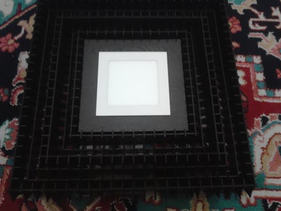

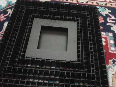

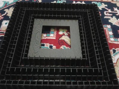

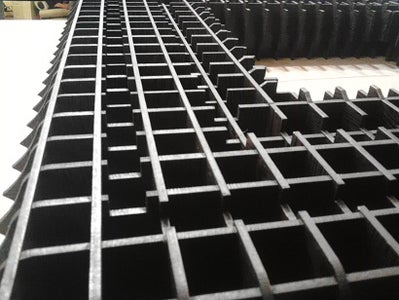

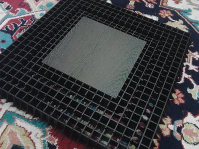

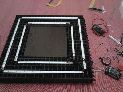

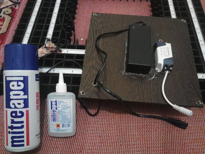

I got a drawing of decorative lights for my study room and I made it for 100 dollars.

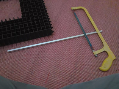

Pictures show the steps of my work.

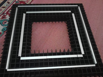

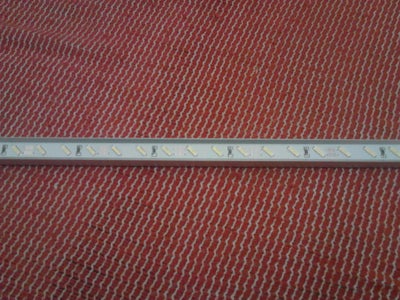

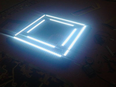

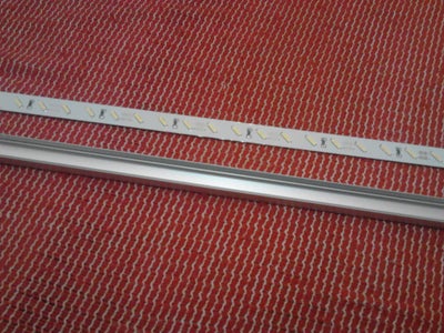

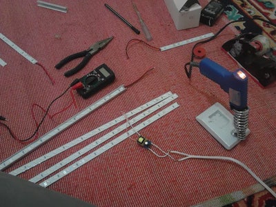

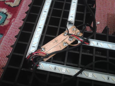

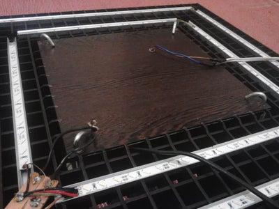

I had a problem at the time led headlights Assembly because they had lowdiameter and short circuit was correct at the time of soldering and I took a lot of time.

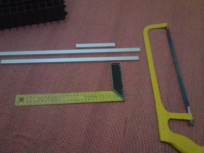

Led headlights are hot during the clarify so you should use aluminum cooling parts

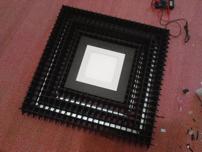

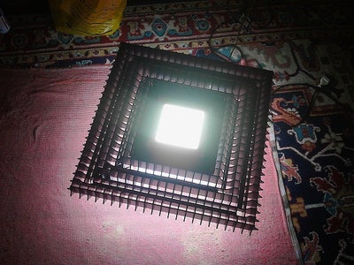

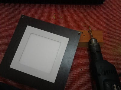

I got used a 5 Watt converter to turn on led headlights

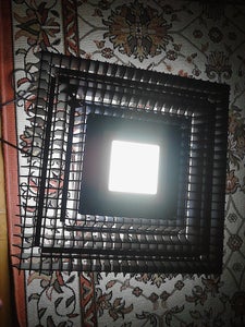

I got the original plan design led lights up the light to the ceiling and spread a gentle light in the room and when we need to have more light, I design a strong12 Watt led lights to have more light in the bottom view of the decorative lights
