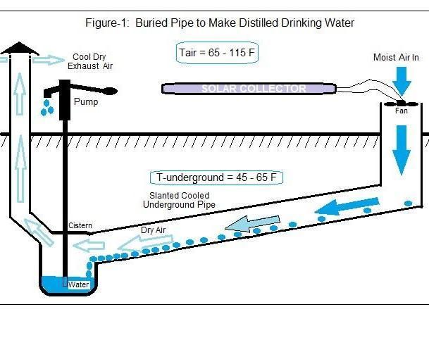

  • A. QUICK REPLY:1. A fan is best way to make lots (GPH - gallons per hour) of water. You need to move 1500 SCFM (standard cubic feet per minute) of air through a 10 inch (25cm) diameter plastic pipe of 150 ft. to make about 12 GPH of water. That much air through 10 inch pipe makes the air velocity at 55 MPH (miles per hour) which is very fast to chill the air down by dumping heat through plastic pipe into colder ground. If you use metal pipe you only need about 100 ft. instead of 150 ft. length.2. It's very hard to generate free convective air movements without a fan. You need to move lots of moist ambient air over 30 meters and that's hard to do using just free convection. If you want to eliminate fan, you need very large diameter pipes or a cave that allows natural air movements into ca…

  • Hi Chris. I can show you how to fish (show math equations on calculating pressure drop and fan size) or just give you the fish (answers), which do you prefer? Fan pressure needed is based on multiplying a known fan pressure drop (base on flow, pipe-length and diameter) by ratio of new pipe-length to diameter used. Then multiplying that by ratio of new to old flow rate squared. Units don't matter since its a ratio as long as they're consistent ones. Result is a needed fan pressure drop for pipe length, width, and airflow rate. This drop is the fan pressure needed to flow your air. In my case a 200ft long pipe 0.75ft diameter (9inches) yields about 10iwc (inches water pressure) drop. I'm flowing 1500CFM of air. This yields about 12 GPH of water under conditions I noted in my report. Now a …

  • Glad to help, keep me informed of your efforts/challenges.Key Points:1)GeneratingLarge GPH: To generate ~12GPH (gallonsper hour) of water you need a costly, high performance fan to produce aflowrate of 1500CFM at a pressure drop of about 10 iwc (inches of watercolumn). The pressure drop is rating is calculated based on flowrate, pipediameter (~10 inches), and pipe length (~ 200 – 250 feet). Generated water is scaledby the flowrate, so that same geometry at 750CFM you get ~6GPH. Typically,water generating systems use lots of electricity to create only a few gallonsof water per day and not per hour. Our system efficiency uses the chillingtemperature of the underground instead of an electric cooler to make the water.We are MUCH cheaper with larger water volume production.2)WindspeedVERY IMP…

  • I looked at the youtube video link and agree thatit doesn't math out! The rebuttal mentioned it very nicely. The diagram shownwill generate some marginal water, maybe a gallon a day, but such passivesystems are not designed for high capacity throughput, and require multiplecells for generating reasonable quantities of water. You need a hefty airmoving fan rated at ~1Kw to move at least 1500 CFM (cubic feet per minute) ofmoist air to generate sufficient water as reviewed in my report. At thatairflow rate and a pipe diameter of about 10inch, plus 150ft long, you couldgenerate a hefty water supply of 12 GPH. I've created a design code based onfundamental heat transfer engineering principles that addresses the necessaryvariables needed to create XX GPH of water, but didn't include its designp…

  • Good concept, but convective draft of such chimneys are minor compared to the required ~10iwc draft pressure drop.
    Yes copper is much better and would improve our 1500CFM airflow design system by reducing the length needed for heat exchange of a 10inch diameter pipe, from a PVC length of 150ft down by more than 50%. BTW: the airflow moves at about 35MPH and won't get heated by friction but rather loose its heat by convection with pipe.

    Takes several weeks to dig ~150ft treansh and lay down 10inch-dia piping, plant a say 50gallon sisterm down about 10ft, and get an electric fan capable of pushing that much air through ~150 of piping. Such fans easily cost several thousand.

  • Hi wkg4,Yes it would work, but the resultant updraft would be ~1/10 to 1/100 of what we need to generate 10 to 15 GPH of drinking water at ~10 inches of water column pressure
    Yes, agreed if you had no power. But with power (solar cells, etc.), I want at least 1500 CFM through a 10-inch plastic pipe (for making 10-12 GPH drinking water) to run moist air at ~45MPH. Under such air speeds you don't even need a sloped pipe. You could use a horizontal pipe and need a water catcher screen at the dump-exit to catch condensed water droplets mixed with and moving with the airflow that will drip into the cistern collector.
