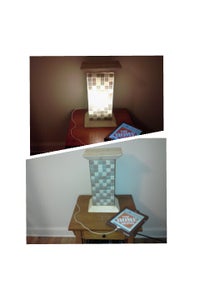

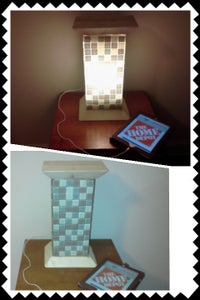

The best place to start will be to decide how big you want it and to keep it modular. When I say modular I am describing the measurements need to reflect the dimensions of the glass tile. I went with fourteen inches tall and as close to 6 1/4" wide as I could get.
I included a video on bending the lexan to shape. I didn't know how to do it before this instructible and as you can see, it ain't very difficult.
Next is casing out the top and bottom with a 2 * 6. I did a bit of shaping the corners to get a tight fit but don't sweat it because it all gets covered. I used wood from a crate because it's free and I love pallets.
then cover the backside of the tile with clear silicone and apply to your box. It takes 24-49 hours to get all of it to dry so I would recommend sharpening all of your chisels and drill bits. If yours are sharp, then well well. This silicone wiill also be the grout so put plenty on and clean up the tile when tacky.
The top and bottom are a piece of 2*4 & 2*6 from the same pallet as I used on the casins that I chopped at a 45° angle because I wanted to be able to put my iPad on it to charge and keep my nightstand from getting cluttered again. I just glued and put a couple screws in.
