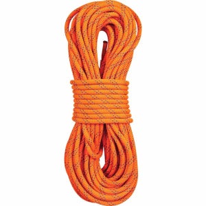

-rope, make sure to use a rope that can handle your weight
-plywood: i used plywood with a thickness of 12mm
-a sturdy material to sit on: i used a doormat that i trimmed to size

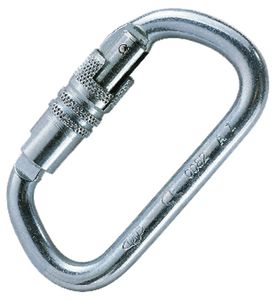

-2 carabiners: like the rope, be sure that they can handle the weight

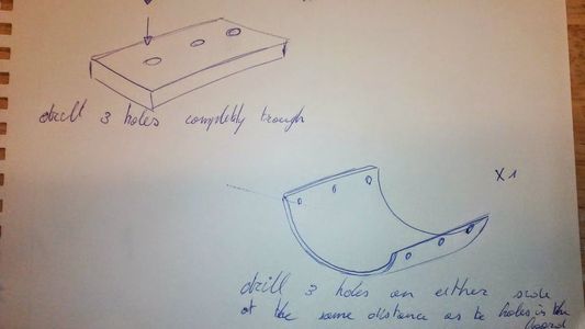

Step 3: Cut and Drill the Plywood to the Correct Dimensions.
for this step you can use a machine or a handsaw.
I used a width of 10cm and a length of 40cm, but you can change these mesurements if you want to.
Drill 3 holes in each board, both at the same distance, i drilled them in the middle of the with, and 10cm from the ends (length) and then one in the middle.
Step 4: Cut the Doormat to the Correct Size and Make Holes in It
use a knife to cut the doormat to the correct size and make 4 holes in it, so the holes match the ones in the board.

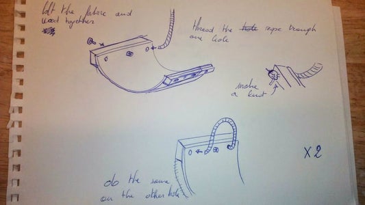

Step 5: Add the Rope
pull a length of rope (aprox 50cm) trough the holes on each side, and tie a knot on both ends.
Add a bolt and nut in the center hole for added strength.

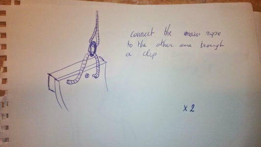

Step 6: Attatching the Long Rope
take your carabiners and put one on each rope that you just pulled through to boards.
Now take the long rope and make a knot or hoop on each end to attatch them to the carabiners.
Once you've done that, you can add more knots or hoops in the rope to make it adjustable in hight.
