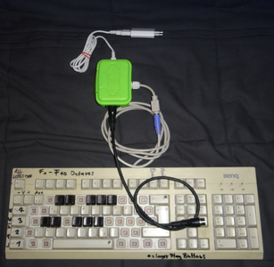

ps2midi is an application for a ps2 computer keyboard,
to be used as standalone midikeyboard. it is based on arduino.
It has features that normal midikeyboards DON ́T HAVE :)
it ́s simple, cheap, available and inspirational.

"DELETE", "RETURN", "rightSHIFT", and "SPACE" used to play up to 4 midi notes simultaniously. very cool for chords or drumz ;)
by default, "DELETE", "RETURN", "rightSHIFT", and "SPACE" play notes "C+++", "C++","C+" and "C"
Concept of "SPECIAL KEYS" :
keep in mind !!! : every time you push a "NOTE KEY", the last stroke is remembered.
Every SPECIAL KEY has 4 Layernotes to play, defined by the
"LAYERKEYS" =
"T AB"(Layer4), "Capslock"(Layer3), "leftSHIFT"(Layer2),
"CTRL" (Layer1)
By default, only one layer(LAYER1) ist loaded. How to load a NOTE into a LAYER:
First Push a SPECIAL KEY to choose SPECIAL KEY then
Push a LAYERKEY together with the desired SPECIAL KEY and the last remembered NOTE is loaded.

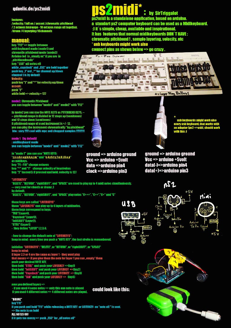

3 Different Modes:
Modes can be changed with key "F12" - keyboard lights show witch mode is on. SPECIAL KEYS work in every mode.
1-PIANO Mode
"scroll" light is on.
In normal mode the "note"keys play midi notes.
"NOTE KEYS: "z,s,x,d,c,v,g,b,h,n,j,m," and "e,4,r,5,t,y,7,u,8,i,9,o,p" octaves are chosen with keys F1 - F10
2- Chromatic Pitchbend Mode
"scroll" and "caps" lights are on.
NOTE KEYS are PITCHBEND KEYS.
pitchbend range is divided in 12 steps up (semitones) and 12 steps down (semitones)
if pitchbend range of used instrument is +/- 12 , you can play the instrument "by pitchbend" very !!!!! cool with mpc (jjos) and chopped samples !!!!!!!!!!
SPECIAL KEYS are tweaked too.
3-MPC Mode
similar to mode 1 -but !!!
key notes are like mpc drumprogramm notes only "white" keys are used - to refer to the drumpads, lower octave is pad 1 - 8 upper octave is pad 9 - 16 key "F1 - F2 - F3 - F4" is bank A - B - C - D
"DRONE"
key"F11"
if you hold "F11" while releasing aNOTEKEY orSPECIALKEY => no "note off " is sent.
=> the note is on hold
