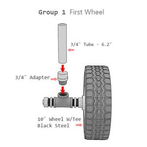

Step 1: Building the Wheels
You’ll need the ¾” Tube - 6.2” long, the ¾” adapter and the 10” wheel w/ tee black steel.
We’ll start with the wheel-base, we will build two of these..
You'll be assembling both wheels using the same method, so refer to the diagram above to gather all the necessary parts needed (x2).
Insert your ¾ 2 tube to the ¾” adapter. Then place the adapter into the 10” wheel w/tee. Check the diagram for reference.
Once finished, you can set them aside until the moment arrives to attach them to the frame later.

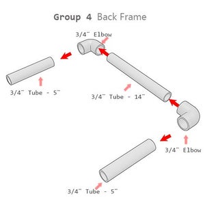

Step 4: Let’s Build the Back Frame of the PVC Wheelchair Frame
For this part you will need two ¾ “ elbows, two ¾” tubes 5” long and a ¾” tube 14” long. The back frame of your dog wheelchair should be very easy. And you’ll only need one of these.
Attach all five parts together as shown in the graphic above, and then lay this aside.

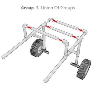

Step 5: Let’s Put Together All the Parts of the Wheelchair
We are almost there!
Let’s connect all the pieces together. For this last step, you’ll just need two additional 14” PVC tubes.
Use these PVC Tubes  to connect both sides of all your frames.
Next, go ahead and connect your back frame and wheels.
And, you’re done!
