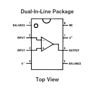

Step 2: Intro to Op-amp
This is an op-amp - otherwise known as an Operational Amplifier.
What you will need to know about an op-amp:
As you can see on the diagram, it has two inputs - a "minus" (inverting) input and a "plus" (non inverting) input - and one output.
It needs to be powered (we used +15 volts and -15 volts).
Ignore the other 3 terminals for this project.
How it works:
Nobody really knows....  It's a magical little guy that some clever engineers designed years ago.  If you're a really serious electronics geek (in which case good for you!) and want to know the complicated details of how this particular op amp works, check out http://www.ti.com/product/tl082.
For the rest of us mortals, we can understand op amps by applying the three golden rules:
1) No current (ok, ok...very very little current) flows into the op amp inputs.
2) The op amp can put out current from its output (with negligible output resistance), but only up to a certain amount (about.25 mA for ours)
3) If you connect the output to the "minus" input (as we will), the op amp will try its darndest to make the voltage at the "minus" input equal to the voltage at the "plus" input.

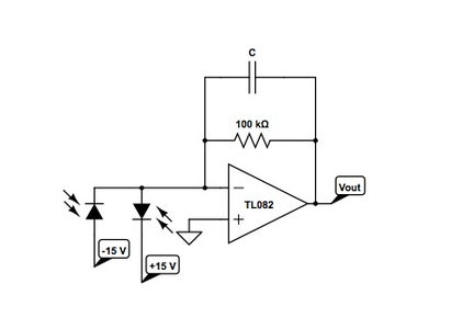

Step 11: Differential Light Meter
Now we are finally ready to make the differential light meter!
Notice how this is very similar to the improved transimpedance amplifier, except that there are now two photodiodes.
Also notice how the two photodiodes are pointing in opposite directions, and reverse biased with different voltages.
Apply the same procedure as before to make sure you do not connect the new photodiode backwards.  Remember: the flat, or "red" side of the diode corresponds to the line in the diagram.  Refer back to step 8 for a reminder on how to use your multimeter to check which side of the photodiode is the "red" side.
How does it work?
This works in the exact same way as the improved transimpedance amplifier, except that the current flowing out of Vout, through the resistor/capacitor barrier, to V- is now the sum of the two photodiode currents.  Furthermore, the photodiode currents are flowing in different directions, since one is reverse biased with -15V and the other is reverse biased with +15 volts (the electrons are repelled away from the -15V and attracted towards the +15V).
If the -15V diode's current is Iminus(t) and the +15V diode's current is Iplus(t), then the total (positive) current flowing out of Vout through the barrier is Iminus(t) - Iplus(t).  So Vout is now measuring the difference between the two currents, and thus it's measuring the difference between the intensity of light into one diode versus the other!
If you bend the two diodes so that they point in opposite directions, you now have a device that measure the difference between the intensity of light on one side versus the intensity of light on the other.  A differential light meter.
