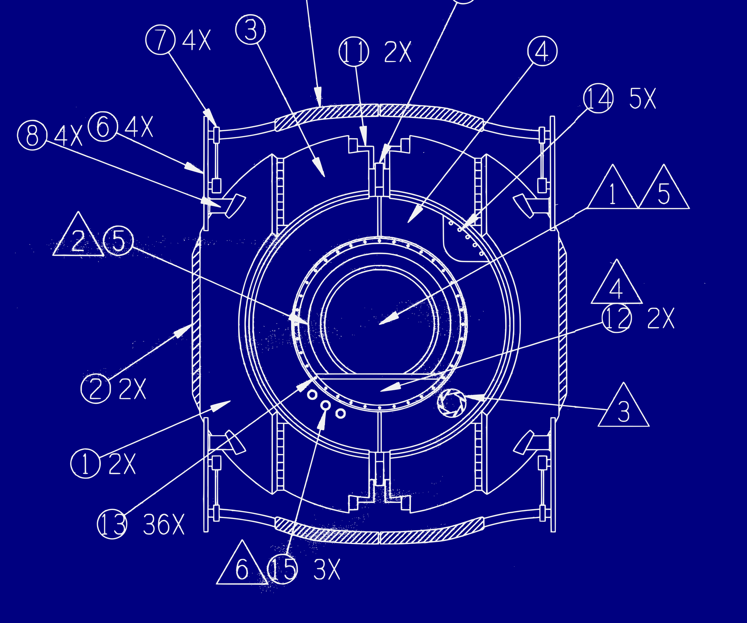

When I decided to start this project, I made several little schematics and drawings; basically I got out all of my ideas on how to make this project work. Most of these drawings are now lost to me, due to there being so many.
Also, the Portal Authoring Tools from Steam (specifically the Model Viewer) really helped me visualize what type of motion Wheatley has and what I might be able to do.
