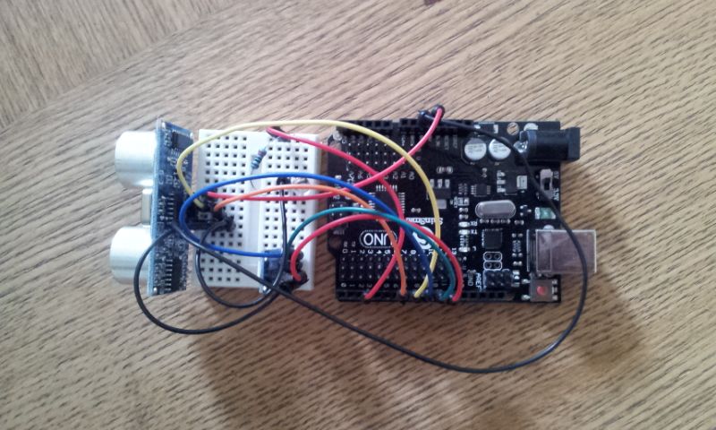

Step 2: Wiring
You will need to create a simple voltage divider circuit as shown.
- Connect the output LED to digital pin 9 of the Arduino (don't forget the resistor!)
- Connect the sensor to analog pin 0.
There is a good tutorial explaining this concept on Jeremy Blum's YouTube channel:
