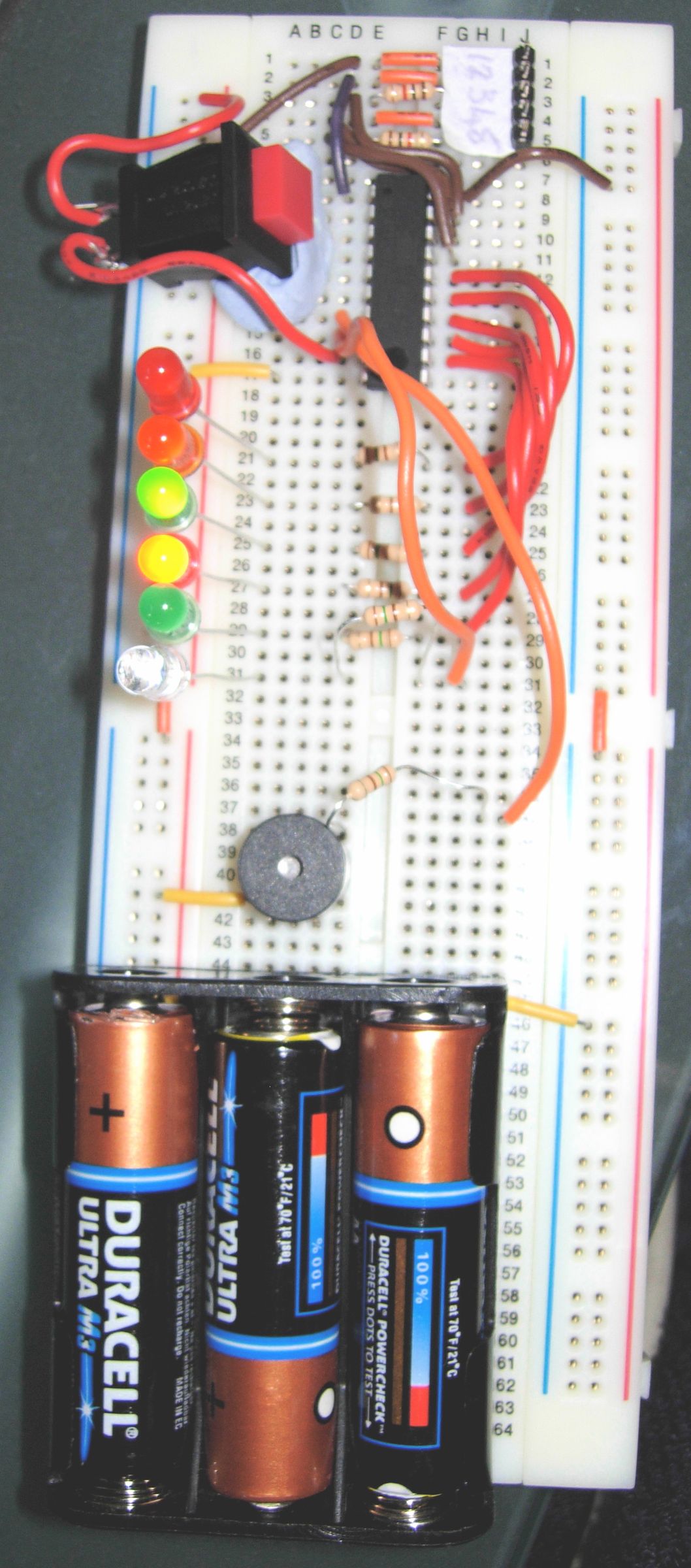

Before we begin ensure all LEDs are connected the right way around. The short lead goes on the right and the longer on the left.
We will be adding the resistors later so be sure not to plug in any power yet as it could damage the LEDs
The image below shows the long and short leads, and then the second image shows how they should be wired, third showing the order.
TIP! Ensure that yu have the LEDs spread across from the 5 column bit to the two column bit or else they will not work and you will have a short circuit.

Step 6: Resistors
Using the 220 ohm resistors wire from the LEDs across the divider to the same row on the opposite side, (See 2nd image for example) and repeat for all the LEDs.
Add the white LED beween the Piezo and button and add a resistor to that LED also.
The 3rd image below shows the final result. (note the GREEN wire is not necessary, unless your circuit doesn't work like mine did, it joins the top half of the boards power rails to the bottom half as some boards are split).

Now we are going to wire the Arduino to the breadboard, the wires all word in the order from top to bottom, and do not cross over so if the wrong lights come on at the wrong time patch the cables back in the right places...
Images below show how these should be wired.
Image 2 & 3: From the 5v line go to the resistor we placed coming out of the button.
Image 4 & 5: The green wire on the GND (ground) pin goes to the red rail which you connected the cathode of your LEDs to.
Image 6: The LEDs are wired in turn from pin 13 down to 8 starting at the top LED working your way down the bread board. This is why I said to have the board to the left as you can wire it as below...

Image 7: Wire the orange wires like before to the Piezo (pin 8), wait led (pin 7) and button (pin 6)
Note the position of pin 6 is critical other wise the traffic lights will constantly loop as if the button was held down.
