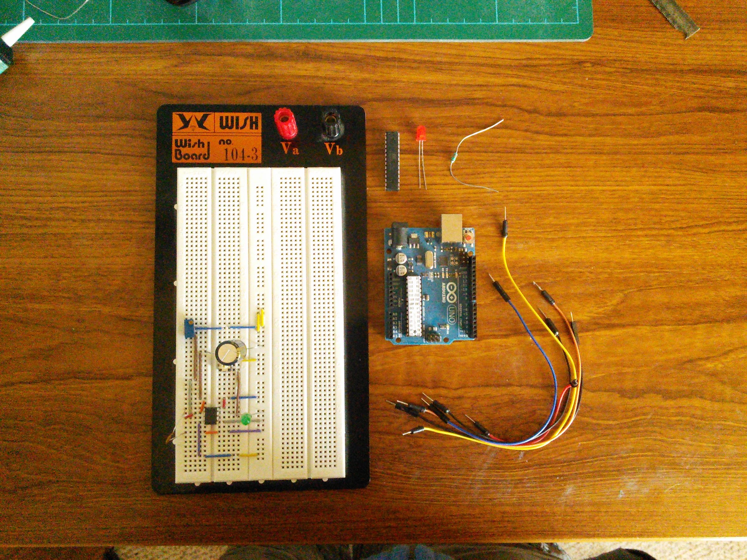

Arduino
Atmegaxx8 (doesnt matter which one but i prefer the 328)
Breadboard (circuit on bottom left is irrelevant)
Jumpers
Computer
USB Cable
USB-FTDI/USB-TTL (optional)
LED and resistor (optional)
Step 1: Breadboard
The breadboard setup is fairly simple and requires minimal components, none at all.
I have included a resistor on pin 14 or digital pin 8, purely to test my chip.

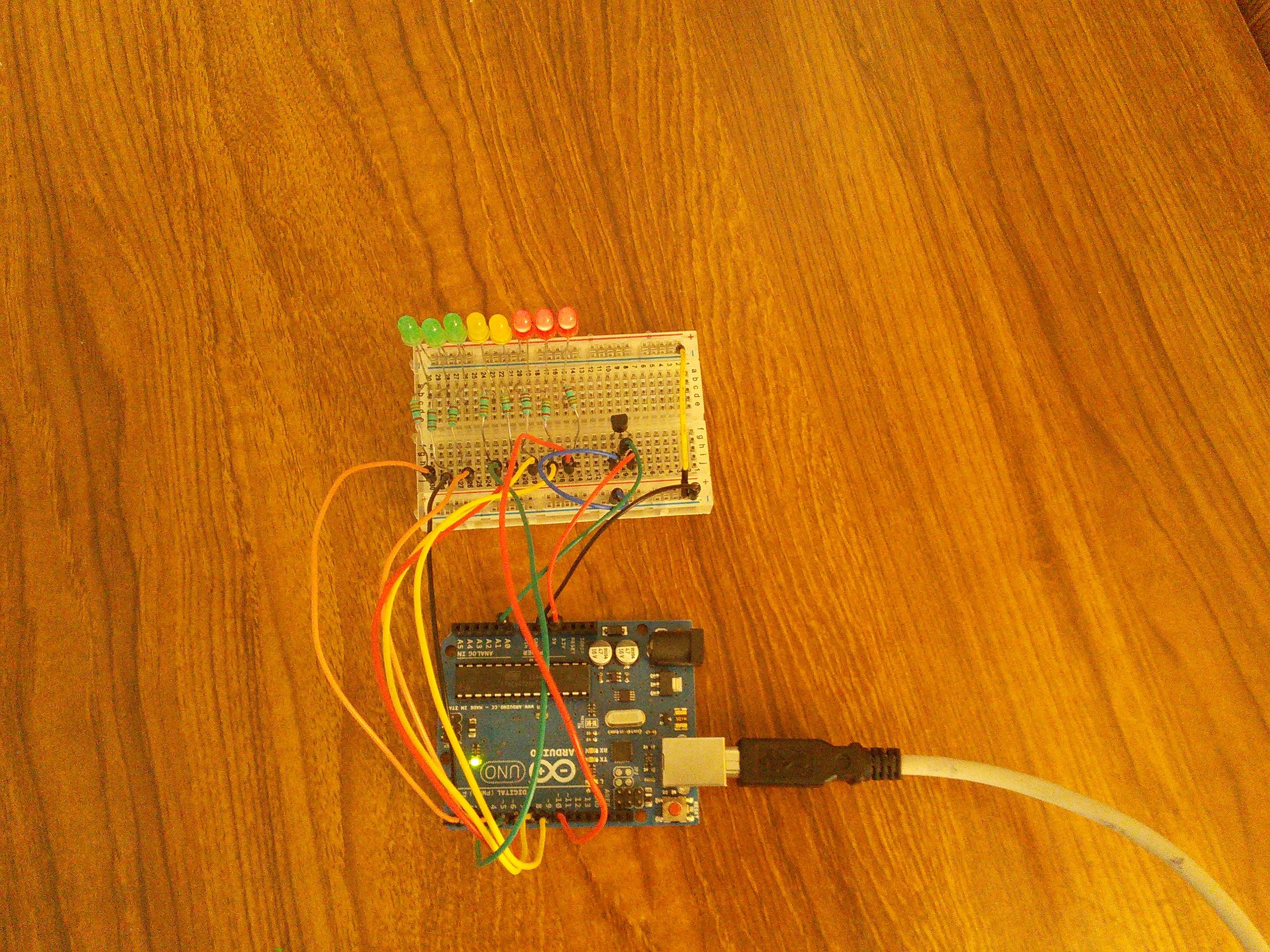

There are two ways of doing this, either with an Arduino or a USB breakout board type thing.
The Arduino way is detailed in the image.
The USB way is to connect TX to RX and RX to TX between the chip and your breakout board and just upload from there.
This is where you may want and LED, just to test its working.
