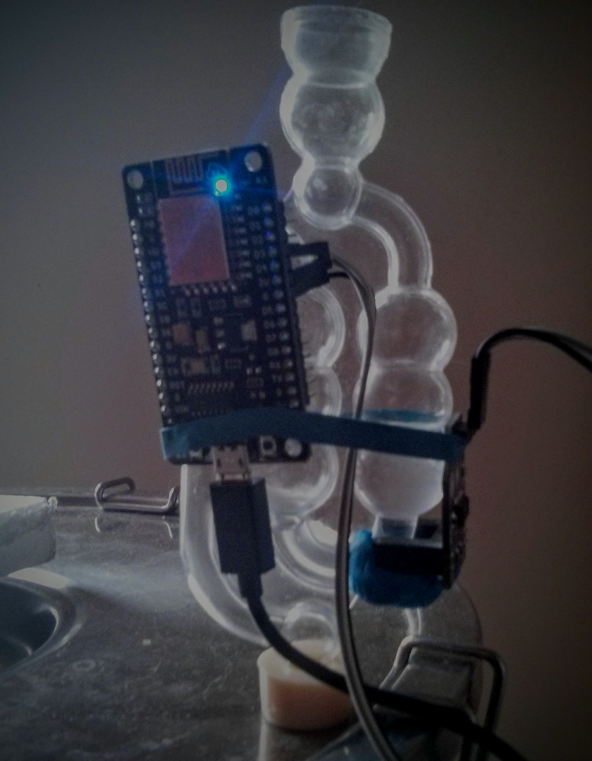

I used a couple of elastic bands to position and secure the opto coupler to the bubbler. I found that it was a little tricky to align the sensor at first, especially if fermantation has just kicked off and it is slow. Once it is aligned, and bubbles are being reported on the
Tips for sensor alignment
Try to align the sensor so that it its path is just past the bottom neck of the bubbler tube (see red line in pic above) . This will help to prevent false readings.
The sensor , helpfully has a red led on board which flashes when a bubble is detected in its path. I found it's better if the LED is on when there is no bubble and off when a bubble is detected (it works conversely, however its harder to align)
Alignment is much quicker/ easier If you align the sensor when fermentation has got going (bubbles 2 secs or less apart) try it and see!
A bit of sugru on the bubbler can be used to fix the bottom position of the sensor for easy subsequent alignment. Only the top elastic band will be needed then
