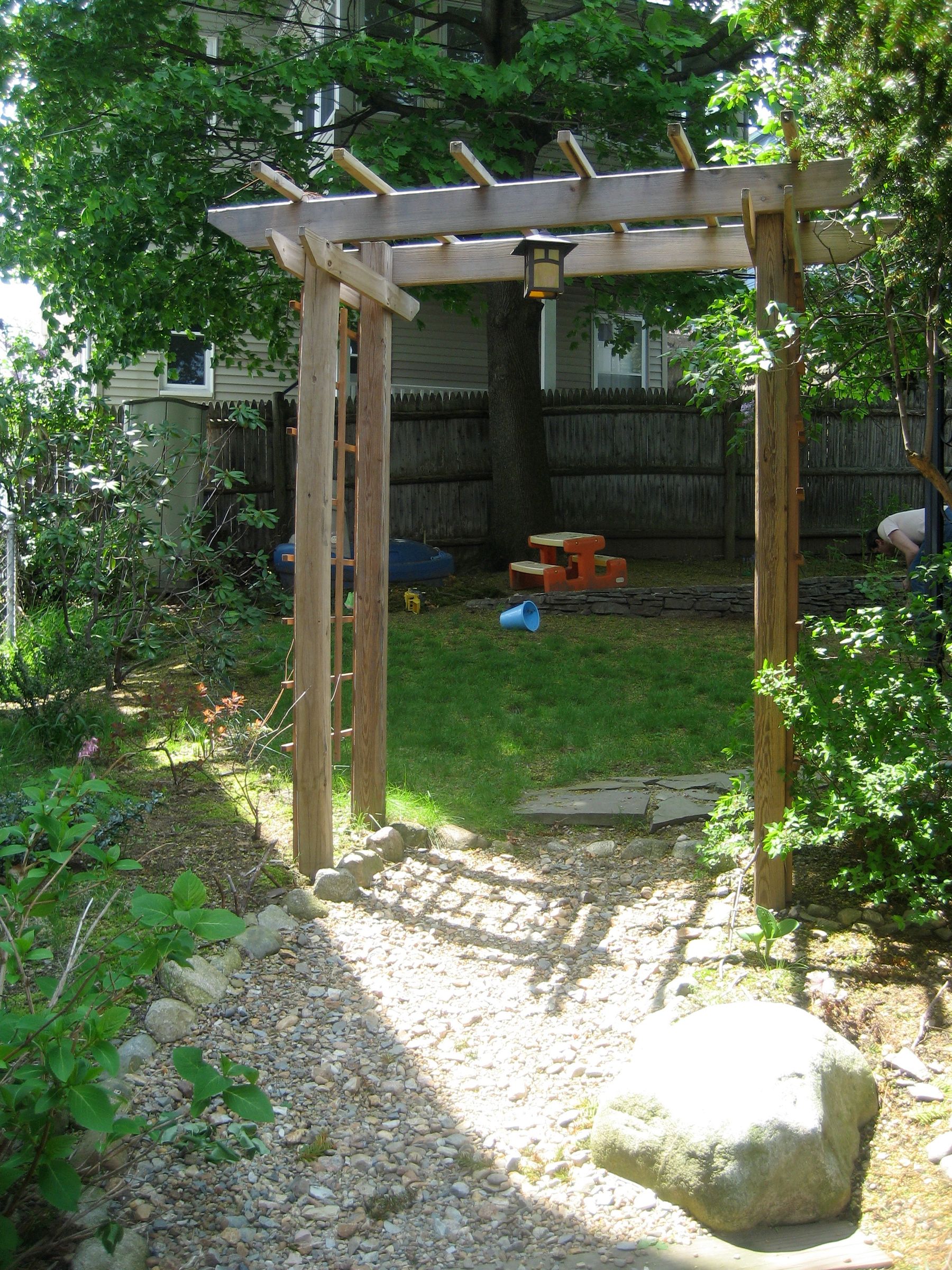

We wanted to have a small arbor for a garden entrance. We were looking for something made of wood, and fairly simple, with an Arts and Crafts or Craftsman style. However, the sturdy ones in the style we liked can be quite expensive ($200-$300 range, with some as much as >$1000), and the only ones we could find that were reasonably priced were either not to our tastes, or looked flimsy. Since the style we wanted was pretty easy to mimic, and the construction looked simple, we decided to build one ourselves. My estimate for how much it cost us in materials was a little over $100 (we already had the deck screws and the tools, or borrowed tools we didn't have).
We did not pour cement reinforcements for the trellis, as we were going to stay above the frostline, and it was not going to be very large (and thus didn't have to support too much of a load). We built this in 2006, and after 5 years (with lots of rain and snow storms) it is still doing just fine!

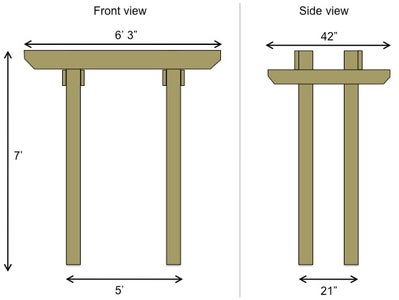

Plan the dimensions. Choose a width (we did 5' to the outer edge of the posts) and height (7'). This is a little shorter than most arbors but we figured if we went longer it would not allow us to be efficient about the posts--because the 4x4s came in lengths of 8' we wouldn't have to cut them and waste any wood. However, if we wanted the posts to extend higher vertically but still have at least 1' below the ground , we would have to buy four 4x4s in 12' lengths, cut them all down to length, and then have left over pieces.

Cut the front/back and left/right cross pieces to length. We used a handsaw but a circular saw may be more convenient. We gave them an angle at the end for decorative purposes. We chose a length by putting the posts on the ground and laying the cross piece on top, and seeing what looked best by eye.

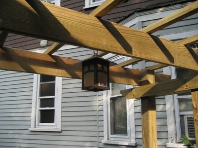

The top lattice are simply pressure treated 4' balusters, which are really cheap. We chose them this length so that they would overhang both the front and back by about 1'. Attach these to the front and back cross pieces using deck screws. Then, attach one perpendicular to all of the "first layer" balusters.
Optional: we wanted a hanging lantern, and had a set of two solar powered LED garden lanterns, so we stole one from the hanging lantern and attached it to the cross pieces with wire.

And you're done! Note: we opted not to paint or stain the arbor, as we wanted the natural wood appearance.
