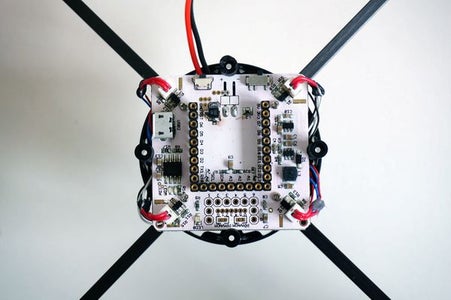

Step 1: Fixate the Flight-control
Hardware Assembling
- Microduino-Core*1 Core board
- Microduino-USBTTL*1 Program download
- Microduino-10DOF*1 Attitude stabilization
- Microduino-BT *1 Wireless communication
- Microduino-QuadCopter*1 Four-axis drive
Fixate the flight-control backplane on the main frame and set a forward direction before you do that. (The default forward direction of the flight-control backplane is the open end direction of the UPin interface.)
Step 2: Fixate the Microduino-Quadcopter on the Main Frame

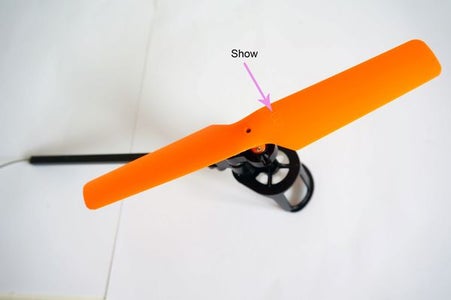

Step 3: Fixate the Four Motor Arms on the Main Frame

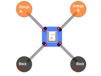

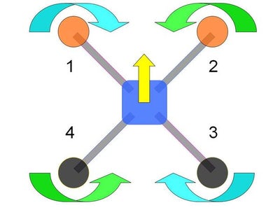

Fixate the four motor arms on the main frame and in the process, set the head direction as follows: Generally, we set the two orange rotors in the front and the other two black ones in the back so that we can tell the head direction by the color even when the aircraft flies far away.
When doing this, you also need to pay attention to the right order of CW and CCW paddle.CW paddles are marked with an A on it and CCW paddles are marked with a B.CW paddles should be fixed at left-front and right-rear.CCW paddles should be fixed at right-front and left-rear.

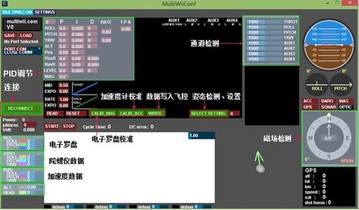

Place the quadcopter on a flat surface then connect it to the computer via USB.Select Microduino Core (Atmega328P@16M,5V) in the Arduino IDE,then download the program. Run the config tool in the following path:MultiWiiConf\application.windows32\MultiWiiConf.exe
Step 8: Connect PC to Quadcopter
Click the RECONNECT button to connect.The raw data and some graphs should be shown if everything’s okay.
Step 9: Adjust the Sensor
Make sure the quadcopter is on a flat surface,then click the CALIB_ACC button to calibrate accelerometer.DO NOT move the quadcopter in 5 secs.Then click the CALIB_MAG button to calibrate magnetometer.In the coming 30secs,please grab your quadcopter and rotate it in every axis repeatedly. Then click the WRITE button to save the data. By clicking SELLECT SETTING,various parameters can be set,and the quadcopter’s status will be shown.

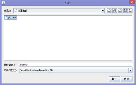

We offer the sample PID config file,user can load it and fly the copter in a few minutes: click LOAD,then select file pkj.mwi to load the config file,finally click write to save. If you want to adjust the parameters yourself,just click on the green bar and hold it,then drag it left or right to adjust.For more info, please google Multiwii.

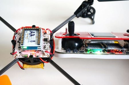

Step 12: Build & Debug the Remote Controller

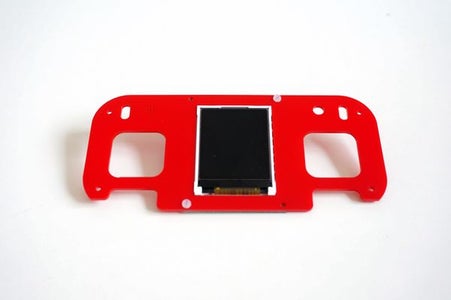

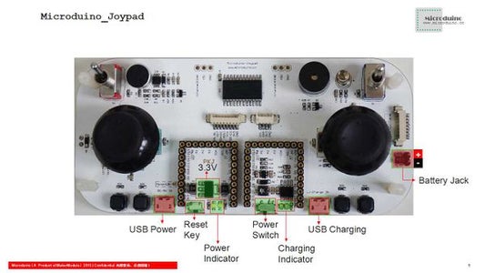

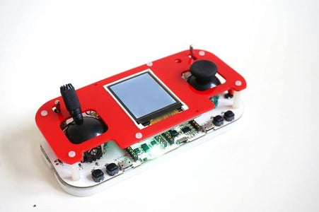

Here we adopt Microduino-Joypad as the remote controller. Of course, you need modules, such as Microduino-TFT, Microduino-Core, Microduino-USBTTL and Microduino-BT to build the remote controller.
Install Microduino-TFT on the panel of Microduino-Joypad;

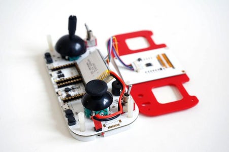

Step 13: Stick the Panel
Fixate Microduino-Joypad with screws and stick the panel to the bottom of Microduino-Joypad;

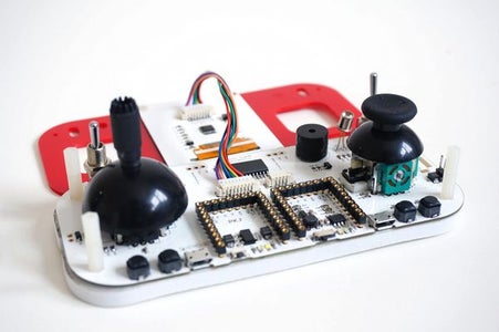

Step 14: Connection
Connect Microduino-TFT and Microduino-Joypad through wires;
Step 15:
Connect the Li-ion battery to the bottom of the base board and make sure a right connection of the positive and negative charges;
Step 16:
Fix the base board and the panel with nylon screws;
Step 17:
You can start the power and see if it is charged normally.
Step 18: Stack Modules
Stack Microduino-USBTTL, Microduino-Core to the base of Microduino-Joypad. In the meantime, just don’t stack Microduino-BT module, or it will cause the serial port conflict.

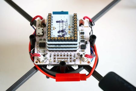

Stack Microduino-Core, Microduin-10DOF and Microduino-USBTTL together, then install them to the flight control plate, as picture 3.4-1 shows:

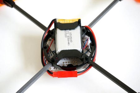

Fix the battery at the bottom of the quadcopter and then connect with the power cord of Microduino-Quadcopter.(The red cord is the positive and the black one is the negative.)
Step 23: Start Microduino-Quadcopter
Start Microduino-Quadcopter, put it on a stable area, press the reset key and the system will automatically adjust the sensors.
When it is undone, the red LED light will blink on the board and will go off after the adjustment is done, waiting for unlock.
Step 24: Overall Test
Watch whether the Microduibno-BT module on the quadcopter is connected with the BT on the Joypad, which you can tell by the indicator of the BT module.
When the indicator does not blink, it means the BT modules being connected.
Step 25:
Unlock the quadcopter and pull the top-left switch downside(Close the throttle) and adjust the throttle to the lowest before flying for fear that the throttle rocker value is too large and causes accident.
Put the throttle to the bottom-right and you can see the LED blink, just be ready for connecting, wait for about 2 seconds and loose the throttle rocker.
Repeat that operation for several times until the LED is on for a long time.
But if you try that operation and still cannot unlock the quadcopter, please reset the quadcopter’s core and the system will adjust the sensors automatically, just try to unlock once again.

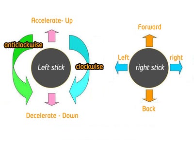

Pull the throttle rocker to the bottom, push the top-left switch upside(Open the switch of the throttle), at this time, you can refer to the rocker control schematic. Just need a slight push of the the rocker, you can see the four propellers get spun rapidly.
Keep increasing the throttle, make sure it fly away. A little higher, don’t fly along the ground and then you can control the stability with the rocker bar.
