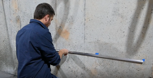

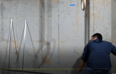

Step 1: Measure Bottom
Measure the center bottom of the mirror placement.

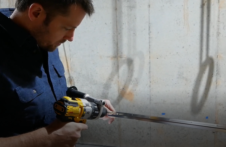

Step 2: Tap
Tap out the holes in the J-mold so the anchors will fit.

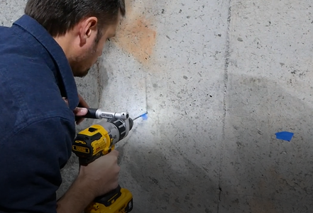

Step 3: Drill Bottom

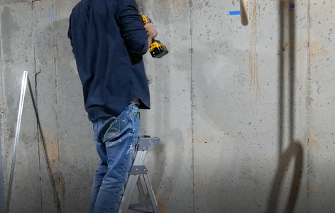

Drill the hole for the center of the bottom J-mold.

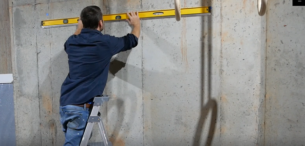

Step 4: Fasten Bottom
Fasten the J mold to the wall in the center, then make sure it is level. Drill and fasten other holes.

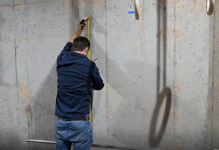

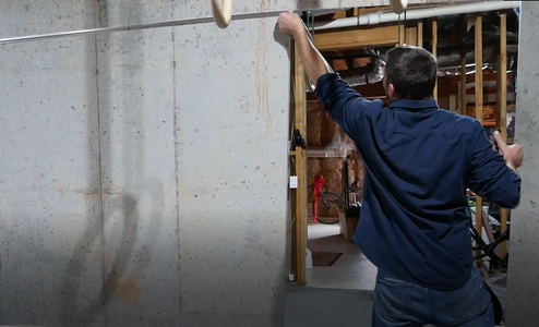

Step 5: Measure Top
Measure up from the bottom J-mold the height of the mirror to mark the placement of the top J-molding.
Step 6: Drill Top
Drill top center hole.
Step 7: Fasten Top
Fasten top in center, then check for level. Then drill and fasten other holes.

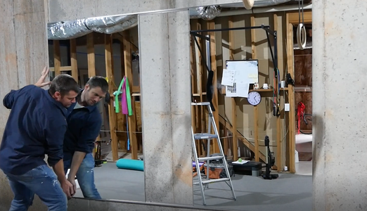

Step 8: Install Right
Slide the right mirror in place.
Step 9: Install Left
Slide the left mirror in place.
