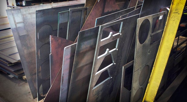

Step 1: Raid the Scrap Bin!

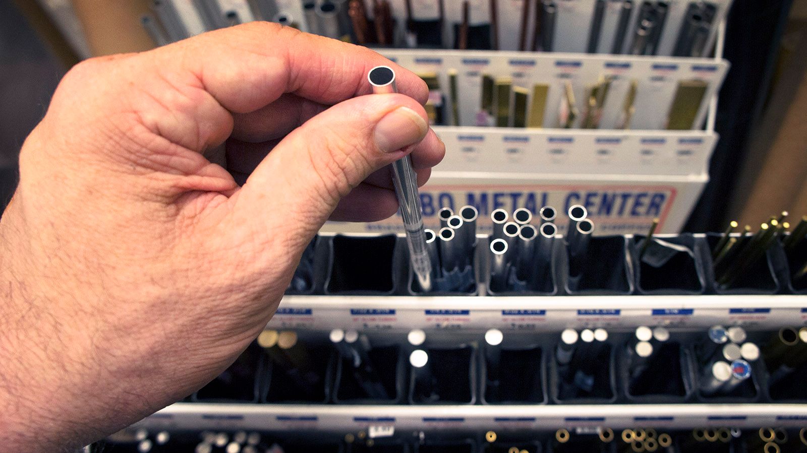

When you go to your local metal store, raid the scrap bin!
If you're saving something from landfill, you can argue it's "ecologically free". Don't get too self-righteous about this, but it's a pretty good rule of thumb. And scrap is a LOT cheaper than virgin metal cut to size!
Almost any metal store will have a scrap bin, and there're lots of specialty scrap dealers around. (Their stores are way more fun to walk through, too!) Making your stuff out of scrap might save you time, too—why build parts from scratch that you could just find?

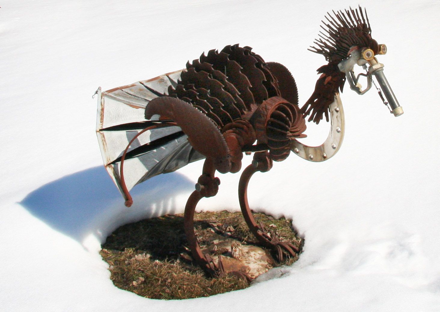

(Above) Scrap-metal bird from the Forevertron

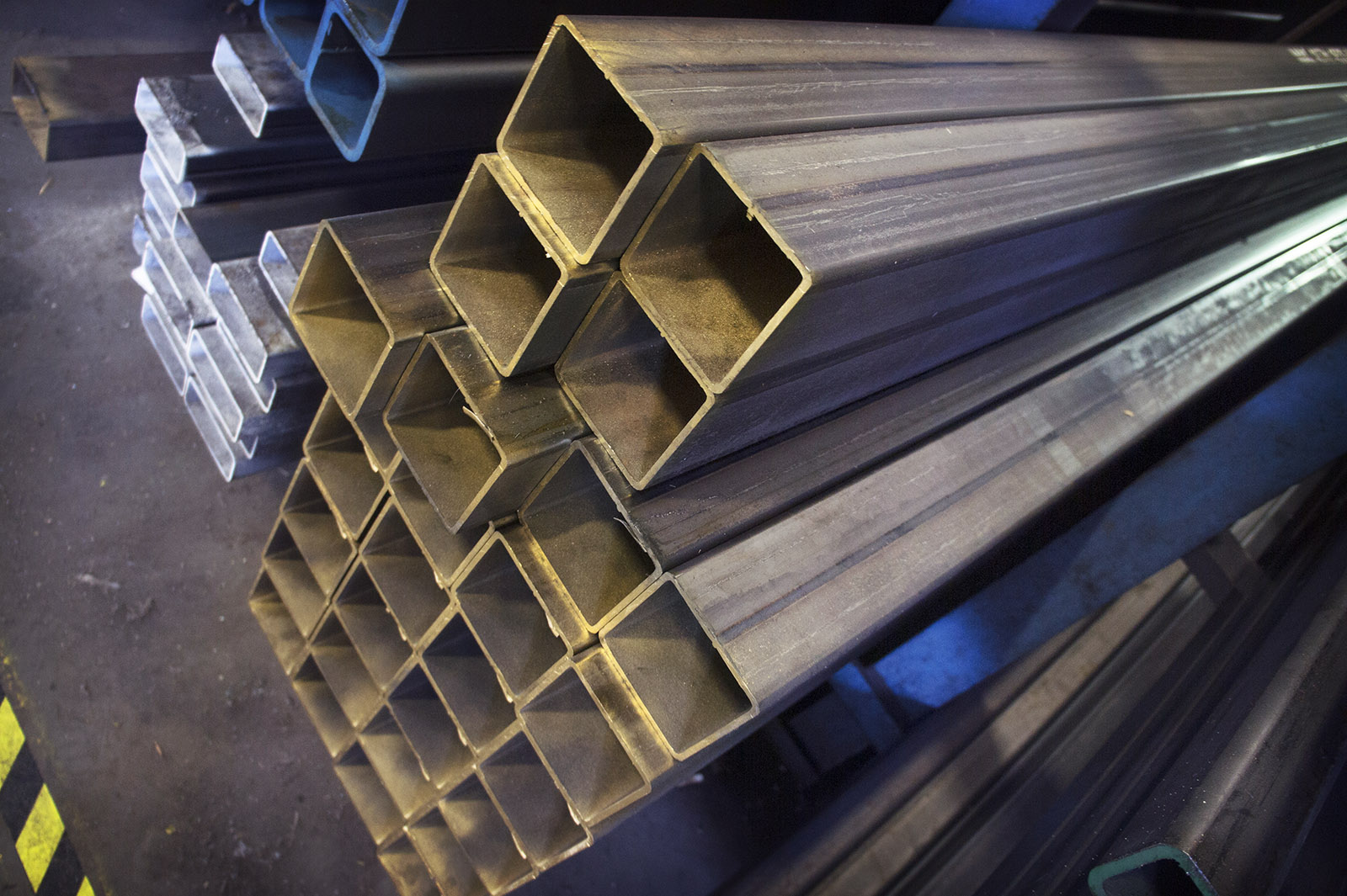

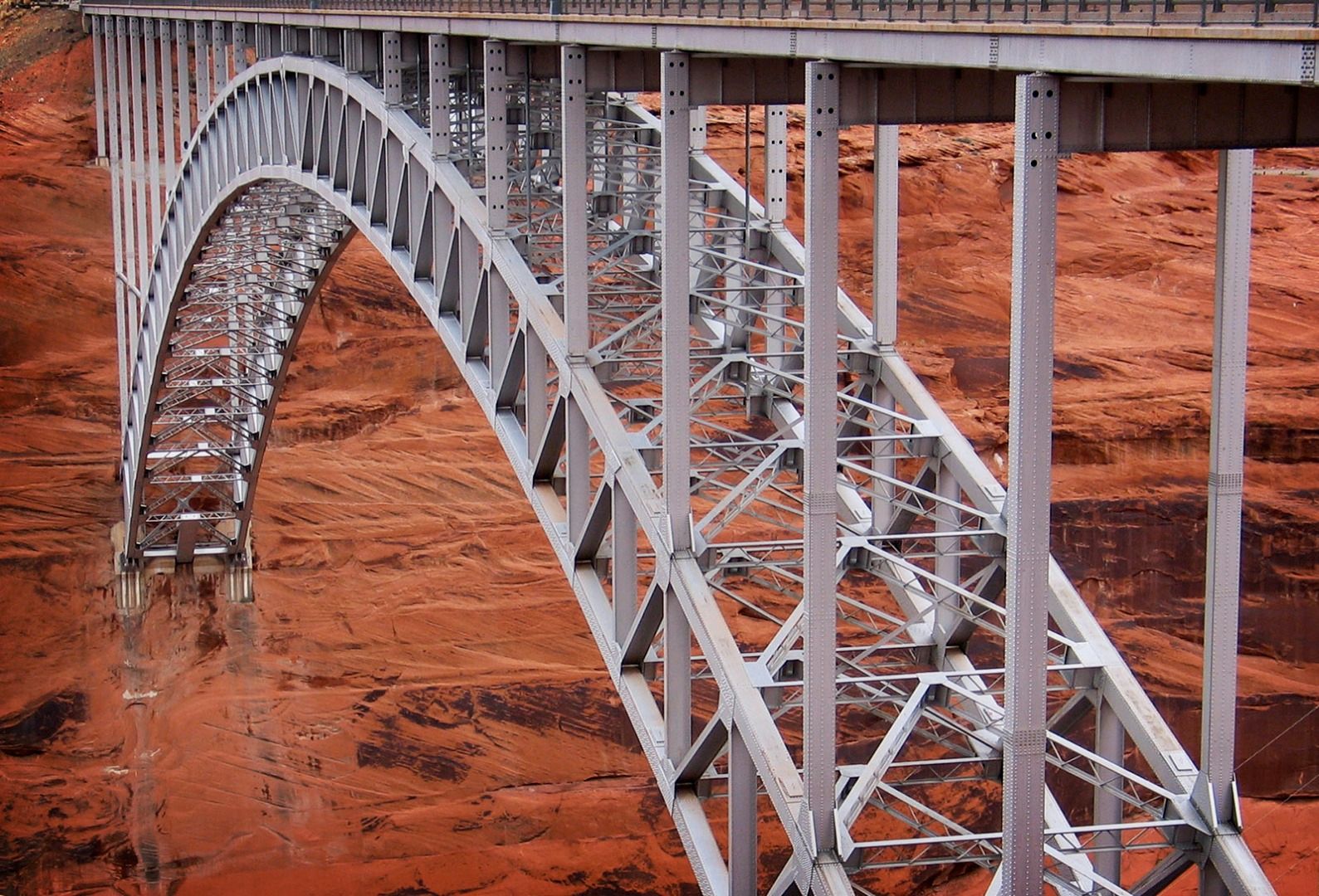

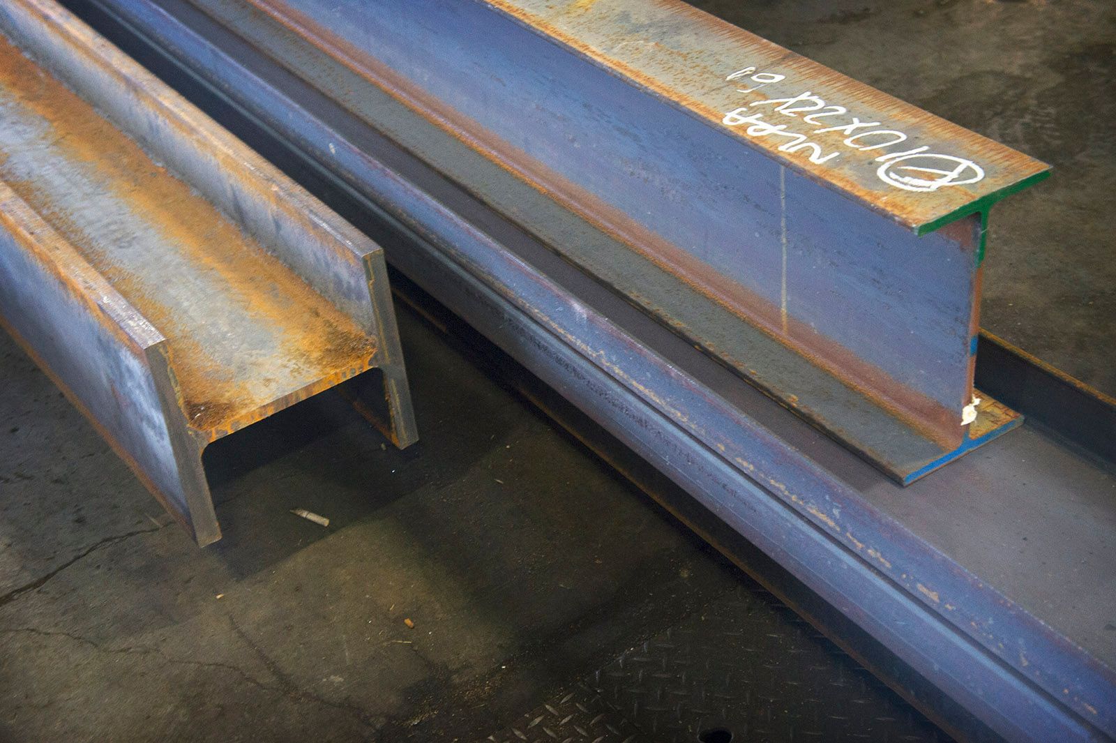

So who sells recycled? Almost all structural steel (I-beams, etc.) is 95%+ recycled. But somehow it's really hard to find sheet steel with more than 25% recycled content. If you know someone who works at a steel mill, bug them about this. It's dumb. For aluminum, it'll depend by alloy. Ask your local shops.

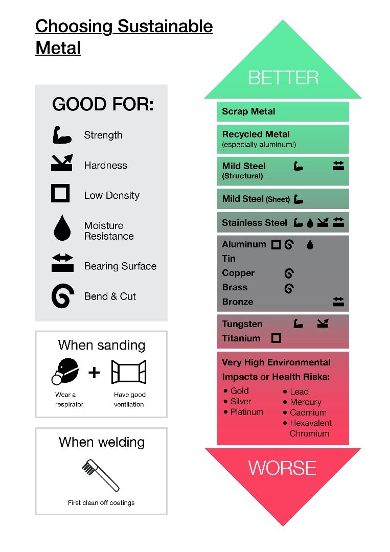

Step 3: What's a Greener Metal?

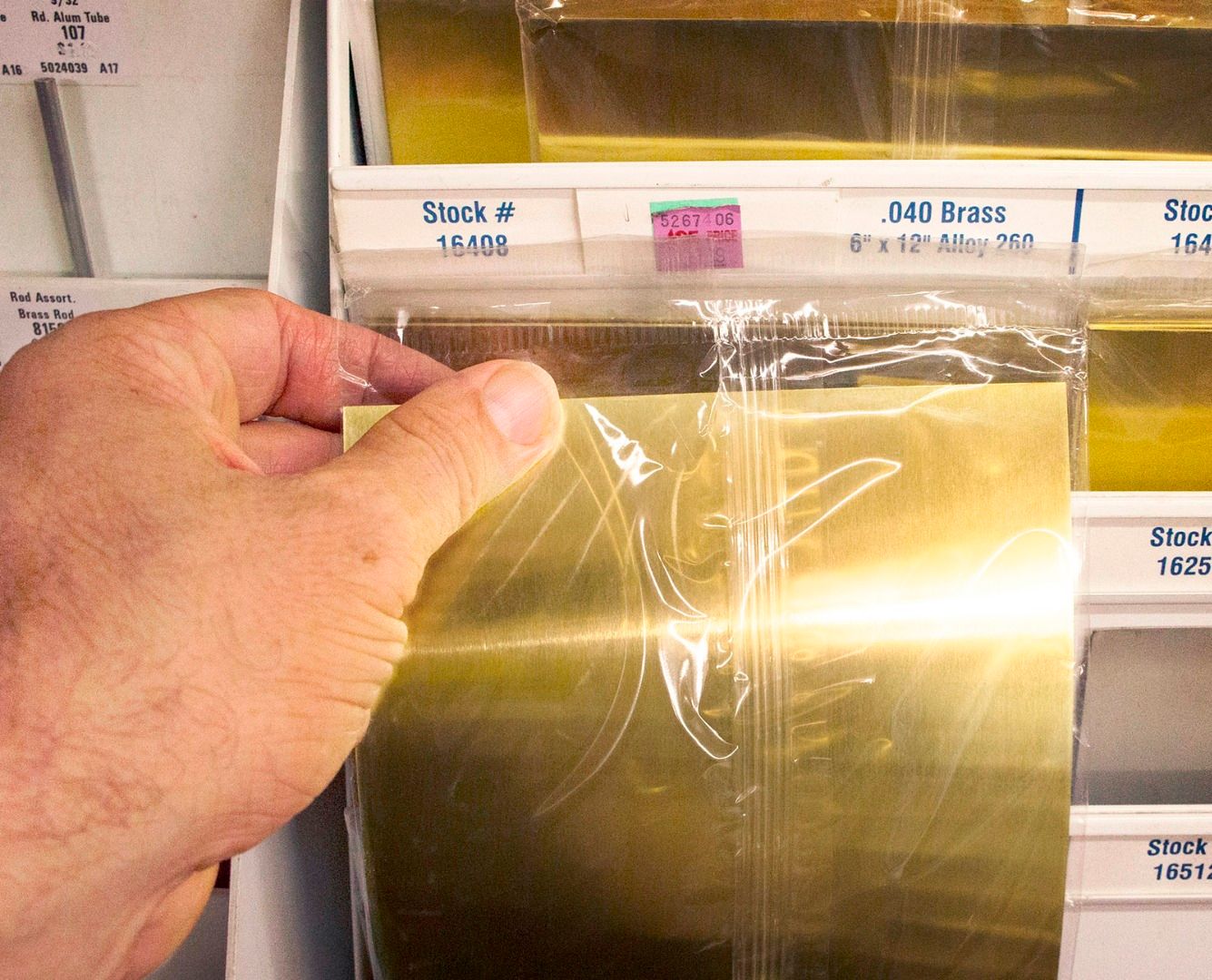

By far most of the metal you're likely to build with is steel and aluminum. The good news is that most of the time, cheap metals are green metals, and expensive metals aren't. Iron and mild steel are not only the cheapest metals you can get, but also the least energy- and resource-intensive metals. (A great paper from MIT shows how people only need to dig up 2-5 lbs of ore for every 1 lb of iron, using only about 20-30 MJ/kg of embodied energy.) It's also by far the most-recycled metal. And it isn't toxic, by itself.
Aluminum also isn't toxic (the Alzheimer's thing was a myth from bad science), and while virgin aluminum does take a lot of energy (200-300 MJ/kg), it's still less energy than many other metals (like titanium), and it's easy to recycle.
Compare these to the precious metals: Gold takes 100,000 to 10,000,000 pounds of ore for every 1 pound of gold you buy, using about 100,000 MJ/kg of embodied energy. And while gold itself isn't toxic to you once it's refined, lots of arsenic is used to separate the gold from the ore, which leaves lots of toxic crap for mines, miners, and their local communities to handle. Silver isn't as bad, but it's still about 10,000 times as resource-intensive and 10x more energy-intensive than aluminum. Platinum is even worse than gold.
Copper is surprisingly bad environmentally—partly because it's increasingly scarce (every pound of copper these days requires 100 – 1,000 pounds of ore), and partly because it's surprisingly toxic in rivers and lakes. It's regularly used in pesticides and wood preservatives because of its toxicity. (Though it takes a fairly significant dose to be toxic to you, and trace amounts are necessary for your health.) Copper's not nearly as bad as gold, but if you can use steel instead, do it. Or if you're plumbing, some non-PVC plastics like PEX or polypropylene are much better.

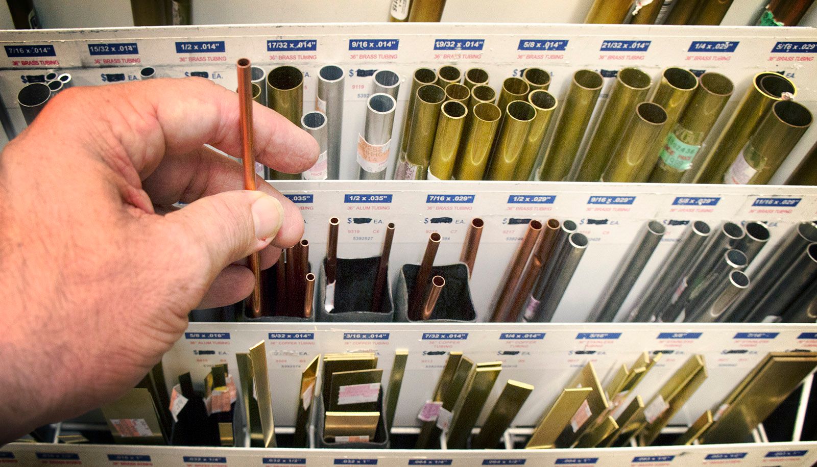

Brass and bronze are copper alloys. The other metal in brass is zinc, which
unfortunately has even higher eco-toxicity than copper (again, it's not toxic to people, just to other animals & plants). But for bronze, the other metal is tin, which has lower impacts, so it's a slightly greener metal than pure copper.

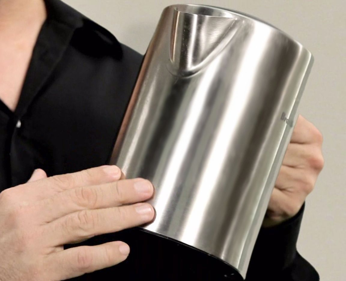

Stainless steel has higher eco-impacts than mild steel, but less than aluminum or most other metals. Although a couple of its ingredients (chromium and nickel) can be toxic to people, they're so bound up in the alloy that it's really safe, even for food. It's so safe, most high-strength medical implants are made with it. Also, it's so much harder and so much more corrosion-resistant than mild steel that it ends up being a better choice for many projects, durability-wise.
Here's a little chooser chart of preferred metals. You can also open a PDF version of the chart below.

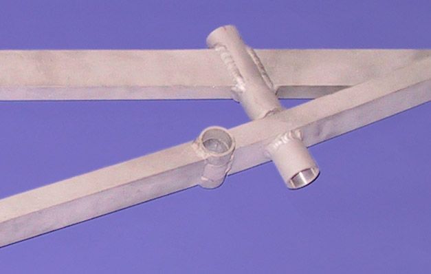

Stainless steel is every bit as strong and stiff as mild steel (often more so), plus it's also hard and super-corrosion-resistant. Since environmentally speaking it's usually better to avoid coatings like mild steel needs outdoors, stainless is a great choice for projects that'll be exposed to weather. Very low-maintenance. A simple brushed stainless finish looks great, too. And you can eat & drink out of it! The disadvantage of stainless is that because it's so wonderfully strong, stiff, and hard, it's difficult to bend and cut.

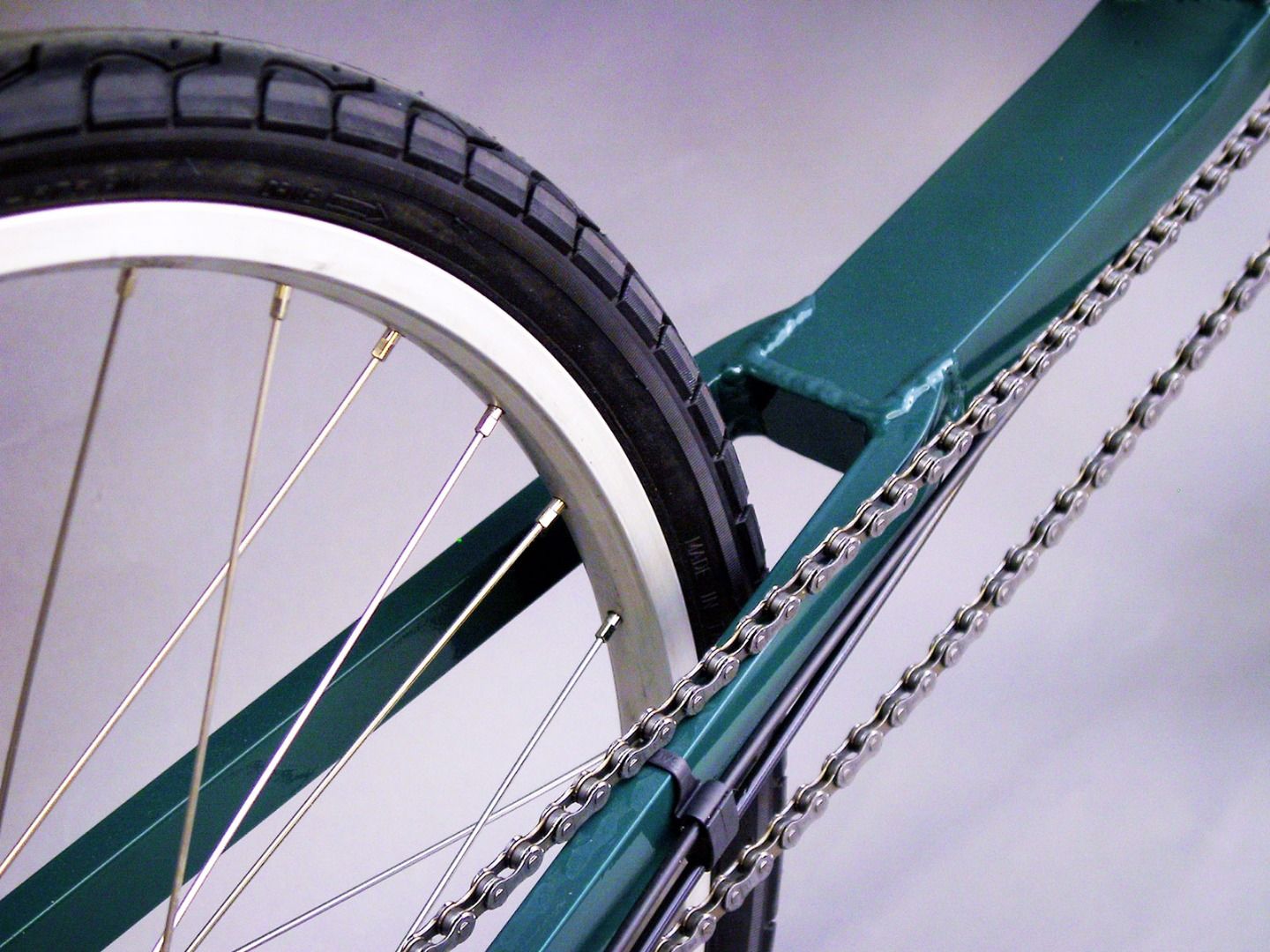

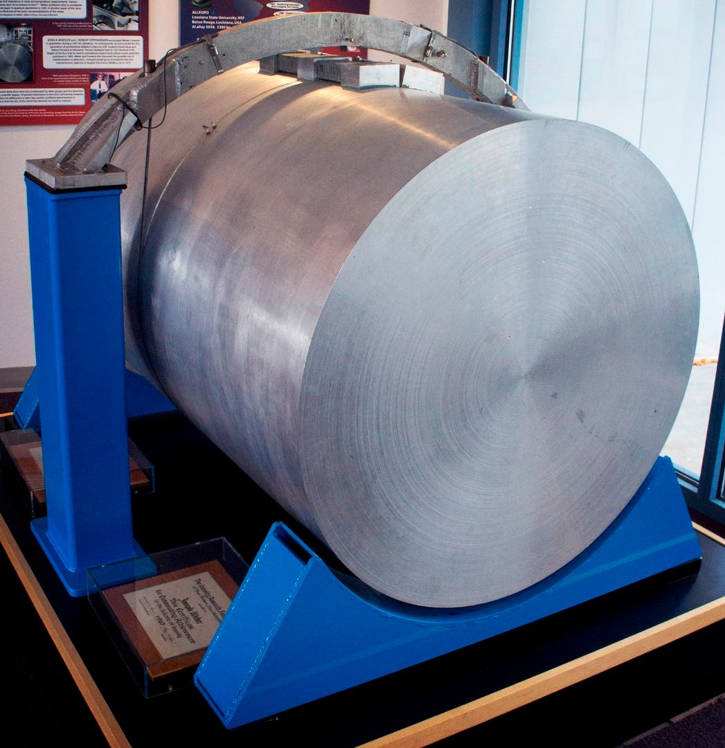

Aluminum isn't as strong or stiff as steel, but it's so much lighter (1/3 the density!) that you can make stronger structures for less weight, just by using thicker walls. And it's much easier to bend and cut than steel. It's a little harder to weld, but not that bad. So it's great for bicycles and other vehicles. The main downside for vehicles is that aluminum doesn't have a fatigue limit like steel does, but that only matters if your project is going to last a very long time or be hit with tons of vibration / impact / flexing. Aluminum doesn't rust in a structurally-bad way, but it does oxidize, so you get smudgy-looking fingerprints. You might want to anodize it to keep it looking nice. (Also, you might want to anodize aluminum you're eating or drinking out of, but the science is inconclusive about whether it really matters.)

Bronze is worth mentioning too, because even though it's not as green a metal as aluminum or steel, it can be very useful for bearing surfaces, handling more weight than plastic bushings could. Sliding aluminum on aluminum has horrible friction, and even steel on aluminum or steel on steel aren't great (useful table here), but bronze is good for both steel and aluminum to slide on. Brass is ok, too, but bronze is better.

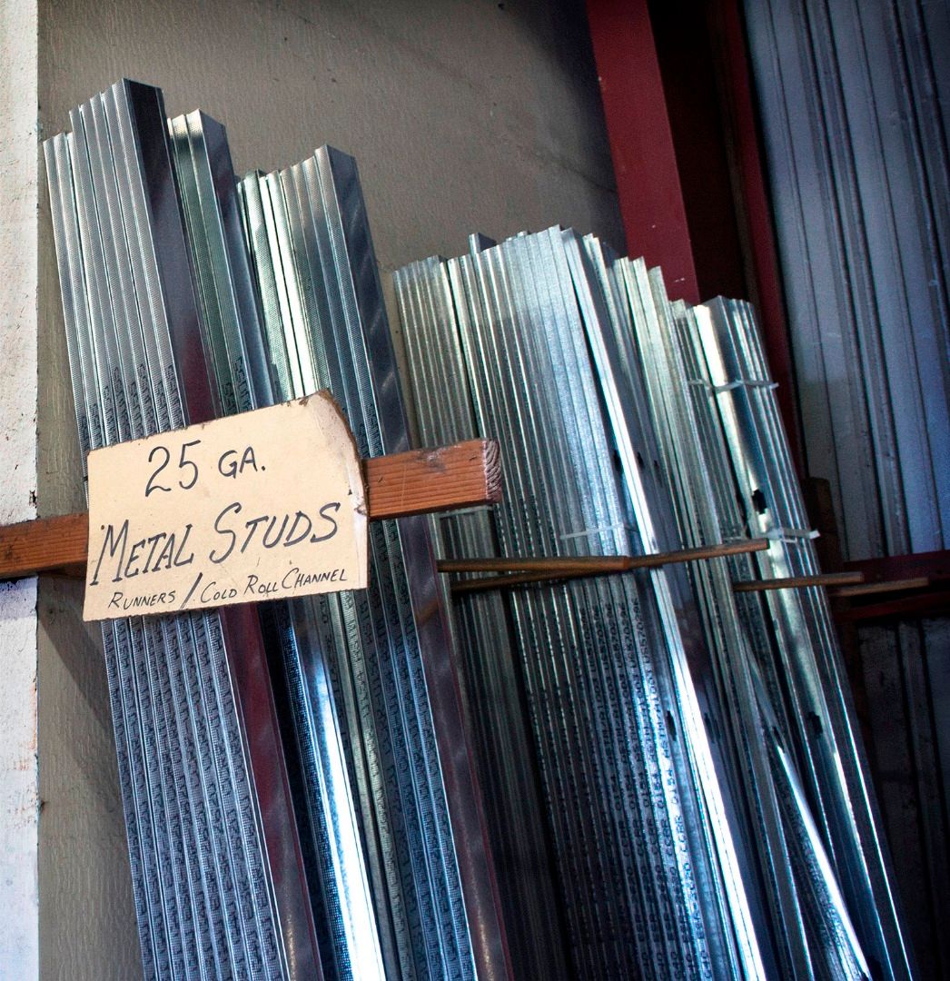

Choosing a good metal is the most important part of the process, but sometimes the coating on the metal can have big environmental impacts, too. Like galvanized steel studs in buildings.
Galvanizing is surprisingly nasty. Thin-walled sheet steel with thick galvanization (like some steel studs) can actually have their environmental impacts from galvanization be as big as the mining, refining, and shaping the steel put together. It's because galvanization is a layer of zinc, which as I mentioned before is toxic to aquatic beasties. And the process of coating the steel with the zinc also involves acids and generates toxic byproducts that companies have to deal with carefully. (Some companies galvanize with thermal spraying instead, but that just trades high chemical impacts for high energy impacts.) So avoid galvanization when you can.

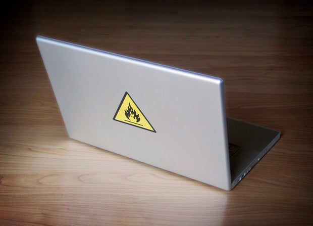

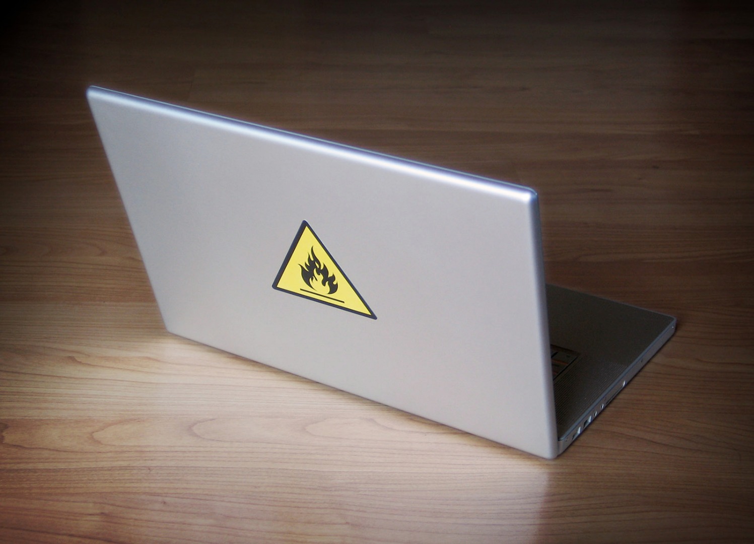

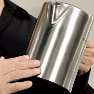

For aluminum, you can also have it clear-anodized instead. There're lots of small vendors that'll do this for you. You could even leave it bare, but bare aluminum gets smudgy when handled, and can get your hands a little smudgy too. You might think that Apple laptops have naked aluminum shells, but they're all clear-anodized.
Smudgy bare aluminum vs. clear-anodized aluminum:
(Above) Smudgy aluminum
(Below) Clear-anodized aluminum
Anodization is a microns-thin layer of oxidation on the surface of the aluminum. Usually it's chemically benign, though some colored anodization uses nasty chemicals to get certain colors (like sulfuric acid, nickel acetate, even hexavalent chromium. Even though the final coating is non-toxic to you, you should still avoid these because the people doing the anodizing would have to deal with those chemicals. Clear-coat anodization is good, as are some colors.
Anodization also doesn't hurt the recycling value of the aluminum like paint and powder coating can (according to the three recyclers I talked to). It's such a thin coating (and even that coating is mostly aluminum itself) that anodized parts can be thrown right in with bare parts in recycling furnaces, with no extra hassle or emissions-scrubbing required.

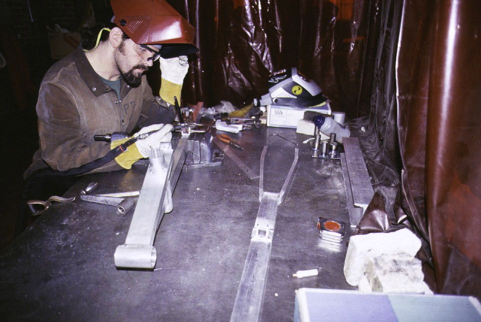

For welding, you always want to sand any paint or galvanization off the area first, out to a couple inches around where you'll be welding. Otherwise you'll vaporize the paint or zinc coating and breathe in toxic crap. You could instead have good ventilation and use a respirator, but you'll also get a much better weld if you're welding clean bare metal to metal.
For welding Aluminum, remember you should heat-treat it afterwards to get its strength back. Welding aluminum usually reduces its strength by messing up the crystal structure.
