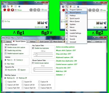

---------RECORDING USING MINI MOUSE MACRO -----------
This free Windows application is produced by Turnssoft and can be downloaded here:-
https://www.turnssoft.com/mini-mouse-macro.html
The Commander app has a facility to convert the output files produced (.mmmacro) into EngineersBuddy files (.ebm). Macros produced in this way may need editing to be fully compliant with the Commander app. Refer to the AllCommandsChrs.txt file and hand assembly instructions above to identify characters/commands which will be valid. The editing facilities that come with Mini Mouse Macro should NOT be used. Global delay should be applied using the Commander converter facility and any further editing according to the instructions above. When recording with Mini Mouse Macro ensure the following settings have been applied. In the application window (fig1), ensure the box 'Mouse' is not ticked. Then navigate to 'Record Options' using the drop down menu (fig2). Ensure that 'Disable mouse click capture' and 'Disable drag and drop' are both ticked.

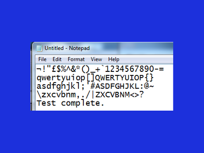

----- AllCharacters.ebm. ----- Universal, any system/OS. -----
This macro should be run with the focus on an open text editor or word processor window. It will print our the entire available character set. This is a useful tool to identify if the keyboard settings of the host computer are compliant with the Commander player's output. Although UK/US layouts are catered for, some systems such as Macs, do not faithfully reproduce the characters recorded in the macro file. Use the image above to compare with the host system output, the appropriate input characters can then be recorded or substituted in the .ebm file to produce the correct output.
