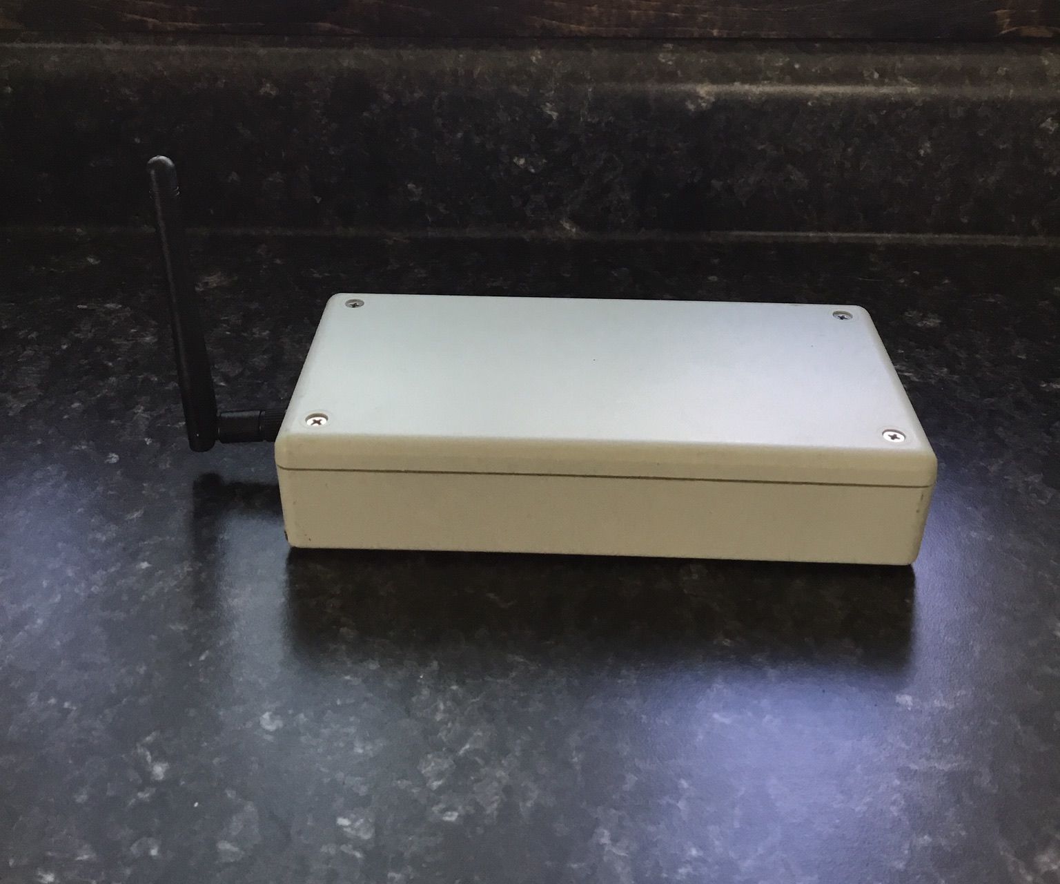

Introduction: Complete Raspberry Pi / Nova Wireless Home Monitoring and Automation System ...
The Raspberry Pi is an awesome little device ..I will show how you can have a complete stand alone wireless Security / Home Automation System on One device ..We will be installing
OpenHab http://openhab.org
Node Red modules http: node Red.org
ParticlePi program http://particle.io
Tying them all together seamlessly and adding Particles as wireless sensor inputs and controls
We will make our own PCBs and solder them up
We will make
Wireless Sensor shields
Wireless Relay shields
Screw shields (For the ParticlePi)
We will wire them up program them and showcase the final product.

Step 8: The Security Board
For the Main Control Board that sits in the Control Cabinet. I have included a gerber File for the enthusiast that doesn’t want to go through the hassle of doing a total design work up.
I have 3 relays designed into the Board.
1-can be used for an alarm Bell
1-can be used for turning on and off the solenoid
1-can be used for turning heating or Air conditioning on and off.
The Raspberry Pi Zero can be soldered into place in the spots provided to get power from the Board or you can use a header .. It utilizes a 18-24 volt AC input and has a 12 Volt and 5 volt power supply for your devices..
A particle Photon or electron can be used.. The Electron has more io points but is Cellular and can cost more in Data but is more dependable as it has a battery input for redundancy.
