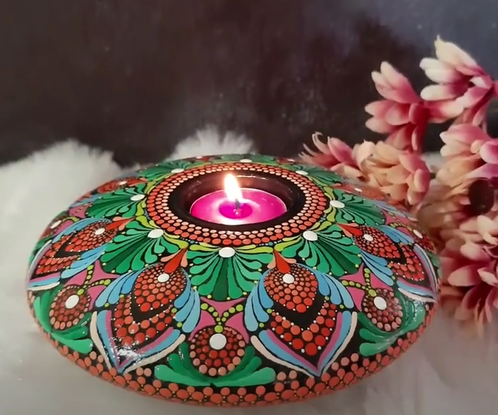

Step 3: Designing the Paper Weight/Stone
Place the centre blue dot. Then using white acrylic paint place two rows of dots
Place blue dots alternatively in the 3rd row. And top of these blue dots place a bigger blue dot
Start making petal shaped pattern using white color and outline with light blue swooshes
Now place orange color dots in the bottom of the paper weight and then make petal and swooshes similarly.
Finish off the piece with small dots in the gaps
