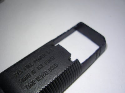

Step 2: Let's Make It Case/body
Cut the part from the bat as shown in the figure and make a square hole in the upper side of the part. Then take a small plastic piece and make a round hole on it for connecting the joystick and then glue the plastic piece to the part . Make one more of this same type .

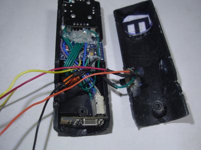

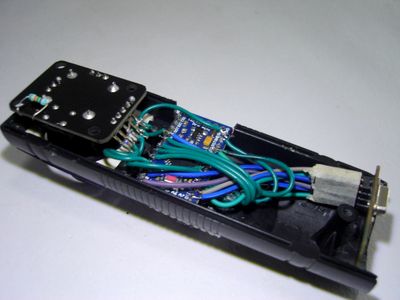

Step 4: The Electronic Parts of -
Here we are going to connect the electronic parts to the left side case of the remote.
First glue the arduino to the upper side of the case and take out a wire from it as per the circuit diagram shown in the previous step. Then connect the NRF2401 RF transceiver to the arduino. The switches that I have shown in the figure are not been used in this tutorial there fore I am not going to describe it. Then connect the Joystick module and take out the knob of the joystick through the round hole. Connect a 3 terminal switch (on-of-on) also to the same.Now we finished the electronic section of the left case of the remote. Also take out the wires for the joystick and battery which is to be connected to the right side case of the remote.

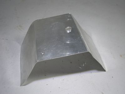

Step 7: Arduino Code, Finishing Everything and Making It Good Look:)
In this step I have used a thin aluminium sheet to cover the center part of the remote and also added some stickers to make it look better . Now it's work is complete. Here you can find the arduino program needed for the remote, the code that I have provided here is that one I used to control this robot. For the receiver code you can visit that tutorial also. Click here to visit that tutorial.
