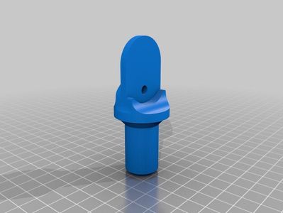

Step 9: Attach Boom and Bucket to Main Pivot
attach the bucket and boom assembly to the Base-pivot using the 11mm large male peg (no hole down the middle).
This will be a very tight fit.
